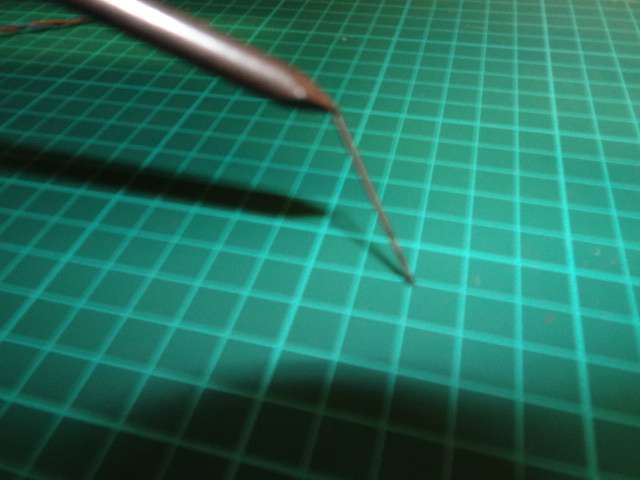

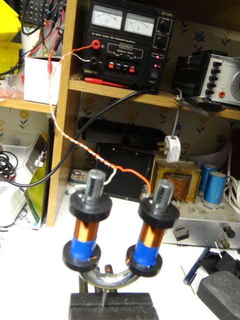

                                      Just to make an old man happy, can you repeat your test on a 6″ nail. Zap it with some magnetism, then send if it will pick up a pin.
                                      Hmmm, did the experiment.  Results not as expected.
                                      Apparatus:
                                      DSC06865
                                      Plus a 6″ Nail and, because the nail came out of the box magnetised already, a small twist drill weighing 0.19g selected from a set such that the nail can’t quite lift it off the ground.  It can lift one end.
                                      DSC06867
                                      Method: I laid the nail across the electromagnet and powered on for 30 seconds.  0.8A at 6Vdc not 8A as I mistyped in an earlier post!  I did not stroke the nail across the magnet.  I expected the nail to become more magnetised, not less.
                                      Result:  Now the nail is incapable of lifting the 0.19g twist-drill.  As far as I can tell the nail is demagnetised.
                                      Conclusion:  I don’t understand!!!
                                      What where you expecting to happen Duncan?   Can you cast light into my darkness?

                                        If the existing polarity was opposite to that generated by the electromagnet you will de-magentise.
                                        This brings back memories of repairing aircraft remote indicating tachometers. You had to re-magnetise the generator rotor to get the correct output voltage. Go too far and you had to reverse the field. Used a a capacitor discharge magnetiser. Some of the indicators (synchronous motor driving “speedo” type drag cup or disk) needed similar field adjustment to get within the hairspring adjustment range.
                                        Robert.

                                            Just that I think nails are made of soft iron, but if they were magnetic out of the box that theory doesn’t hold. Of course the drill could have been magnetised.
                                            To fully demagnetise something you normally use a decaying AC current in the coil, or move the piece away from a coil carrying non decaying AC.

                                                Ah yes.  I think modern nails (since about 1900), are made from Dead Mild-steel, less Carbon, the stuff used to press shapely car panels.
                                                I tested the drill with a relay core, and couldn’t detect any magnetism.   Even this aspect of the problem is hard, because almost everything made of Carbon Steel is slightly magnetic!
                                                If I was serious about testing magnetism, I’d have to build a demagnetiser.  Life is too short!
