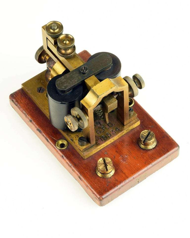

      I’ve hit the same problem with my latest endeavour, which is a Morse Sounder.  This is a classic telegraphic device,  powered by an electro-magnet, that taps out morse as a series of clicks, not beeps.  Something like this:
      Morsesounder
      It’s a simple form of electric motor, analogous to a beam steam engine used to work a pump, not rotary motion.
      The problem is designing and building the electromagnet!  The Victorian original called for best Swedish soft Iron and Silk Covered magnet wire, both of which are difficult to source today.
      In the 19th Century insulating Copper wire was a major problem, with a host of different materials in play, none of them ideal.   Paper is good until it gets wet.  Cotton OK, except bulky.   Shellac is excellent except it tends to crack, melts easily, and is hard to apply without leaving bubbles in it.  Silk is excellent, but expensive and double or triple layers are needed.  Rubber perishes, Gutta-percha, good but over consumption destroyed the source.  A good compromise for telegraphic, wireless, and other light work was shellac coated Copper protected inside a silk sheath.   As well as being a good insulator, the silk protected the wire from mechanical abrasion, which occurs every time a magnet coil is energised electrically, and also due to vibration from a running motor.
      Silk covered wire has two major disadvantages:  it’s expensive, and – worse – it separates the wires physically, when, in a magnet, they must be as close together as possible.   So a lot of effort and research was put into alternatives, essentially replacing Shellac with tougher, less brittle synthetics that could take more heat, coupled with process improvements that don’t leave bubbles in the insulation.   Took about 50 years, but new-made Silk wire disappeared after WW2.
      So, unless appearance is important, ordinary enamelled copper wire is fine.  Avoid second-hand wire because winding and unwinding it is likely to damage the insulation and to work-harden the Copper.  New wire de-risks magnet winding considerably!
      Swedish Iron, or soft-iron of any variety, has become almost unobtainium.  Main use seems to be laboratory work, so not cheap.  The modern equivalent is ‘Electrical Steel‘, which contains Silicon rather than Carbon.  It’s a speciality alloy, not available in small quantities, and ‘our’ suppliers don’t carry it.  Plenty of it in old transformers and motors, but the laminations are cut into shapes I’ve not been able to re-use.
      I’ve ordered an educational electromagnet in hope the core will be soft-Iron or Electrical Steel that I can repurpose, but I’m expecting it to be mild-steel.   Mild-steel is unsuitable for my project because it has high remanence, i.e. magnetism persists after the current is turned off, and low permeability makes it a poor choice  for motors and dynamos: inefficient!
      If anyone knows of a source of soft-Iron or electrical steel in rod form, please let me know!

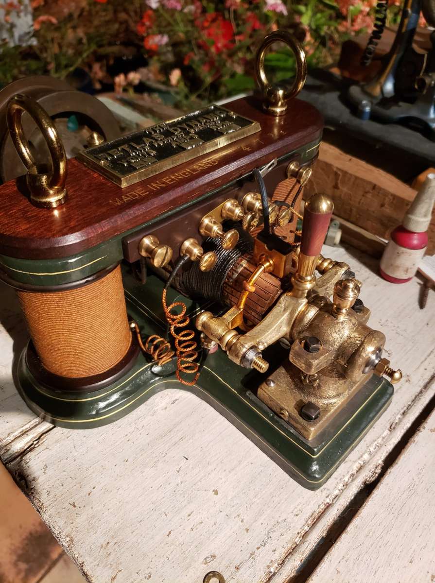

            I just used mild steel and lacquered copper wire for this one and it seems to work OK so should do for your Morse Project Dave
            You could possibly try pulling an ATV coil apart as they buzz quite well. That is what I used for this buzz coil ignition

              Excellent video of another delightful engine.  Just right with breakfast coffee – I shall enjoy ‘Lecky’ again tomorrow!  The ignition coil is a good idea too.  Wonder if my local garage has any scrap…
              I may be in fusspot mode with the sounder in that I’m trying to design it for effectiveness rather than just making a noise, and in hope of getting it to work first time rather than experimenting.  One concern is that the device shouldn’t mangle the timing of the morse signal.   Therefore the electromagnet and the return spring both have to take the same time to cause start and end clicks, and balancing the two may be tricky.  Easy enough to make a sounder that clicks merrily, but I’m not so confident about making one that doesn’t bias the signal such that it can’t be decoded by a human operator.   Difference between a model and an operational device.
              Probably ought to start a topic on it.  Much interest in the aspects of the design that are intuitively “good enough”, and those, like the number of turns of wire needed to produce a given force, that need wet-towel brain work.

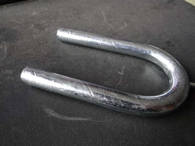

                                      Meanwhile, the educational electromagnet I ordered has arrived:
                                      DSC06864
                                      Not sure what it’s made of!  Shiny, with a helix running around it.  Next test is to power it up and see if there’s any residual magnetism left after powering down.   Mild-steel and other wrong metals will retain some magnetism.  Should be none if this is soft Iron or Electric Steel.

                                                  Hats off to China!  The yoke of their educational magnet doesn’t retain magnetsism after the current is switched off.  (8A @ 6V)  I tested it with the pole in a dismantled 5V minature relay.
                                                  I followed up Peter’s link to Neville Michie’s comments on the merits of Swedish Iron to find it is indeed special!   Turns out that a tiny difference in purity makes an enormous difference to Iron’s magnet performance.
                                                  My CRC Handbook of Chemistry and Physics (54th Edn, 1973) makes the difference clear: 99.91% Iron has a maximum permeability of 5000, whilst 99.95%  purified Iron has a maximum permeability 180,000.  Ninety times better from a 0.04% change!
                                                  What I’ve got is either Silicon Iron or Electrical Steel, which is also Silicon based.  Although similar to Bazlye’s Wrought Iron, they are considerably purer.  How well, or badly, Wrought Iron performs will depend on how it was made and where.  I’d like to try it but none in my junkbox.
                                                  For what I’m doing mild-steel would also work, but the action would be sticky and need more power.  On the other hand, I don’t need the high-performance of best soft Swedish Iron.
