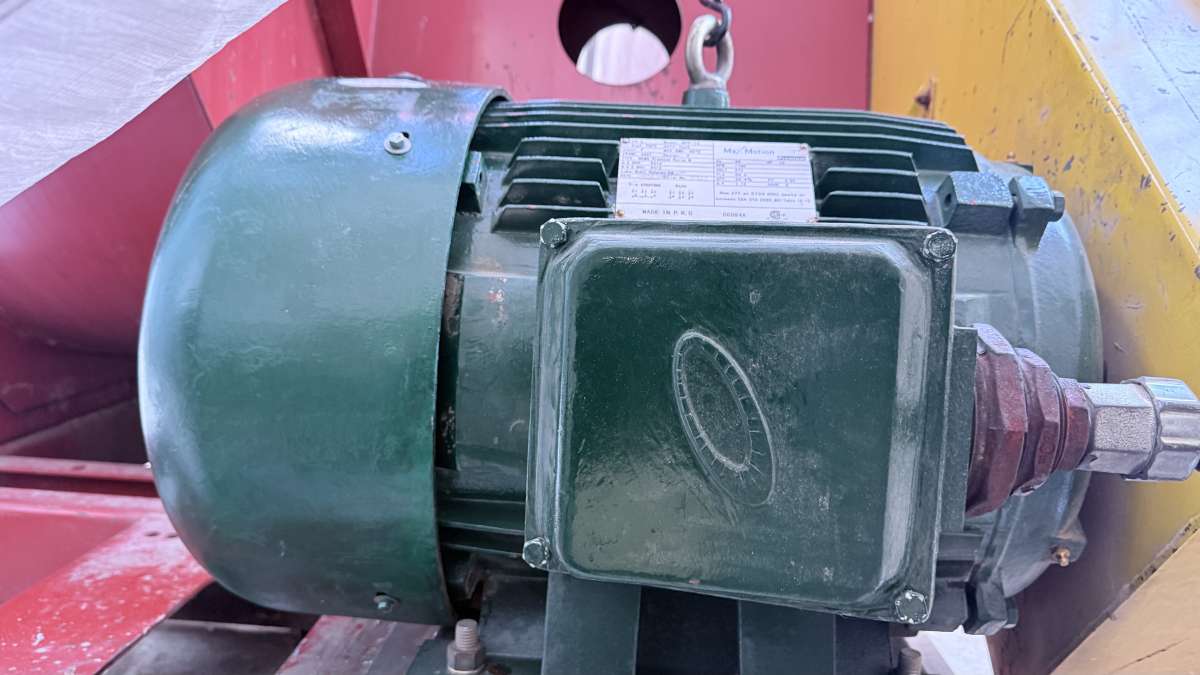

      Hi everyone. We are about to grease our electric motor, but we can’t find the grease drain plug. Instead, we have a pair of Zerk fittings on top and at the 5 o’clock position on both sides. Have you encountered this type of motor before?IMG_3601_resultIMG_3608_result

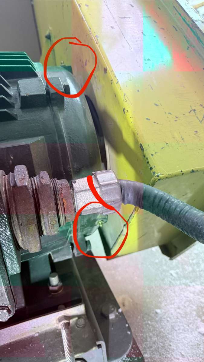

                  The lower photo quite clearly has grease nipples circled.

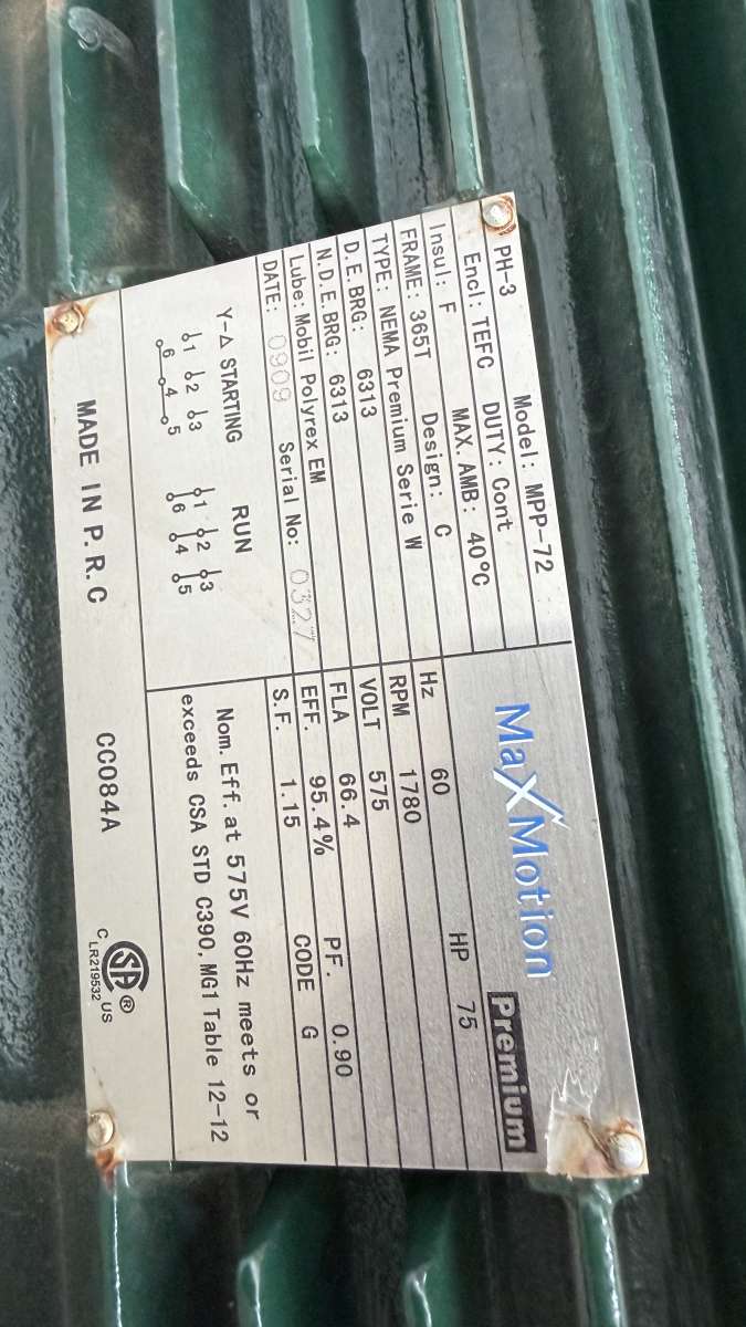

                  Unless my eyes deceive me, that is a pretty Big motor. I.e. not a simple lathe motor – more industrial? Look carefully at the spec. plate in upper pic. So greasing seems probable.

                      It’s all in the first picture. It even tells you the bearing type – 6313 Certainly not a sealed for life type see: https://www.bearingboys.co.uk/SKF-Ball-Bearings/6313-C3-SKF-Open-Ball-Bearing-65mm-x-140mm-x-33mm-97713-p
                      Instructions here:
                      https://www.mep.ca/Public/pdf/manual%20english.pdf
                      They include lubrication.

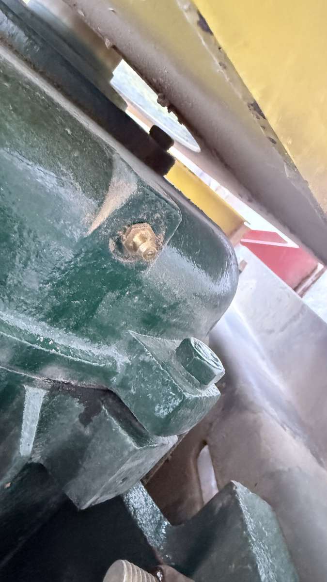

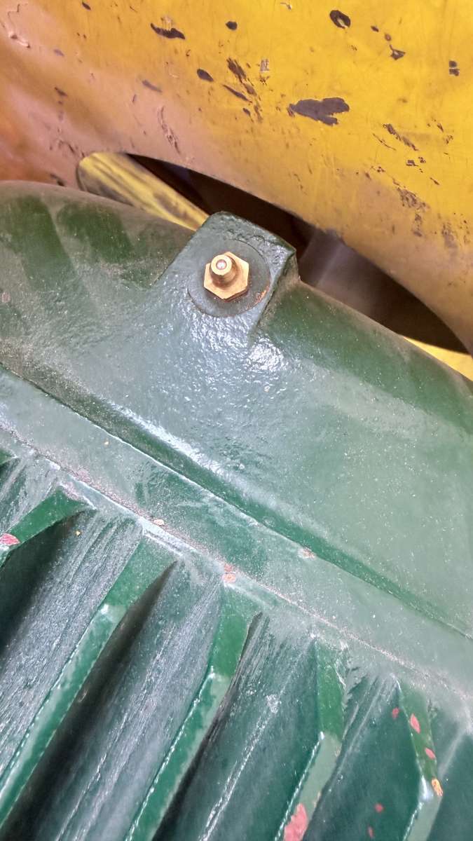

                      I’d suggest that either grease nipple / zerk fitting can be used as the input or output. Remove the one that is easiest for output. Thi is based on access for grease gun on input and cleanig any grease at the output.
                      Robert.

                        It does state on the plate to lubricate with Mobil Polyrex EM grease. Motor made in P.R.C. which I presume is the Peoples Republic of China

                          The serial plate also indicates it is most definitely nothing to do with model engineering!  75HP, which would likely draw the best part of 60kW at full load.🙂

                              The manual I linked to gives the exact amount of grease to use. If you take out one fitting as instructed there is little chance of bursting a seal.

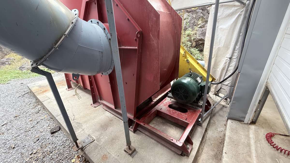

                                              It is a dust collector system for a wood factory.

                                                  Yes it is an industrial motor for dust collection system. And you are also correct with the nipples circled.

                                                      So just remove one fitting and put the grease gun on the other.
                                                      Instructions https://www.mep.ca/Public/pdf/manual%20english.pdf
                                                      When you have added grease put the fitting back in. A standard grease fitting is probably cheaper than a special plug and they only have only have to stock one part.
