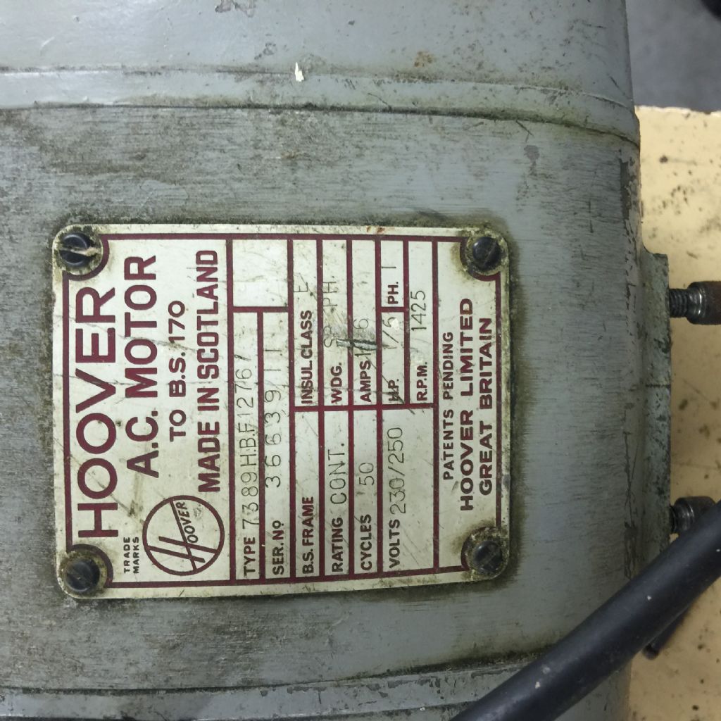

      This electric motor is fitted to my Kennedy power saw
      It only runs for a few seconds then it trips out. It can be reset by pressing the red button.
      On resetting it only runs for a few seconds
      Is it something that can be fixed, if so what do I do. I am a complete electrical novice so will need sympathetic guidance!!!

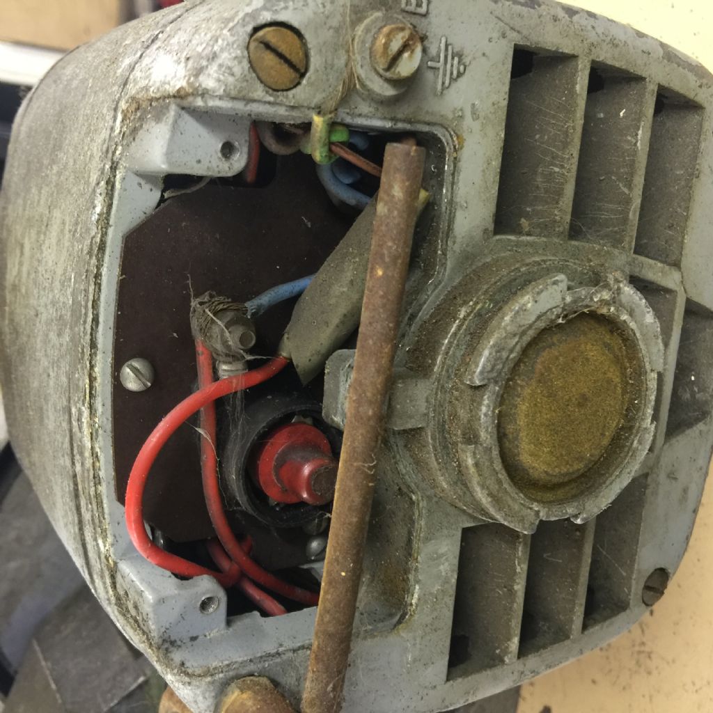

          Andy, the red button is re-setting a thermal overload, this indicates more current is being used than the motor is rated at. Could be bearings need some lube or perhaps your saw is creating additional load, at worst the windings are damaged by overload and are shorting to earth or between the winding to reduce resistance and thus increase the current drawn.
          Best to disconnect the drive and turn the saw pulley by hand to see how much load is required as the motor is pretty small.

              A possibility is that the centrifugal switch is not opening when the motor spins up. If so then the windings will overheat and trip the thermal breaker. Check the centrifugal switch is working correctly, the motor looks rather gungy and wood dust tends to get in an form a nice corrosive mixture.
              The motor is a split phase type, the name plate shows the type, "SP PH" so where is the starting capacitor, perhaps inside the motor casing?
              But my money is on a sticking centrifugal switch. Let us see how good my assumptions is!

                Split phase motors do not have a starting cap the phase shift is provided by the higher resistance of the start winding.
                Starting torque is a lot less than cap start motors so not suitable for stuff like air compressors.
                The centrifigle switch may well be stuck or the thermal switch has got weak with old age don,t poke around with a test meter unless you know what you are doing better to buy a new motor than electrocute your self.

                  Couple of things you can do.
                  Dismantle the motor, clean out the dust, muck, whatever, check the centrifugal switch is freely operating. Be sure to take notes of which wire goes where on the terminal board when you disconnect. Now reassemble and power it up but be sure you've got an earth leakage trip upstream of the supply when you test it for your own safety.
                  If it still blows the motor trip it's most likely a winding fault. If it now blows the earth trip it's also a wiring or a winding fault. In either case discard it. If you want to know more take it to a motor rewind house and ask them to test it for you. There's not much you can do with a standard multimeter, you need some more specialist test equipment (at least an insulation tester) and the expert knowledge to use it.
                  It will be cheaper to buy a new motor than have this one rewound, unless you've got a.friend down the pub who can do it for a favour. As above, it could be the trip in the motor is faulty, but you then need some specialist expertise to replace it with an external one, as you'll never find a spare trip, this motor is old as the hills.
                  If it now runs OK put the machine drive back together and pat yourself on the back.

                    May I suggest you take the motor (including supply cable still connected to the motor) to your closest Electrical Contractor for an Insulation resistance test using a 500v tester (Megger), you should be able to find one close to you in the local telephone or yellow pages directory, the test will take about 2 mins.
                    Like what others have said the thermal switch could have weakened, the CS is not opening or closing correctly, (you should hear a click when it opens and closes) the inside of the motor may be encrusted with dust after many years use in a dusty place.
                    My best guess is the windings have broken down, you could check the resistance of the windings with your multimeter set to Ohms low range which would also prove the thermal switch and CS are making good contact, remove the plug and connect your leads between the live and neutral conductors, this will give you the resistance of windings at start-up so you can calculate current demand before the CS opens.

                        Split phase motors don't have a capacitor. Take some photos of the terminal box and make a note of where each wire is located. If you have an electrician friend then get him to carryout an insulation test for you, that will determine if the motor has an earth fault. If the motor is free of earth faults, carefully dismantle the motor, noting where every connection goes. Carefully withdraw the rotor make sure you don't scratch the winding in doing so. Once the rotor is out, check the centrifugal switch mechanism which is attached to the rotor shaft, make sure they are not stuck or jammed in anyway, free to move. The actual contacts are attached to the no drive end shield, make sure the contacts are not welded together, if they are care prise them apart and clean them using fine wet and dry folded on itself. DON'T lay the motor on your bench with the weight of the motor on the windings. Clean out all the gunge using a clean paint brush and vacuum cleaner, not compressed air ,it will drive the rubbish further in. Using a multimeter on the lowest OHMS range measure the resistance of both windings. These single phase motors have two windings, the start which will have the highest resistance maybe 20 ohms or even more resistance and the run which will be around 6 ohms.On some of these cheap motors there are only three leads out, one being common to both windings. The overload is connected to the live of the main incoming leads, if its causing the problem simply remove it or bypass it, I'm pretty sure you won't be able to buy a new one and you have little to loose. Careful how you reassemble the motor, don't trap any leads, and carry out an insulation test before connecting the motor to the mains,make sure you have a good sound earth lead before connecting to the mains. Let me know if you need any more advice.John

                              The thing that none of us have put into words so far is that this is probably a shorted turn sort of a fault, rather than an earth fault. A shorted turn will give a pretty much instantaneous overheating which is consistent with the "it runs for a few seconds then the trip pops" of the OP. An earth fault wouldn't trip the trip, unless it was a gross fault in which case you might expect a fuse to blow somewhere sooner or later. The possibility of a gross earth fault is why I'm dead against (no pun intended!) running this without being absolutely sure the earth is 100% reliable.
                              Does anyone have a view on whether the trip is sensing over temperature or over current – or possibly both?
                              Having the starter winding left energised won't (I think) trip the trip as quickly as is described – the excess current is pretty marginal, and while there is a heating effect it is going to take a little while before the trip heats up enough to pop.
                              The motor rating plate says it is only 1/6 HP, so it's a pretty small motor and is probably susceptible to having been overloaded for much of its life. (What sort of saw is this?). Chronic overheating, humidity and what we'll politely call "foreign matter" for a long time will take their toll on the insulation of the windings.
                              Detecting a shorted turn with a multimeter isn't something I can explain to the OP – and probably isn't do-able anyway. Hence I think the best advice we can give is to strip and clean it, try it for size, then throw it away if no success.
