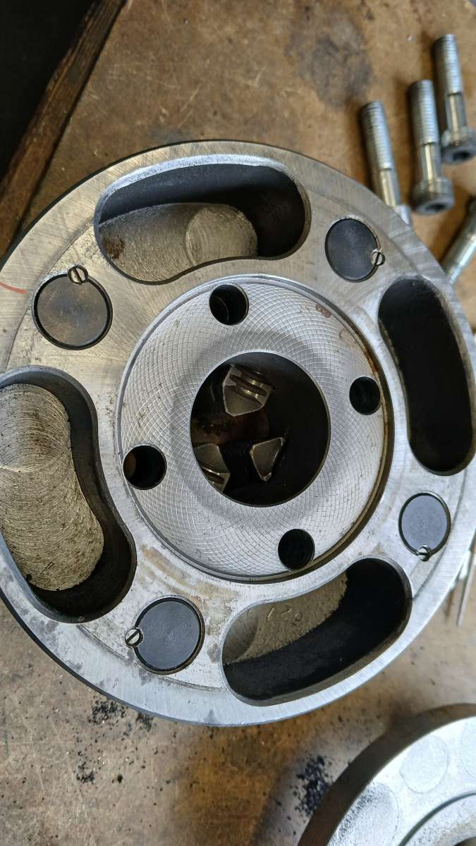

                I got curious. As my lathe is not fixed to the wooden floor I did not have to unbolt it. The 125mm 5C which was a Customer reject picked up for about £20 was already mounted so I gave that a go. Then I put the larger 160mm 4-jaw chuck on and took that for a spin.
                Quite happy with the results and can see why the 20yr old Green Dragon keeps knocking out working engines😉😉😉
                The guy in the video does mention cheaper chucks. I suppose as most 4-jaws of that size and larger tend to have hollow pockets in the back that the very cheap ones may leave these pockets “as cast” which could result in a balance issue. As you can see my 2nd hand Bison has these pockets machined.
                      20260514_090730
                      I understood these are ‘lightweight’ chucks for smaller lathes with less starting torque. They can’t be materially cheaper enough to warrant the extra machining and labour costs, can they?

                            I have a Burnerd 8″ lightweight 4-jaw that is very unbalanced. You can see the variable thickness of the cast iron webs on the rear where the pockets are cast. I have a pair of these and the other one is just fine. I keep one witht he jaws set inside and the un-balanced one with the jaws set outside because it’s quicker to swap out the camlock chuck than reverse the jaws (copyright J Stevenson).
                            The out of balance one will shake my lathe (Monarch 10EE) if I wind the speed up past about 500rpm.

                              With an out of balance chuck with cast lightening holes, it might benifit from careful removal of metal from the heavy  cavities. Our 6″ lightweight Toolmex four jaw independent is made form a solid piece of SG iron and fully machined so is perfectly balanced when holding round, square or rectangular material on their axes.
