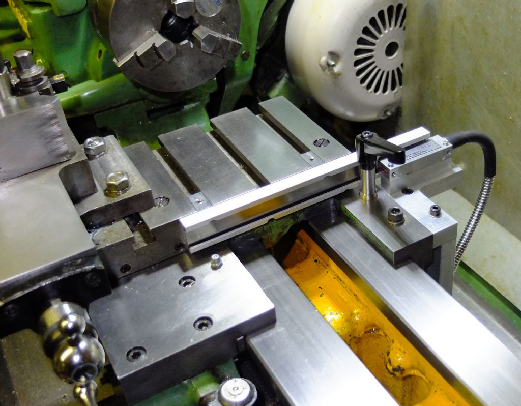

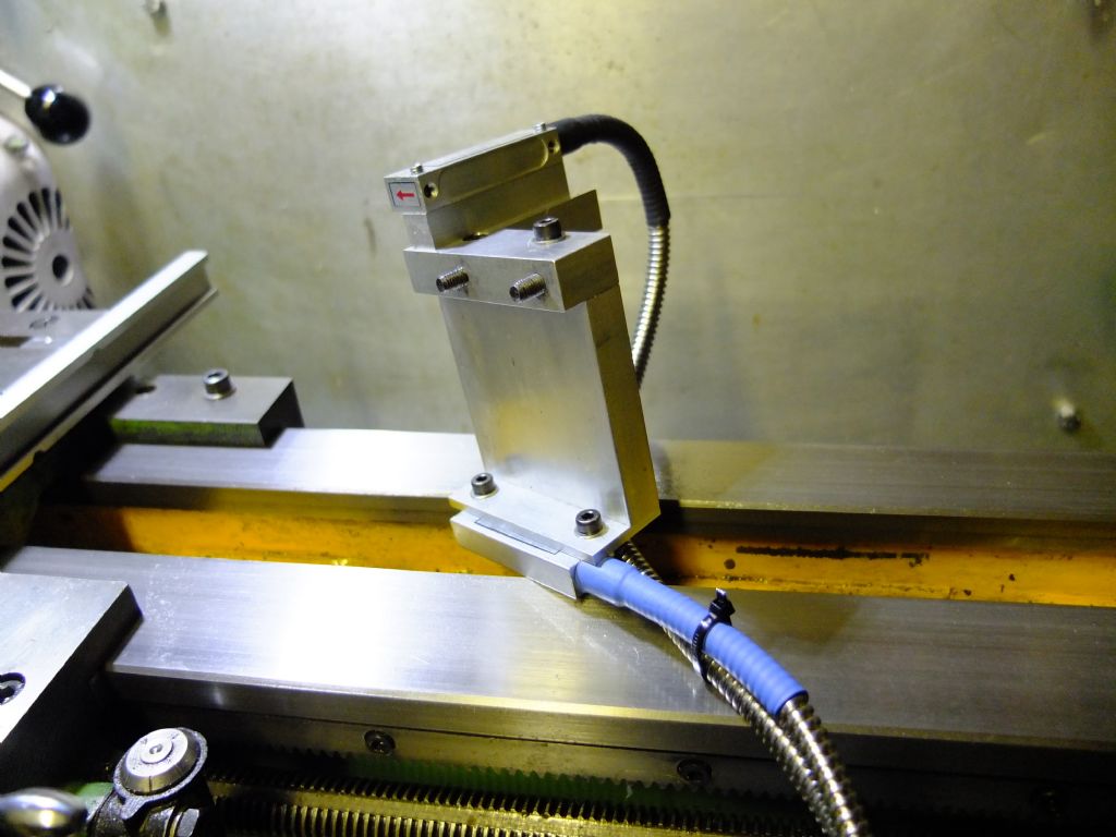

                  I have just completed fitting a two axis magnetic DRO to my Super 7B, it is a subject that has been covered before but I haven't seen it done like this, which of course doesn't mean it hasn't. Anyone contemplating fitting a scale to their lathe may get some ideas from it.
                  The y axis is straight forward, the scale was fixed to an aluminium flat bar that picks up the taper attachment tapped holes. The cross-slide is more difficult, I did not want to cover the gib adjusters, cross-slide locking screw or loose the carriage lock.
                  The scale is an EH-05 from Machine DRO, the extrusion that carries the scale has a slot down one edge that can be used for tapped strip. I did not need it so I milled it off to end up with a profile that is 20mm wide. Two counterbored holes allow the carrier to be fixed to a pair of close fitting tee nuts that lock into the cross slide tee slots with grub screws.
                  I am happy with it so far, the sensor does cover the cross slide locking screw in some positions but it has not been a problem, it could be avoided by mounting the sensor further outboard. I like the fact that the only modification to the lathe are the two tapped holes at the back of the carriage.
