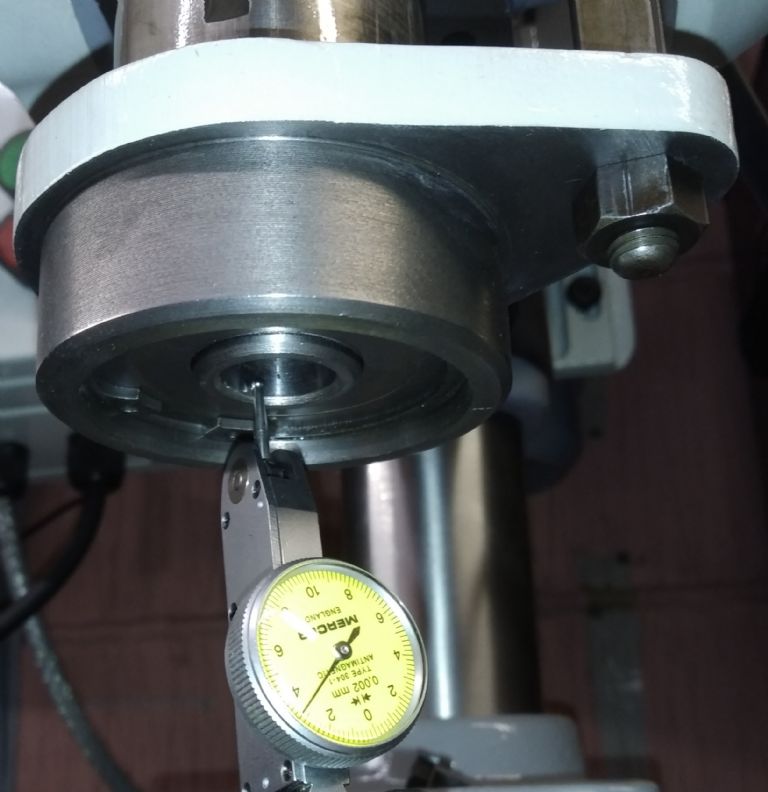

                  What's "at the morse taper" ? the outside is irrelevant, it's inside the taper that matters, I just checked my drill, rotating the spindle by hand shows no more than 0.002mm flicker on the dti.
                  What's a precision rod? I have a feeling you're using silver steel, but the quality of this can vary between suppliers, Rennie supplies good quality silver steel, other budget material I've purchased from reputable suppliers is a noticeable drop in ground finish, I wouldn't recommend this for checking accuracy.
                  A good quality carbide end mill might be a better bet .
                  Where you need to place the dti to check runout 👇

                    I don’t own a dial test indicator to check the inside of the spindle
                    I knocked the chuck head off the arbour and used the dial indicator to check the run out.
                    A precision rod is what it’s labelled by oozenet who are CNC sellers. I paid about £5.
                    Do i have to invest in a bit more expensive chuck ? The current chuck came with the machine
                    Andrew.

                      What machine is it?
                      When checking these things you need to assume every part you add to the mix could potentially be the problem, or part of it.
                      Which is why you check the spindle bore first.
                      If you measured the arbor without the chuck at 0.03mm then the chuck is probably the cause of most of the problem, I'd just use it as is until you know where the problem is?
                      No point even worrying about it unless you have the means to test it.

                                    I have a dial indicator but not the test indicator. I think if i angle the dial indicator upwards inside the spindle , i will be able to measure the run out rather at the MT (chuck end). Will try to do this weekend and post the results .
