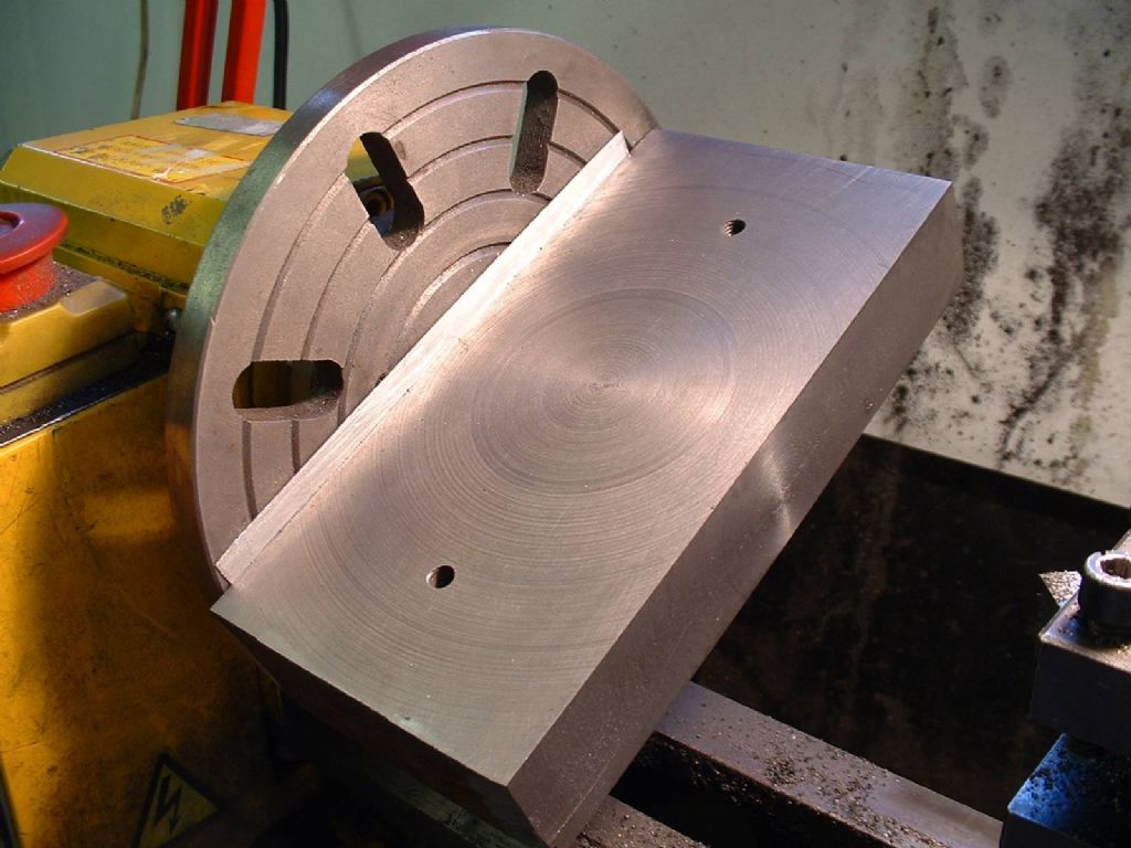

                  This is especially for Geoff!
                  The ally strip was carefully scraped to ensure the machined face was truly square to the sides.
                  But really, please don't do it like this…

                    Oh it's an ali strip, I thought that was a piece of double sided tape holding it to the faceplatesurprise

                      Looks fine to me as long as you keep it below 2,500 revs.

                        Neil,
                        A better method would have been to bolt 2 bits of angle top & bottom to your faceplate as clamps with the block sandwiched between they could also have been drilled for a couple of tightening screws. You could also have "balanced" it a bit better ( there is more sticking out on the LH side than on the RH side) of your pic. Then 2500rpm & 0.100 thou depth of cut & bob`s your uncle job done!
                        Alan
                        #179930
                          Alan,
                          This was about 12 years ago, I've learned a bit since then!

                              Neil,
                              Now that caught my attention and made me sit up!
                              Surprising what you can achieve with ignorance at times.
                              Alan's suggestion would have been mine as well.
                              I think I would have tried the 3-jaw, slow speed so as not to shake everything to bits, just to see what happened devil

                                  I used two brackets in a setup similar to Alan's description when I parted off the corner of a 4" cube of aluminium. I extended the parting blade in stages and had to resort to a hacksaw when I got to about 1" diameter. The 'faceplate' is actually an aluminium disk bolted to a Boxford drive plate. I do have an original Boxford faceplate but I have only used it once as the slots never seem to be in the right place. I can drill and tap this aluminium one to suit the job in hand and it will be a long time before it runs out of places to drill.

                                    I could argue that from an engineering viewpoint the solution that works and uses the fewest resources is the best one,
                                    Seriously I know that was not a good setup, hence why I didn't dig out that photo for the article, Happy to post it here as a BAD example.
                                    These days I'd stick a drill vice onto the faceplate with double-sided tape and hold the block in that.

                                            Well this is the 'missing' picture. I'm not sure two M6 cap-heads were really sufficient to hold the block like that surprise
                                            So please don't copy…

                                              I use M6 screws for fixing Neil – hi tensile of course but all thread too at times. All I would add to that set up is do make sure the work is balanced, which it's likely to be in this case, and also ensure that the screws are resting up against the T slots in the right way to make sure they are in shear as far as the cutting forces are concerned.
                                              Machine like this wont take very heavy cuts at this sort of effective radius so some care will be needed in that respect.
                                              I would be inclined to also use all thread too through the spindle. Ideally bushed at each end to keep it very close on centre. It's not so useful clamped up at an angle. I found this a useful add on for a Taig/Peatol in it's own right but in this case it will help make sure that the work doesn't slip and whack the bed and etc.
                                              As I'd guess you might know in cast iron bsw would probably make a better fixing. Almost certainly so when al is being held like this.
