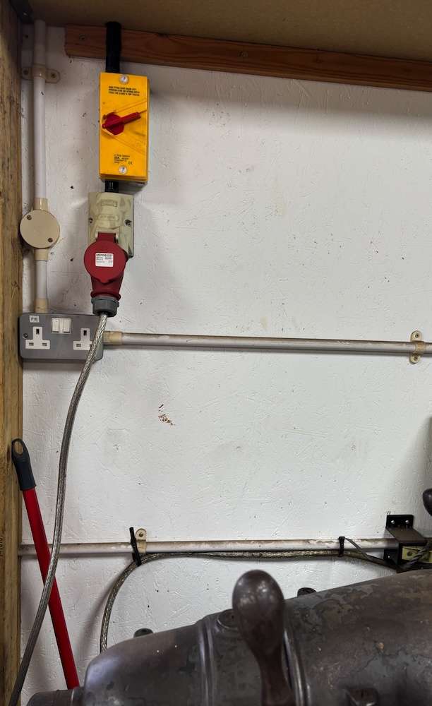

                Indeed the Eaton Power XL DE series VFD’s were essentially lobotomised versions of a normal VFD. Sold as variable speed starters being pretty much drop in replacements for DOL boxes to add speed control. I liked them because once installed they are essentially proof against ill informed fingerpoken. All the usual settings were there but you needed a, quite expensive, plug in widget to change things. Unfortunately recently discontinued.
                Having removed the DOL box I’d advise putting a lever operated disconnector in the input power line to the VFD. Put it somewhere where it can easily be got at and choose one whose on-off state is clearly visible. When I set my workshop up I found some compact affordable ones from Lewden, may well be discontinued by now tho’, with a yellow top cover behind a nice red handle whose position can clearly be seen from right across the workshop. Hopefully something similar can still be found. Unfortunately all plastic so vulnerable if hit, can’t have everything I suppose. No worry for me ‘cos Clives rule is such things go on the wall about 4 ft off the floor so accidental thumping is hard. I loathe the round knob disconnectors because the stars cannot be clearly seen until you get up close’n personal.

                    Further to my comments on high visibility lever isolators.
                    Looks like the Lewden ISO- ones I have can still be found on-line eg Power Discount list the 20 amp version  https://www.powerdiscount.co.uk/lewden-iso-20-isolator-20a-4-pole-ip56-59886-p.asp.
                    Come in -20,-30 and -63 variants denoting current capacity.
                    UK Electrical Supplies also have what appears to be an identical device in the Selectic Seal range eg SS20A-RSY. The URL is way too long to post!
                    Both around £20 a pop.
                    This is my set up behind my big P&W lathe. Perhaps a bit more of a stretch to reach than ideal but its safe and power on/off status is obvious.
                    Lewden ISO Isolator
