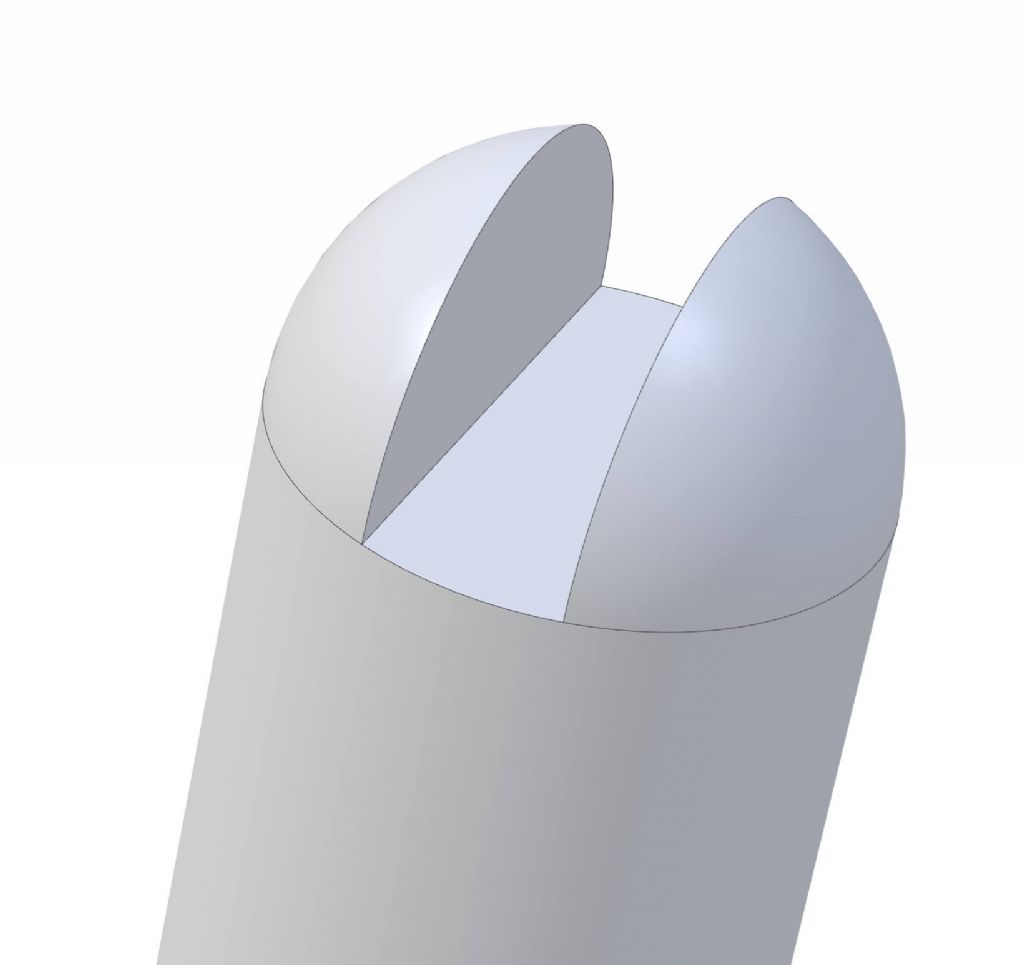

      I've come across a water service valve buried in house wall. It's an isolation for exterior tap, and the only access (without pulling wall apart) is down a small hole perhaps 10mm diameter.
      Rather than the standard screwdriver slot to twist the ball, this valve has a raised bar across a rounded dimple.
      I speculate that the key/tool to operate it would look like
      I've searched on-line for similar valves, or the tool to operate, but have failed to find anything. Does anyone here know a name for valves of this type? or where I can get a key?
      I can make a key, but will be largely guesswork as measuring down the access hole is not easy.

        Unusual water service valve (and its key).

          Sounds like it might be a 1/4 turn plug cock. Age will determine whether anything is available commercially but I would suggest that it's not recent. When I was working I came across them occasionally as the drain valve for a hot water cylinder and not really suited for high pressure applications, i.e mains water.
          Martin

            Thanks – I'm pretty sure it is a 1/4 turn ball valve, similar to the ones that have a screwdriver slot. I can just make out compression fitting at one side of the valve when peering down the hole in the wall.
            I was hoping to find either a key, or details of the valve that I could measure/estimate sizes from to make my own key.

              That sounds more like the sort of coupling you would find on a motorised valve. I wonder if somone repurposed the valve part of a motorised assembly?

                        Please can we keep this on topic? I'm aware of the risks of seized valves (I judge it unlikely – I could be wrong, risk is on my own head. This is NOT a stop cock – it's a service valve (1/4 turn ball valve)). I do know where the stop cock is, and that isn't seized.
                        All I'm looking for is if anyone knows a name/term that might help to find a similar valve or the matching key via a search engine (as everything I tried had failed).
                        I'll probably end up choosing a few different diameter rods from my scrap box, round one end in the lathe, cut a slot with hacksaw then go to site and file to adjust.

                          Although I have never seen one quite like you describe … I suspect you have a ‘tamper-proof’ valve which has been usefully re-purposed.
                          Conceptually similar to the one discussed here: **LINK**
                          https://terrylove.com/forums/index.php?threads/tamper-proof-angle-stops-argh.36826/
                          … but obviously differing in detail.
                          Think of all those annoying screws on modern electrical appliances, or of all the variations on car wheel-nut design.
                          I think ‘reverse engineering’ a key for what you have is probably the best bet.
