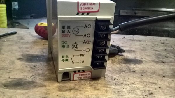

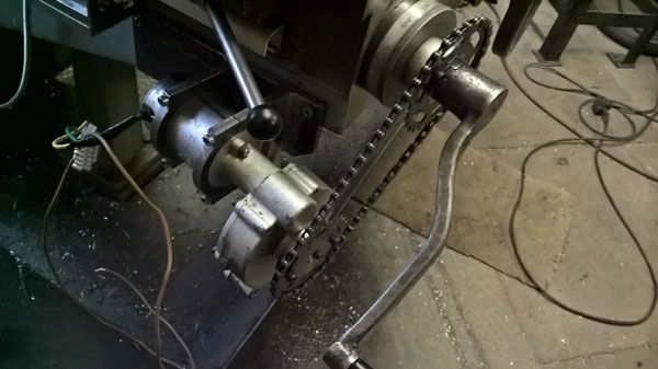

      I've had ideas to add a power feed to the z axis of my mill. I have a 12v dc motor off a golf trolley cart and rigged that up with a car battery to see if it would work and have the power to lift the apron and at what speed. All worked ok so I've made mounts for the motor and am ready to hook it up to permanent power.

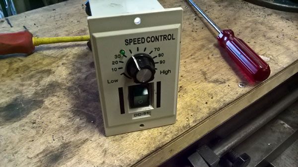

      I temporarily wired it up this morning to the motor mounted on the mill but without the drive chain. The motor ran for a split 2nd then the RCD tripped.
      I then took the motor off the machine and put it on the floor on a bit of carpet. It didn't trip the RCD this time, the motor ran for a moment then nothing happened. Obviously this isn't going to work, but I'd like to know why if anyone could let me know.
      The unit is rated for 400w, the motor is 150w. Just done some calculations and the motor (I think) will be drawing 12.5A
      As this unit is spec'd at 0 to 2.2 amps presumably that's why it's not working.
      Ok, any ideas for running this motor, looks like I can forget about speed control.
      Thanks, Phil,

          It may need to be started at the low setting to restrict starting current. 12.5A is correct if the motor is outputting 150W but this should not be the case if the motor is unloaded.
          Martin C
          The current draw from the mains for 400W should be 400/220=1.81A plus a bit more for the electronics in the box so 2.2A rating is probably reasonable. 2.2 x 220 = 484W.
          Martin C

            Thanks Martin. I had the dial set to the lowest, can you explain the initial split second of rotation and why it tripped the RCD when on the machine. I did wire it up to an old 12v lawn mower motor I've inherited, it again didn't start but made noises as if it was trying!
            Philip.

                Given the size of the unit my guess is that it can't incorporate an isolating transformer, in which case the DC output is not isolated from the mains. Your motor, if designed for low voltage DC, may have its negative pole connected to the frame. When mounted on the mill, and presumably earthed, you then created a wonderful earth fault that tripped the breaker. It may also have blown a diode or triac in the controller. Can you post a link to the controller on eBay?

                  The most suitable power supply for that motor would be the same as it used when it was on the golf cart. The motor armature will be quite low resistance and the start up current very high. Low voltage heavy current PSUs are available but one to drive that motor would be quite expensive. Controlling the speed is best done by PWM but finding one (unless off a golf cart or mobility trolley) might also be expensive.

                      It's the wrong sort of power supply for your motor. Can't see it in the ebay description but the maximum current available at any voltage from these is 2A. While it will do 400W at 200V, only 24W available at 12V. Not enough amps to run a golf cart motor.
                      Quick look on ebay failed to find an obvious alternative. Fixed voltage LED psu's galore, but speed control would have to be tackled. Plenty of lab style 10A/30V PSUs available, but they're pricey. Anyone know of a moderately priced 0-12Vdc variable PSU good for 10 – 20A?
                      #438932
                      John Haine
                        @johnhaine32865
                        The second unit you linked to will supply 10A at 12V so should do the job, but it's designed as a lab supply so is overspecified and pricey. You would control the speed by controlling the voltage – I assume that your motor is a permanent magnet type for which the speed is basically proportional to the voltage. PWM wouldn't do much for you if using that. On the other hand you could get one of these which is much cheaper, gives 20A, and pair it with a simple PWM speed controller like this.

                            There isn’t continuity between the leads and the frame so to my logic the frame isn’t part of the circuit (please correct me if this is the wrong assumption). There is continuity between the leads which I wasn’t expecting, I need to gen up on how a dc motor actually works. The motor is magnetic.
                            I think designing a pwm circuit is probably beyond me but thanks for the idea.
                            I’m going to follow your advice John, I’ll be able to mount the power supply out of the way and have the potentiometer and a 3 way switch in the operating zone.
