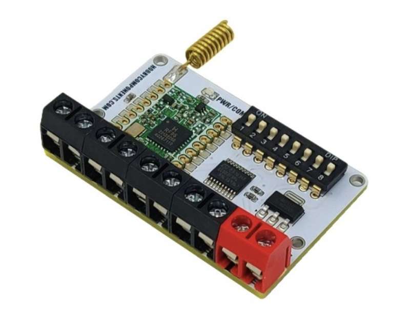

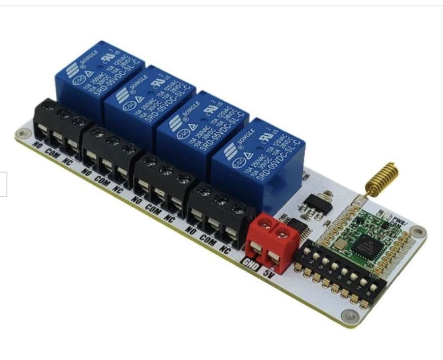

        Depending on the distance between tank and pump, a LORA (long reach radio) system might be a good solution.
        I have tried some of these low cost modules and they seem to work well. I bought mine from Hobby Components, link below:
        https://hobbycomponents.com/lora/1190-longreach-lora-4-channel-digital-tx
        and
        https://hobbycomponents.com/lora/1191-longreach-lora-4-channel-relay
        The first one is a 4 channel transmitter and the second is a receiver with 4 relays. There is a DIP switch on each to set matching addresses for the modules.
        Stuart

            As Jason says you would need a battery at the tank end. Probably a battery and solar panel setup.
            The transmitter only takes 9mA at idle and 120mA when transmitting, so a reasonable sized battery would last a long time even without a solar panel to keep it topped up.

                  To others, I have 240V power available at the tank, so no problem powering a float switch and electronics.
                  Duncan, these devices from Hobby Components have really got me interested. I have been trying to understand how a motor contactor works and the 3-phase circuitry involved, through Internet searches. Thinking the potential circuit through, I presume that the Lora wireless connection would have to be maintained for as long as the pump needs to run (to fill the tank, in other words). If the wireless connection falters, then the relay(s) would drop out and reconnect again once the wireless signal is reapplied. Could some sort of latch relay be employed if this is an issue? The Longreach Lora 4-channel-relay board appears to have 10A 250VAC relays, so I presume could be wired directly into a circuit involving the 3-phase motor contactor (from what I have found and understand, only one phase provides the power to the contactor’s electromagnet, or an independent single-phase source is used). I will have to determine if the 250V components are approved under Australian standards. If not, could another set of approved 250V relays be used operated by low voltage through the relays on the Longreach board? Ultimately, these questions are for my electrician, if only I can find a decent one!  – willing to put some thought into a solution, that is.
                  The Longreach electronics will need to be protected from the weather and possibly external, weather-proof antenna used. The receiver end will be inside a metal-clad enclosure, built to protect the electrical sub-board and pump control gear.

                          <p style=”text-align: left;”>Phillip, I think what you would need is similar to a switch de-bouncer. This notices when the switch output changes state, but then repeatedly checks that it hasn’t changed back for a set time before it acts. This gets away from problems of short-term spurious signals of loss of signal. Whether you can buy such a device ready made I don’t know. In your case of tank  filling I don’t suppose it would matter if the pump ran on for quite a few seconds, just set the switch level a bit lower</p>
