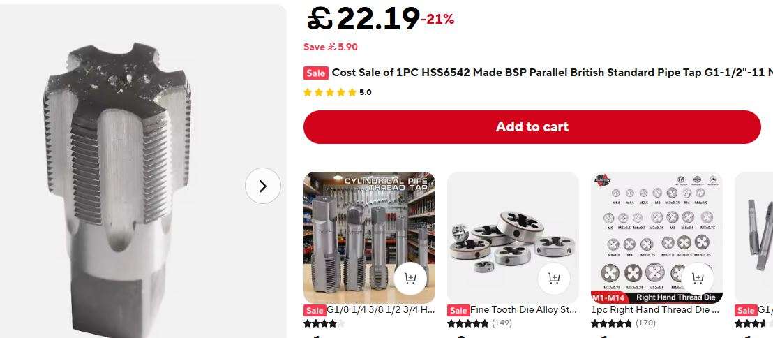

      I have a need for a single use tap to cut a 1-1/2 inch BSP thread in brass. The brass tube is embedded in the wall of a concrete tank and the thread only goes half way and I need it to go all the way through.
      Do you think that non heat-treated steel will be sufficient for this one-off job? There is about 50mm of thread left to cut.
      Any and all opinions and ideas appreciated.
      Thank you.

              Why bother making one when you can buy a HSS tap for £22.00 which is about 1/4 the price of a suitable length of silver steel to make one from. Postage would be about the same for both

                              #837625
                                Traceys will be £54 by the time VAT is added, as I said they can be found in the 20s for HSS  not the Carbon of Traceys
                                cheap tap
