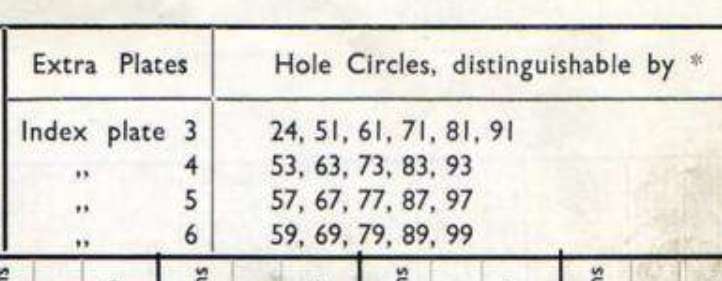

                Julie Ann
                  @julieann
                  On Bazyle Said:
                  ….I don’t think 63 is available….
                  Neither 63 nor 69 is available which annoyingly happened to be the tooth counts for the second shaft gears on my traction engines. Although I have a universal dividing head the easiest solution was to make my own dividing plate:

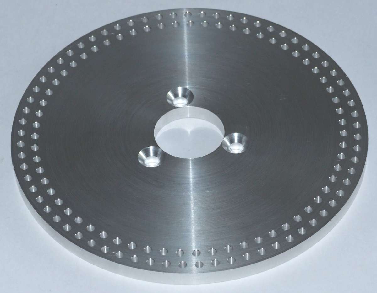

                          Some dividing heads have a direct indexing feature with eg 24 holes in the chuck backplate. Victoria did 4 extra plates if you didn’t want to go to differential indexing and included them in their tables.
                          Screenshot 2026-05-01 001249
                          If you have a 3D printer then on thingiverse there is an openscad utility that creates any count(s) complete with mounting holes etc to fit your dividing head.  https://www.thingiverse.com/thing:1908993
                          I showed an sample I did for 73 holes about 5 years ago.

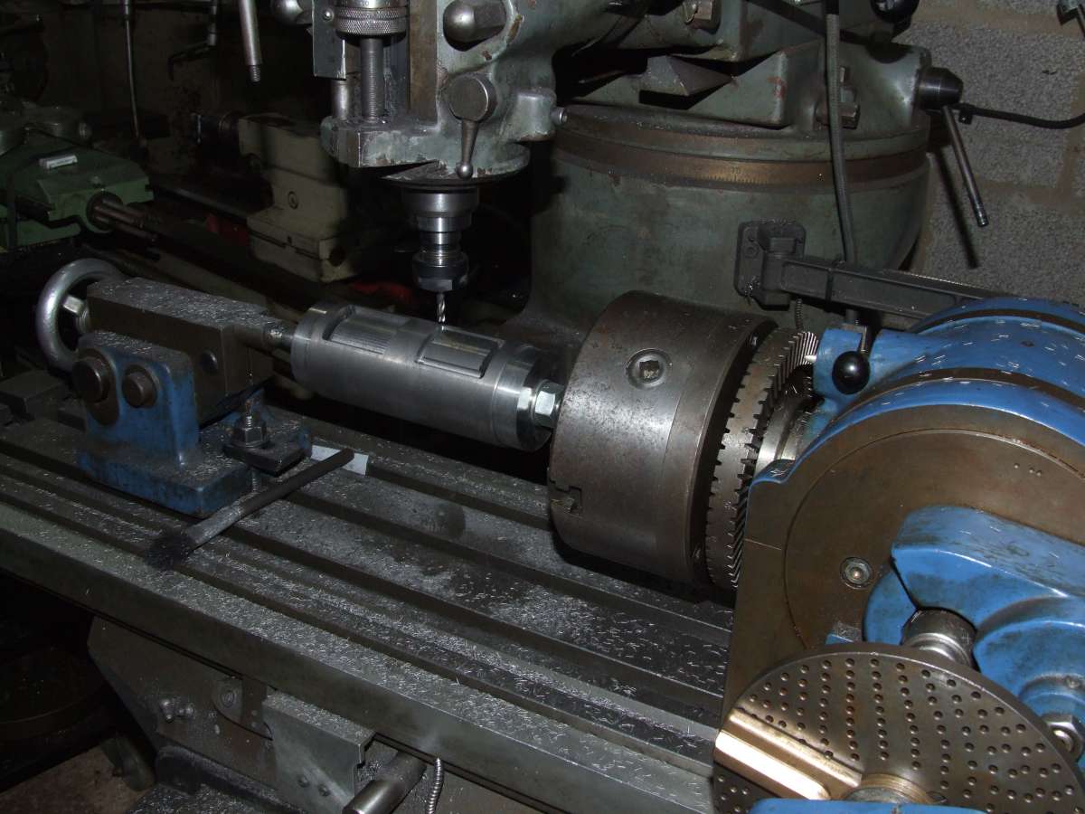

                                On Bazyle Said:
                                …Some dividing heads have a direct indexing feature with eg 24 holes in the chuck backplate…
                                My Elliott dividing head has a rather useful double sided plate behind the chuck for direct indexing; 60 slots on one side and 56 slots on the other side. Can be seen here, centre  and slightly to the right:
