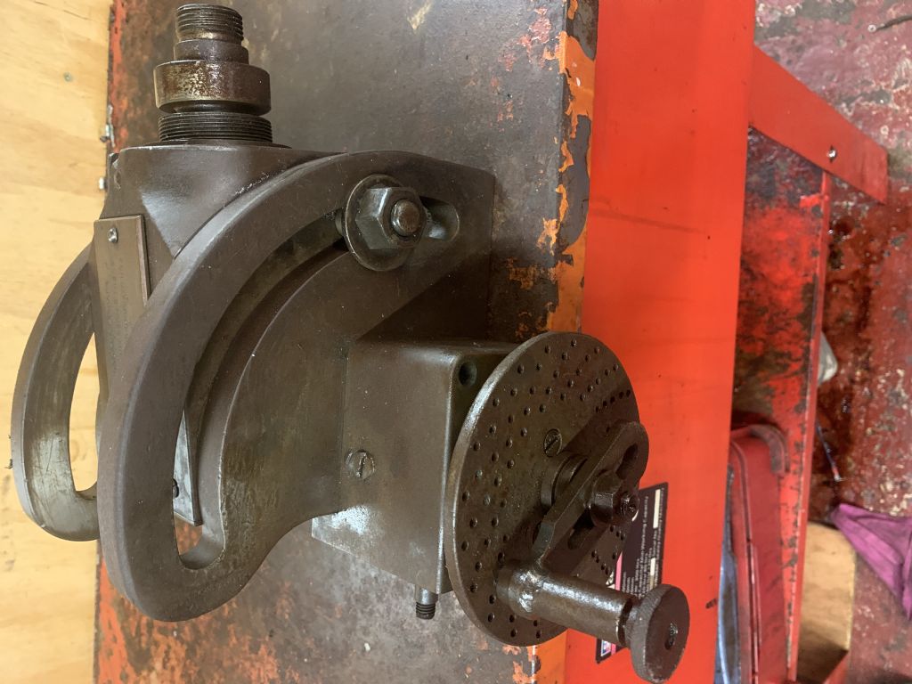

      Hi – recently been given a tilting dividing head – can't find a makers mark on it yet but it looks very well made.
      It looks like it was taken apart for some reason and the main drive bevel gear is missing along with the handle – the surround doesn't look like too much work to make a new one but the bevel gear is my sticking point.
      How do I work out what gear ratio it needs to be – ive not counted the teeth on the gear that remains yet but that's my next job.

                          Its defiantly a bevel gear drive that's missing – I can work that out from where the original handle would have been – I will attach a photo later.

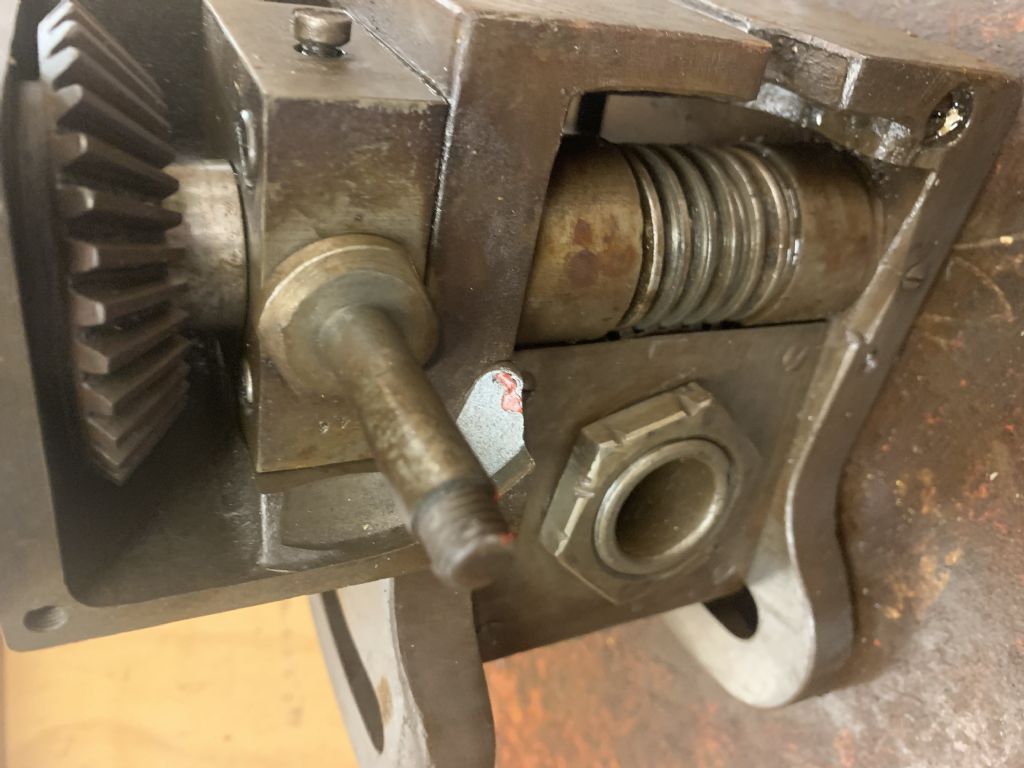

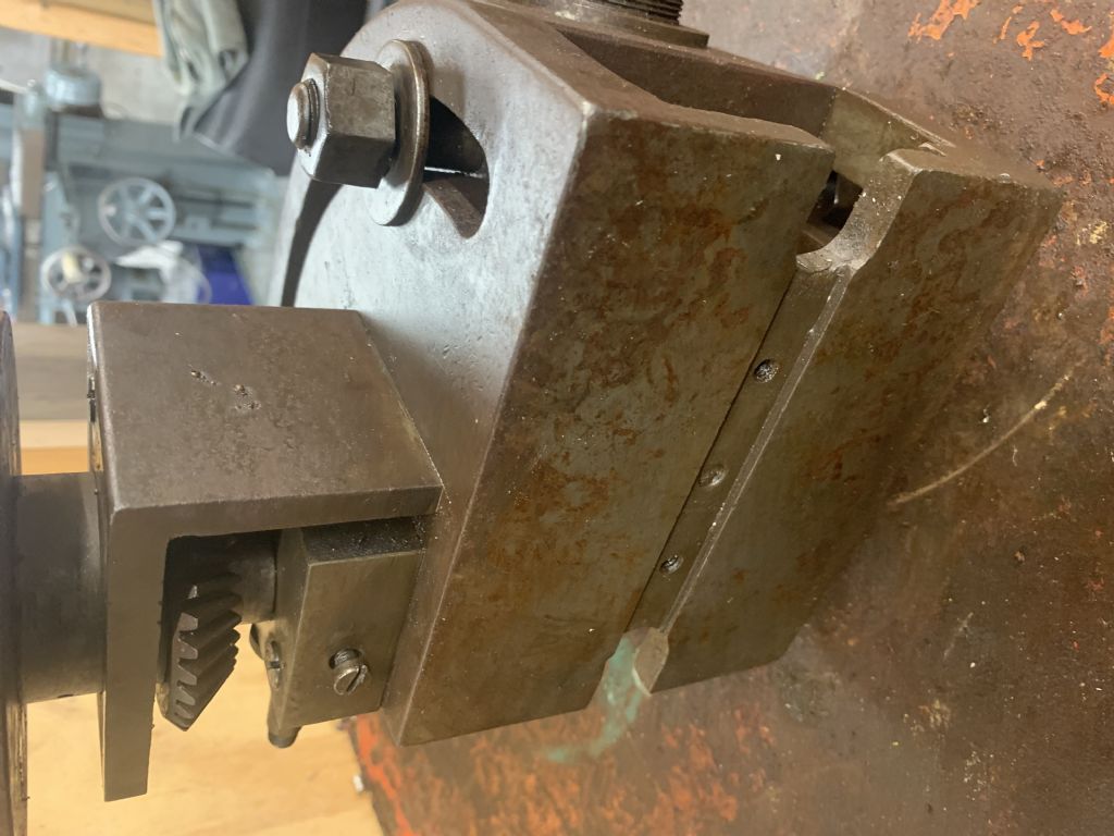

                              As you can see – there should be a gear (bevel) to help turn the other bevel gear.
                              #550192
                              Dave Halford
                                @davehalford22513
                                The bevel engages with the missing aux. input shaft (and change gears) for milling helix's, it operates via a mill power take off when the division plates are not used.

                                        It's common for the drive shaft from the mill table leadscrew to maintain a ratio of 1:1 until it reaches the worm drive on the dividing head spindle. Bearing that in mind, and looking at the existing gear and witness marks, I think the bevel gears are a special case, ie, mitre gears. So we just need a copy of the existing gear in terms of tooth count and angles.
