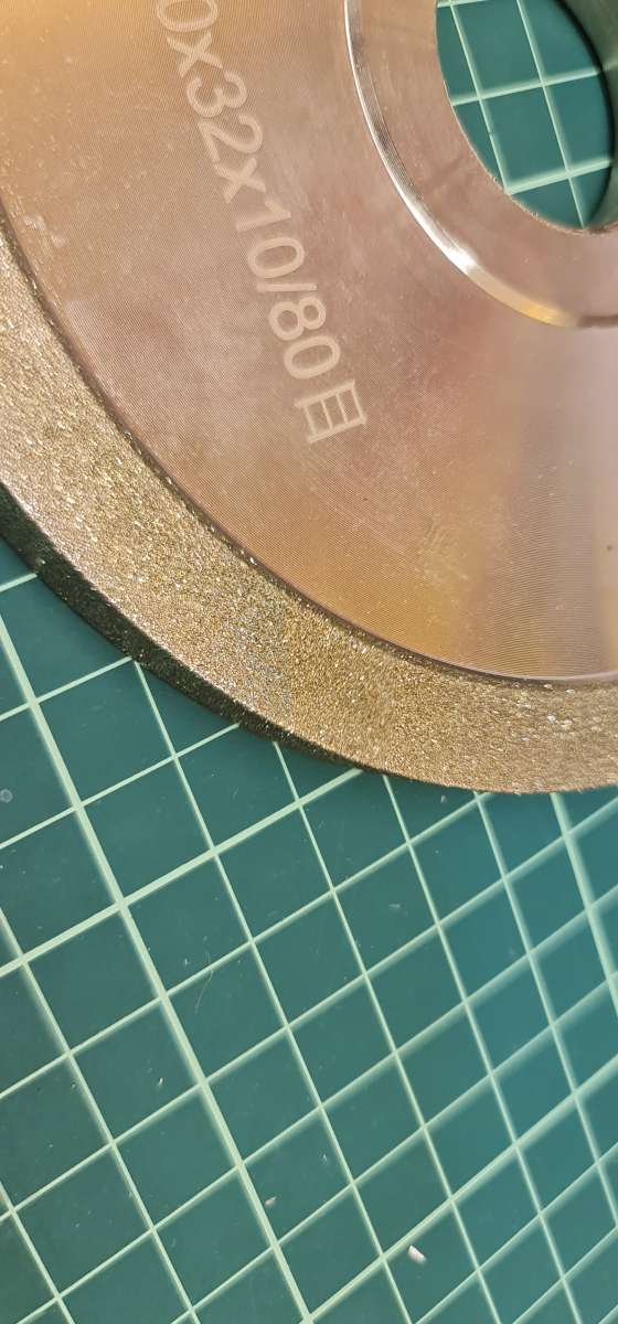

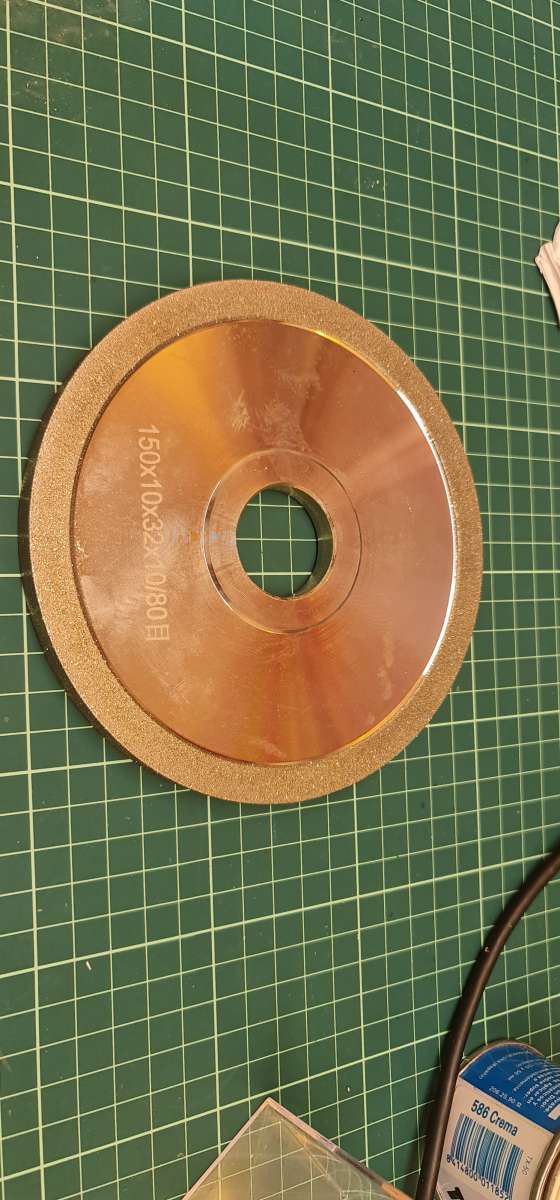

      I have this diamond grinding wheel and I want to mount it on a grinder that has no wheel cover. I assume it should be safe, since it is a metal wheel. Buy I have just one doubt. How thick is that material that contains the diamond stones? Is it only 1-2mm? Or the last 10mm of the diameter? Because in the last case in theory that diamond mix material could not break?

        The diamonds in those kind of wheels are usually just in a thin layer plated onto the core – I think the numbers are telling you that the coated area extends back 10mm from the edge of the 10mm wide wheel, and the coarseness is ’80grit’.
        The risk you need to guard against is that some object falls against or is otherwise ‘picked up’ by the wheel and flung out at you.

          That’s an electroplated wheel – no chance of that bursting. The coating is very thin. Diamond wire sawing wire for cutting concrete is much thicker plated and that’s only about 1/2mm or so.
