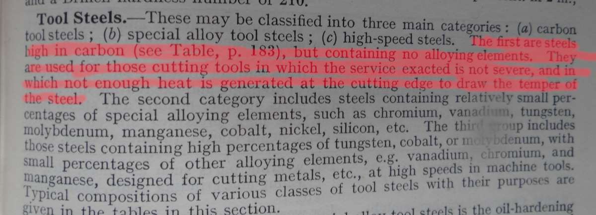

      On SillyOldDuffer Said:
      On duncan webster 1 Said:
      Sorry SOD, your definition disagrees with that used by that used by legions of engineers. Referring to Silver Steel, Tubal Cain (page 25 of Hardening, Tempering & Heat Treatment) says ‘these steels are carbon steels with additives to improve performance’. …
      I’m surprised this is controversial, because, with all due respect to Tom Walshaw, the definition I quoted is that of the American Iron and Steel Institute.   This is the crowd who:
      … in the ’30s, it became apparent that the industry’s technical terminology had become chaotic. The Institute came to grips with the problem, and out of its efforts came the AISI steel products manuals. They provided makers and users of steel with generally recognized definitions, descriptions and practices pertaining to the manufacture, chemistry, metallurgy and adaptability of steel products.
      The AISI definition isn’t unique to them.   This is from the Chambers Dictionary of Science and Technology:
      DSC06843
      By that definition, Silver Steel is not a Carbon Steel, because it contains Chromium.  Ditto Drill Steel and Gauge Plate.
      Perhaps the confusion arises because two different approaches are used to classify steels.  Hence what British buyers call EN1B-Leaded, will actually be 9SMnPb28, 9SMnPb36, 11SMnPb30 or 11SMnPb37.   One approach categorizes steel by Usage & Mechanical Properties, the other by Chemical Composition.  Not making it up, I am quoting the official chemical definition of Carbon Steel.

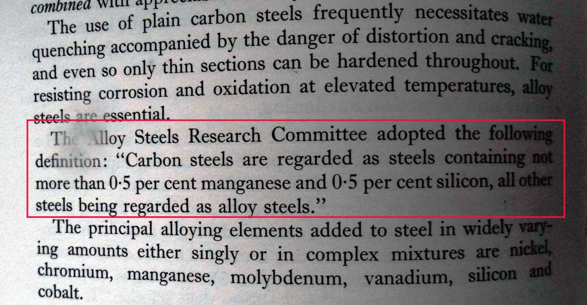

      But I’m not an American. They can call it what they like. In the UK silver steel is a carbon tool steel.
      Not according to the British Alloy Steels Research Committee!
      DSC06845
      And this is the equally British Newnes Engineer’s Reference Book:
      DSC06844
      Dare I suggest Tubal Cain put a misleading sentence in his book, that’s been misquoted ever since?  He said,  It is in fact a 1.1/1.2% carbon steel with the addition of about 0.35% Manganese, 0.45% Chromium, and 0.1/0.25% Silicon.   Do folk not bother to read past: It is in fact a 1.1/1.2% carbon steel?  Sorry to upset the apple-cart, but Silver Steel is an alloy steel.   It ceased to be a Carbon Tool Steel the moment Chromium was added.
