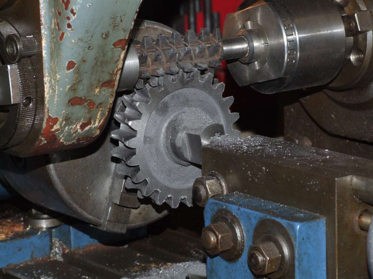

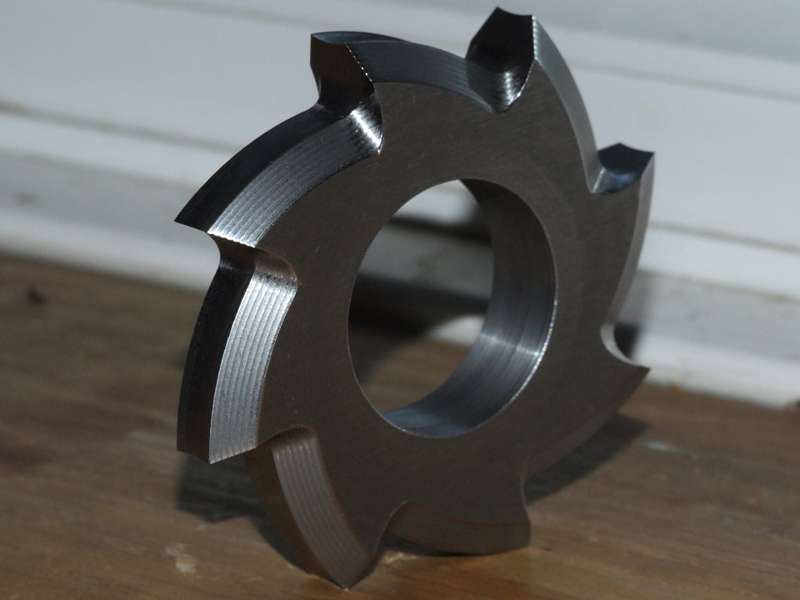

                    Here are some cutting tools made from gauge plate and silver steel, aka carbon steel, and running on 20th century industrial machine tools. Here’s a home made cutter, mostly using a hacksaw and files, cutting slots in steel:
                    2022_06080009
                    A cutter made from gauge plate for cutting splines (actually the spaces) on a SG cast iron crankshaft:
                    2013_08260080
                    And a hob made from silver steel free hobbing a cast iron worm wheel:
                    2013_11090021
                    I use carbon steel, HSS and carbide as appropriate.

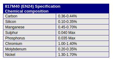

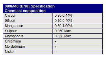

                              Well, what I mean by Carbon Steel is sometimes called ‘Plain Carbon Steel’.  They are allowed to contain Iron, Carbon, Silicon, Manganese, Phosphorous and Sulphur.   Adding anything else, notably Vanadium, Chromium, Tungsten, Molybdenum, & Nickel means we are no longer dealing with a Carbon Steel, because these elements are added for a specific alloying effect.  To add to the confusion, some of these alloys are called ‘Carbon Tool Steels’.
                              By my definition EN8 is a Carbon Steel, but EN24 definitely isn’t because the latter is alloyed.  Silver Steel is an alloy, not a plain carbon steel, because it contains Chromium.  And the Chromium was specifically added with malice aforethought by a metallurgist in order to achieve a desirable property not available from a plain Carbon Steel.
                              en8
                              en24
                              Next table indicates the properties of plain Carbon Steels: note they don’t contain any elements other that Iron, Carbon, Silicon, Manganese, Phosphorous and Sulphur.

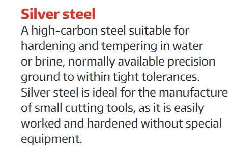

                                    https://www.westyorkssteel.com/tool-steel/silver-steel-bar/ describe silver steel as  precision ground carbon steel.
                                    Don’t expect absolute logic in engineering, it’s been going on for too long.

                                                      By that definition, Silver Steel is not a Carbon Steel, because it contains Chromium.  Ditto Drill Steel and Gauge Plate.
                                                      Perhaps the confusion arises because two different approaches are used to classify steels.  Hence what British buyers call EN1B-Leaded, will actually be 9SMnPb28, 9SMnPb36, 11SMnPb30 or 11SMnPb37.   One approach categorizes steel by Usage & Mechanical Properties, the other by Chemical Composition.  Not making it up, I am quoting the official chemical definition of Carbon Steel.
                                                      But I’m not an American. They can call it what they like. In the UK silver steel is a carbon tool steel.
