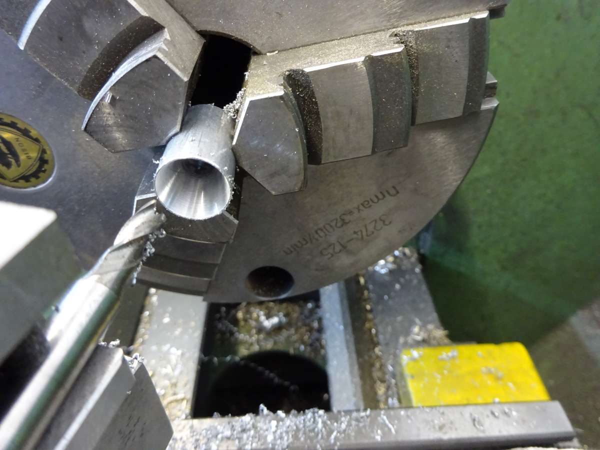

              I suspect lack of clearance is pushing the cutting edge off the surface rather than the tool deflecting under load
              One way to get better access is to cut the female taper with the big end facing out and with the topslide still set at the same angle run the lathe in reverse and cut on the back side to do the male taper, if you need to use tailstock support on the crankshaft then just mount it with the small end of the taper facing the headstock.

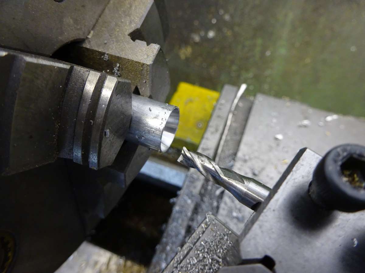

              A milling cutter also makes a good boring bar when you get down to these sizes, hold it in the toolpost with one flute on ctr height. Not quite parallel to the angle of the topslide so the side does not rub Not a flywheel but a similar size taper being cut for a venturi. 5mm dia cutter will work for your 6mm min hole. At 5mm it will be stiffer than most small boring bars

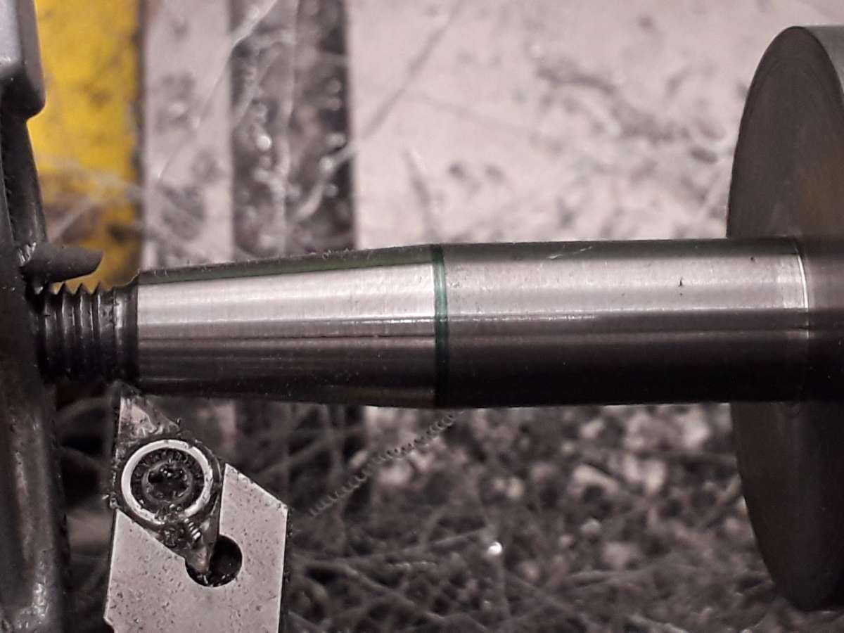

              This one was cut with the tool cutting on the far side, Crankshaft taper being used to test fit the distance it goes in upto the red line.

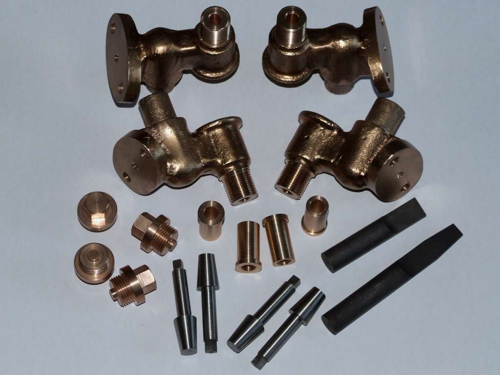

                      The tapered valves and the D-bit used to make the tapered, blind and flat bottomed holes are show along the bottom of this picture:
                      Check_Valve_Parts
                      The valves and D-bit were machined at one setting on the lathe, although to get the best surface finish they were then ground on the cylindrical grinder. The tapered seat was stepped drilled before using the D-bit to form the taper. Internals shown here:

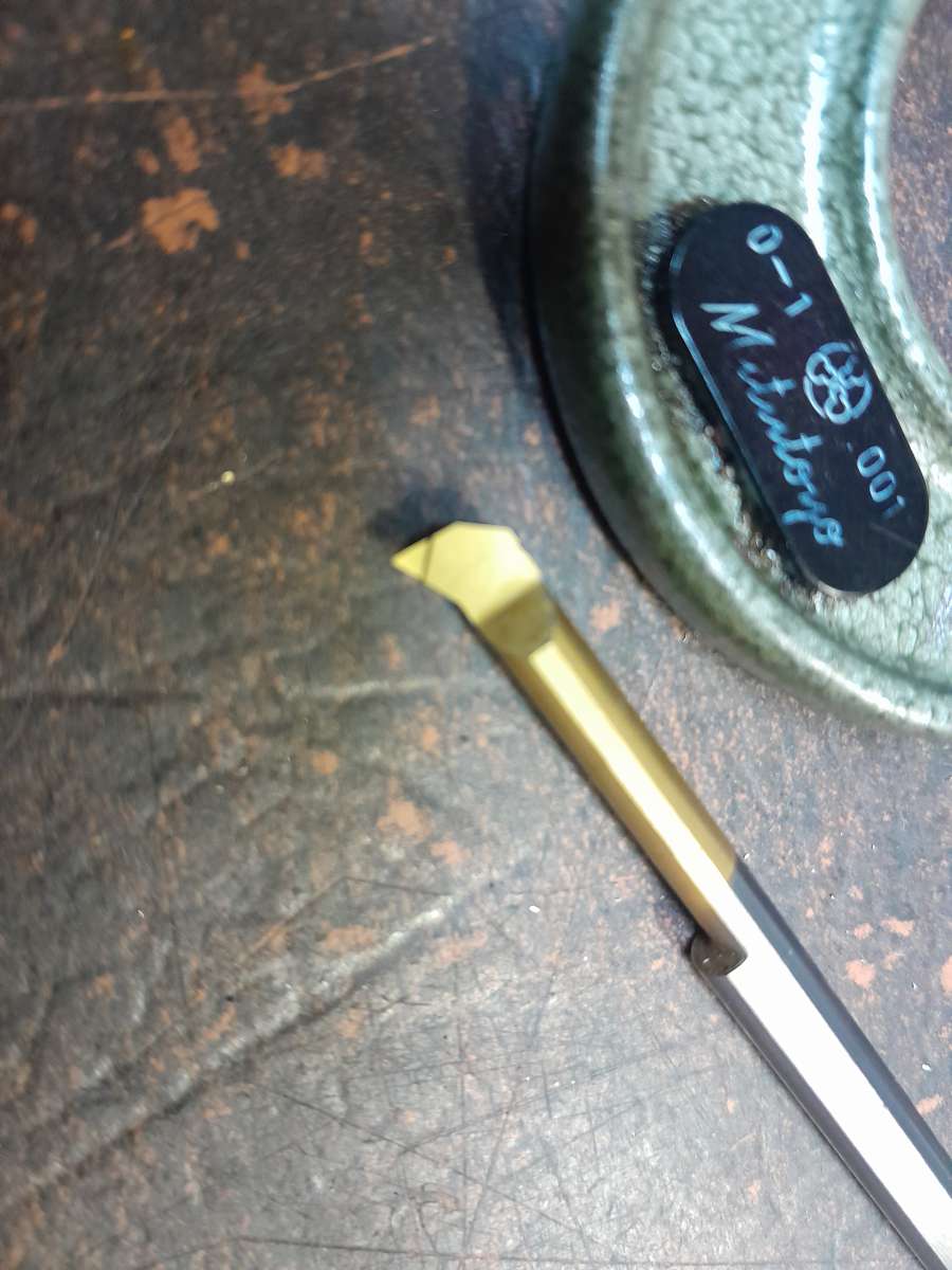

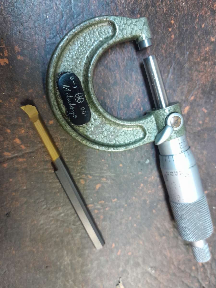

                          Or you could treat yourself to a new solid-carbide or cermet micro boring bar. I have seen them down to 3mm. Ready made for the job and not expensive if you shop around.
                          I have a 5mm one and it works  brilliantly.

                                        Micro boring bar. Less than a fiver a shot. Solid carbide or cermet.
                                        They even have a little chip-breaker ground on the tip. Cute as a bug.
