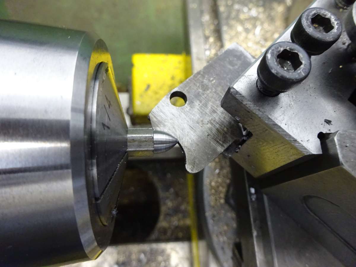

              You don’t really want HSS to make a form tool unless you have a cylindrical grinder. Assuming you mean a D bit rather than form tool then that is best made from silver steel and then hardened (tempering is optional)
              Turn a male taper on the silver steel at the same setting you turn it on the crankshaft. Then mill or file away half the diameter and use this to finish the hole at slow speed after hardening. No need to machine any other clearance angles as as the two were turned at the same setting angles will match.

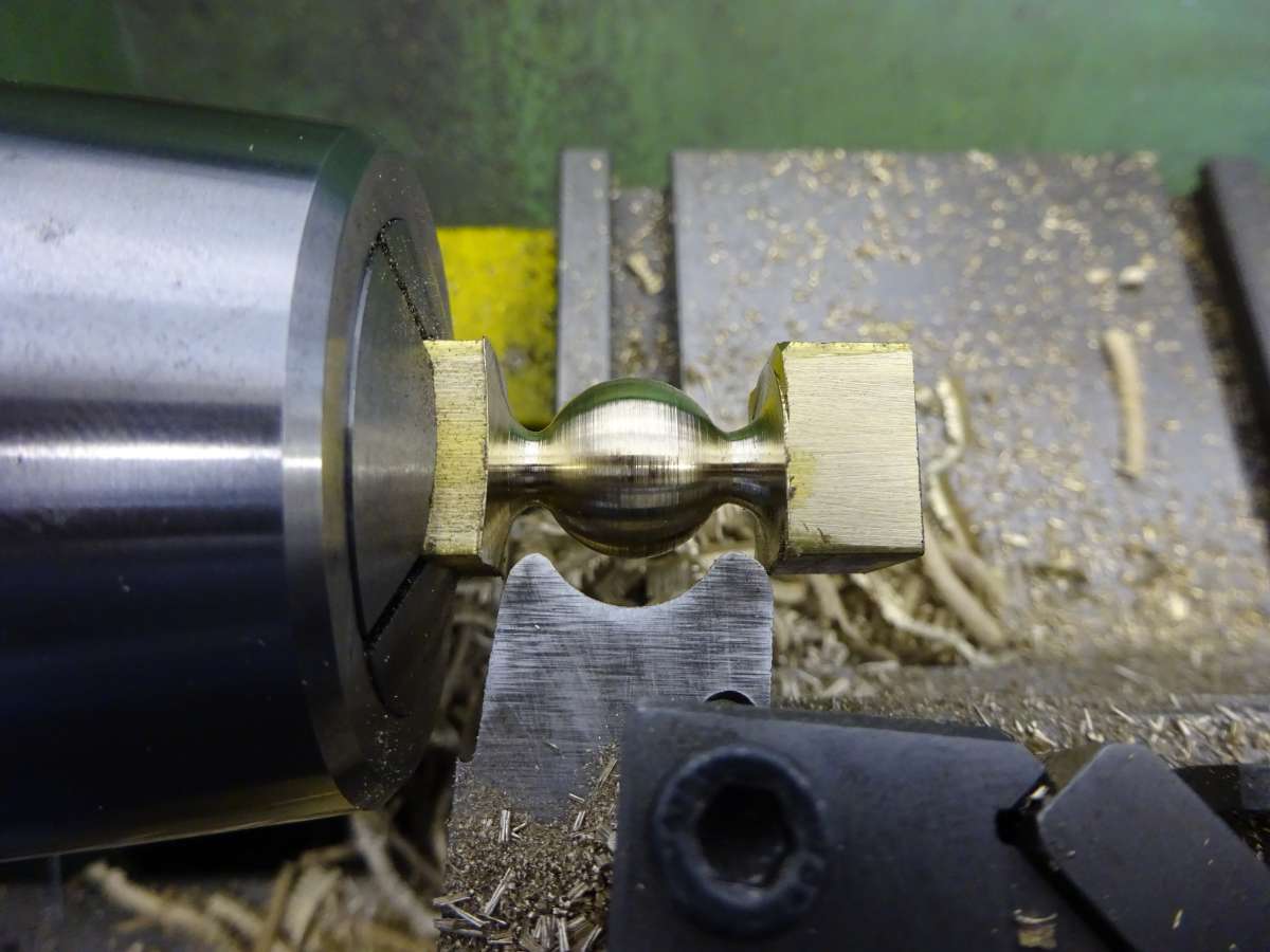

              I don’t feel your hole is really small enough to need a D bit but this is probably a clearer picture than Andrews. Part needing the tapered hole in the middle, finished male part on the left and the d bit/reamer on the right

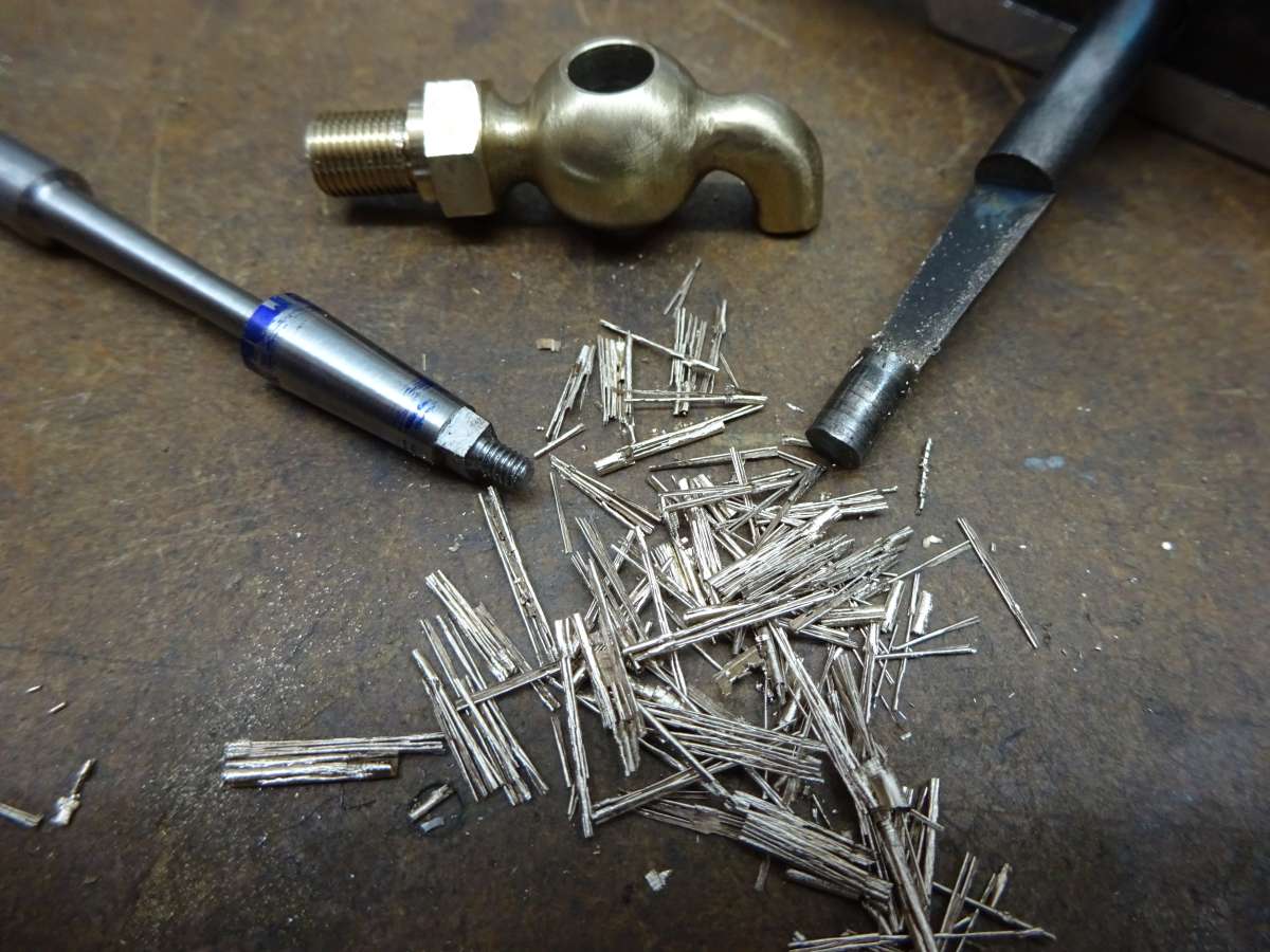

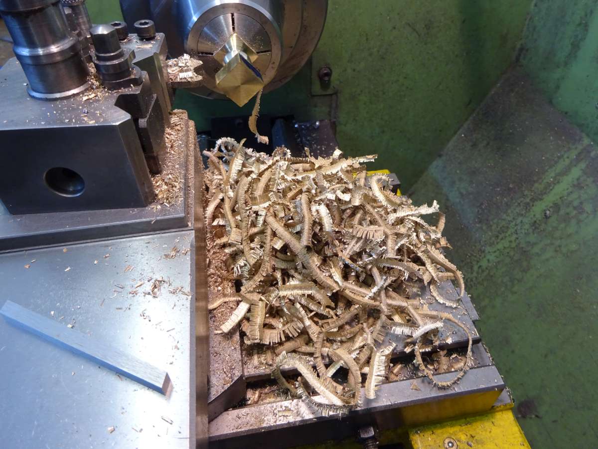

                                Well I’m of the simple approach, heat to a cherry red with blow torch no heat treat oven  for me, quench in water and use. Not noticed any of my cocks leaking and my form tools cut the shapes I want.
                                Not heard of the size change particularly reducing when tempered but is that before or after cleaning off the oxide so you can see the colour change? as that may take the part back to original size.
                                Water quenched gauge plate untempered cutting brass OK and then modified the shape and it cuts steel too.

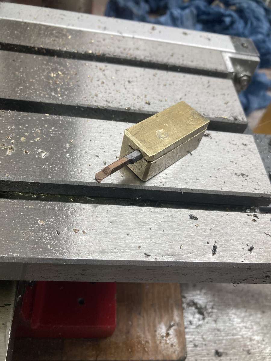

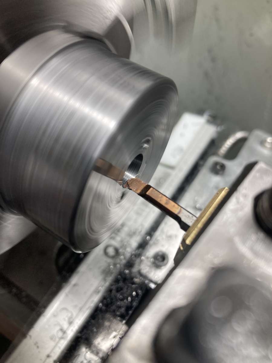

                                      Thank you @Hopper, I tried your idea of micro boring bars and I am very pleased with the result, it worked very well, internal and external tapers match well, a first for me.
                                      As a back up plan I bought HSS/silversteel bars and a couple of 4mm end mills!
                                      IMG_5694
                                      IMG_5696
                                      Goodness, these things are tiny!
                                      #755390
                                      Hopper
                                        @hopper
                                        IMG_5694
                                        IMG_5696
                                        <p style=”text-align: center;”>Hey that’s great. Glad it worked out for you. And thanks for letting us know the result.</p>
                                        Yes those little micro bars are the bee’s knees. I love the one I have and plan to buy a couple more even smaller ones, just because!
