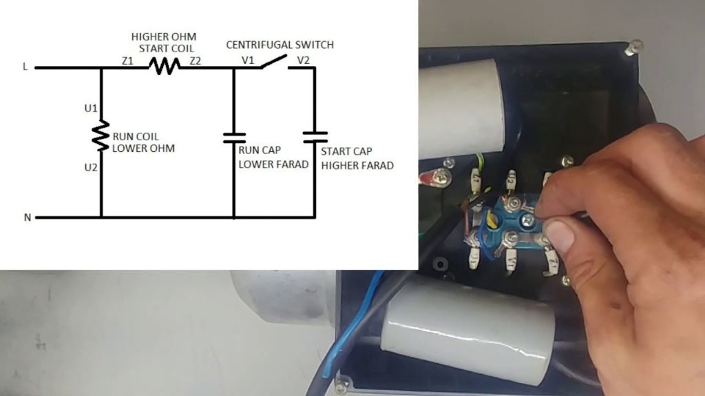

      Hello,
      Can anyone help me wire up a motor please?
      Here's some pictures of the bottom of the motor and a table that came with it.
      This is to power an old Fobco pillar drill with original rotary switch.
      I just need to know if I need a capacitor (or two and what specs?) and where I need to hook up Live, Neutral and Earth. Just one direction please, nothing else.
      Thanks a million.
      Photos:
      1
      2
      3
      Edited By John Mitchell 9 on 19/12/2019 19:46:38

          U1 and U2 are the run windings and need to be connected across the line (brown) and neutral(blue). S and Z2 are the start windings and dictate which way the motor will run. To reverse the direction swap S and Z2. The picture of the motor shows links U2 /Z2 and S /U1 This will work, But if rotating in the wrong way then link U2/S and U1/Z2. You ask about capacitors ! Are none fitted ? is there any sign there where any fitted ?

            You have two windings, start, and run, the run winding is U1 andU2, and the start winding is Z1 and Z2 both windings are connected across live and neutral, with the centrifugal switch in series with the start winding. Those copper links look wrong! First, remove the yellow wire from the terminal and test between the yellow wire and Z2, you should get continuity, indicating that the yellow is Z1. Next you need to find which terminals the centrifugal switch are across, so you will need to be able to open and close the switch by poking it with a screwdriver, or sliding the bob weight mechanism to the open position. It looks like Z2 may be one end of the switch, but you can confirm this with a multimeter. Once you have found the switch, you connect the live to U1 and Z1 and the neutral to U2 and one end of the switch, the other end of the switch is connected to Z2, Try the motor, it should run up to speed and run quietly. if it buzzes, but runs up to speed if you spin the shaft, it may need a capacitor, but if there is no signs of one ever being fitted, it is probably designed to be self starting. If it runs off load, but will not start on the drill, try a 4mf cap in series with the start winding and switch. Like this, but you will not need a run capacitor, and you may not need one at all. Hope this helps, and MAKE SURE IT IS EARTHED!!!

                Noel beat me to it, to reverse just swap Z1 and Z2 which changes the polarity of the start winding, and gives the rotor a push in the opposite direction. Good luck!

                  From the diagram No3 your motor uses S instead of Z1 and the links on this basis are right. N

                      My Brook Crompton wiring sticker says swap blue and yellow to reverse. I guess it would have the same effect.
                      John, putting live and neutral to U2 and U1 will make it run. Doesn't matter which way round. To reverse the direction swap blue and yellow. Basically the copper links are in place of a reversing switch.

                        Correct, blue and yellow are the ends of the start winding.

                            The switch and the start winding are in series so when the switch opens the circuit is broken regardless of which way round it's connected.

                                Yes, yellow is a link to the switch.

                                    I thank you all for the excellent input. I had to read a few times to take it in but I can now confirm that the motor is wired up and works as it should. A few things I went through:
                                    – I measured continuity between yellow wire and blue post. Indeed there was continuity.
                                    – I removed the copper links as they didn't appear factory. I had to put them back as the motor would buzz but not spin, even after helping it wit manually spinning the pulley.
                                    – Pete Rimmer, you are dead on with your suggestion. It is a reverse rotation linkage. I figured it after removing it first and comparing to the diagram. Not that others provided a lesser input. I am glad people take time to explain things rather than just give a shortcut. Now that I "get it", all makes perfect sense.
