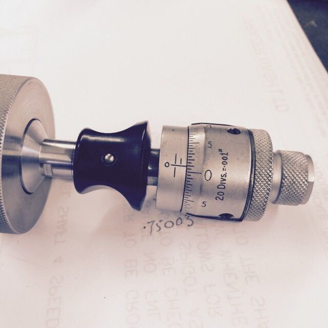

      ihave a Coventry Gauge Micro Maag which I acquired some time ago.
      image.jpgIt is a three point bore measuring device. There are several heads and the three points are forced outwards by a taper pin which is moved by a thimble . There are ten of these tapered pins each with a range of +/- 3 thou.
      The black bit is a spring loaded plunger which moves the tapered pin however
      i can't figure out exactly how to use it properly.
      Can anybody hel?

              It would be even nicer if somebody could tell me how to use itface 24
              The setting gauge is 0.75003 dia.
              When I attach the appropriate taper pin and set the thimble to =0.000 and insert it in the setting gauge by retracting the black sleeve and then releasing the sleeve the measuring head (that's what I call the bit with the three probes) is well and truly held tight in the setting ring.
              I don't know what to do next. Because it is such a precision piece of kit Im scared of damaging it through ignorance.
              I was rather hoping that some one on this forum might have experience in using one of these things and would be able to tell me what to do or point me to an instruction manual. I have Googled with out success.embarrassed

                Is the setting guage marked as being 0.7503" or is that what you are measuring with the guage head as presently set up?
                I would have expected the release of the black sleeve to leave you with a sliding fit when correctly set up with the thimble indicating +0.003" (ie the thimble is measuring 0.7503" if this figure is the true setting guage diameter)

                  KWIL, That's what I thought too.
                  I tried setting it below .750 (or so I thought) and it was still tight.
                  Maybe I'm being fooled by the 20 divisions to the thou and I'm being too clumsy. I'd better go back and have another go.

                    It's a bore mic set. Micro Maags are very good ones though.
                    The black collar is the quick release to change heads. Each head covers a very narrow range of sizes.
                    So you have a nice bore, ideally a ground one;
                    1. Find the head that covers that size.
                    2. Wind the thimble all the way out.
                    3. Pull back the collar and slide the correct head on and release the collar. Make sure it is retained by the detent.
                    4. Fit the head into the bore.
                    5. Gradually wind the thimble in while moving the mic slightly to ensure it is centrally located and concentric. The three blades will extend.
                    6. Read the thimble just like an ordinary mic.
                    The other bits are extensions to extend the head for deep holes and a reference setting bore which may have been reground in its time.
                    "Feel" is important with these.
                    HTH smiley

                                Right then! I've been in the shed and learned a bit more- I think I've cracked it.
                                The setting gauge was 0.75003 and thimble also needed adjusting. The fiducial line has three marks on it, one just on the thimble end, a short one and a long one. The short one represents mid point on the tapered peg and the two others represent + & – 3 thou for that particular peg.
                                I discovered that when the thimble is screwed right in when there is no measuring head in place the black slider will not slide. Wind it back a little bit and it slides back with a click.

                                    I was at this point that I discovered that the black sleeve will not slide when the measuring prongs are tight home on the bore.
                                    It seems that the method is:-
                                    1. Wind the thimble fully out.
                                    2. pull the slider back.
                                    3. Insert the measuring head into the bore.
                                    4. Wind the thimble in until resistance is met
                                    5. Check that the slider will not pull back
                                    Now that is really clever because it diminishes the need for "feel".

                                      The quick release allows you to remove it while it is still on size. That way you can take a measurement even when you can't see the scale in situ. Also you can remove it without dragging it across the surface.
                                      I also used to pull it back when screwing a head on so it couldn't jamb on the cone. Go easy with the spanners
                                      Still, whatever works for you is fine.
