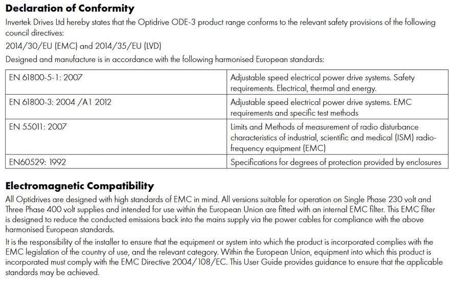

                        That Invertek VFD looks a good choice.
                        I see they claim CE compliance but this is limited not including the Machinery Directive and saying the equipment it is fitted to must comply on it’s own.
                        Invertec-VFD-EMCsml
                        It also state that the drive is only suitable for Pollution Degree 1 envronments This is defined as:
                        “No pollution or only dry, non-conductive pollution occurs. The pollution has no influence.”
                        A typical workshop won’t meet this so the VFD must be in an enclosure.
                          Invertec-VFD-EMCsml
                          Robert.
                          Yeah their talking about gas and certain dust being non conductive aren’t they.
                          Not swarf ect. I’ll get that one ordered once I’ve got the motor mounted up and I’ll source a suitable enclosure as per their specs for clearance/ventalation

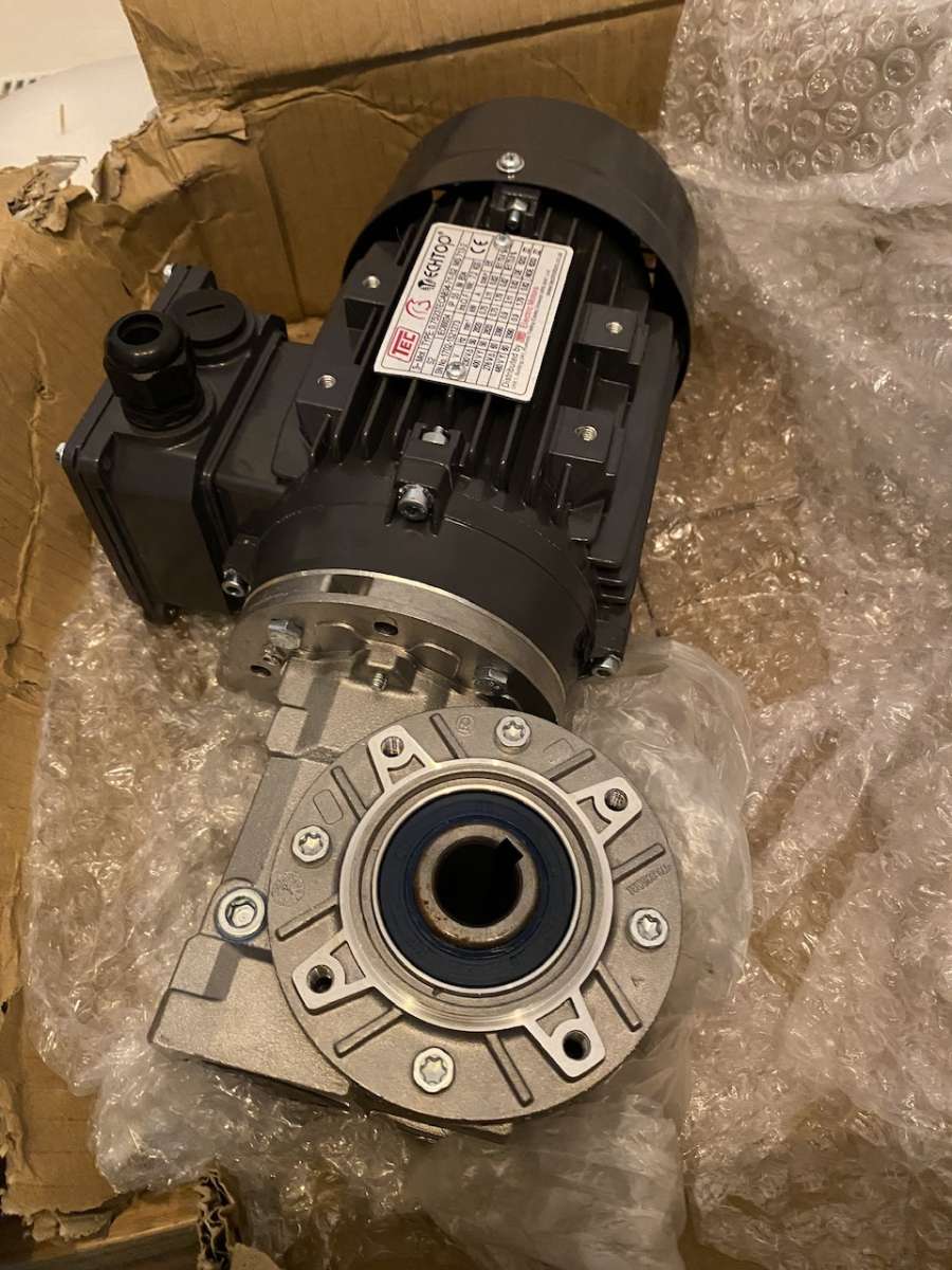

                                        andy198712
                                          @andy198712

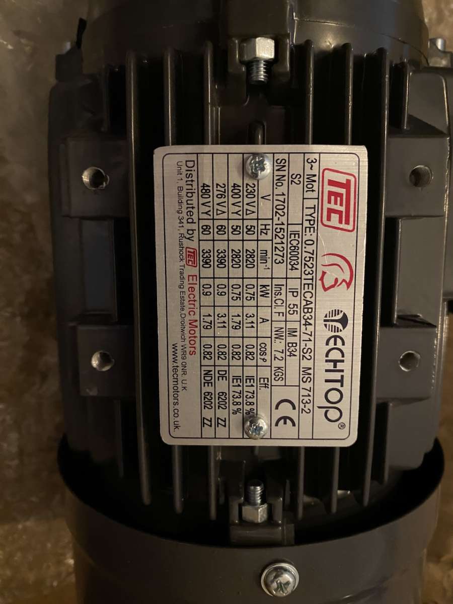

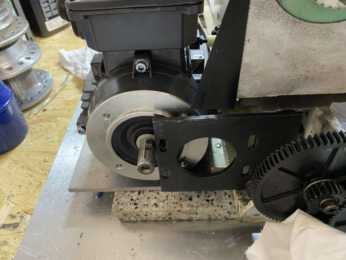

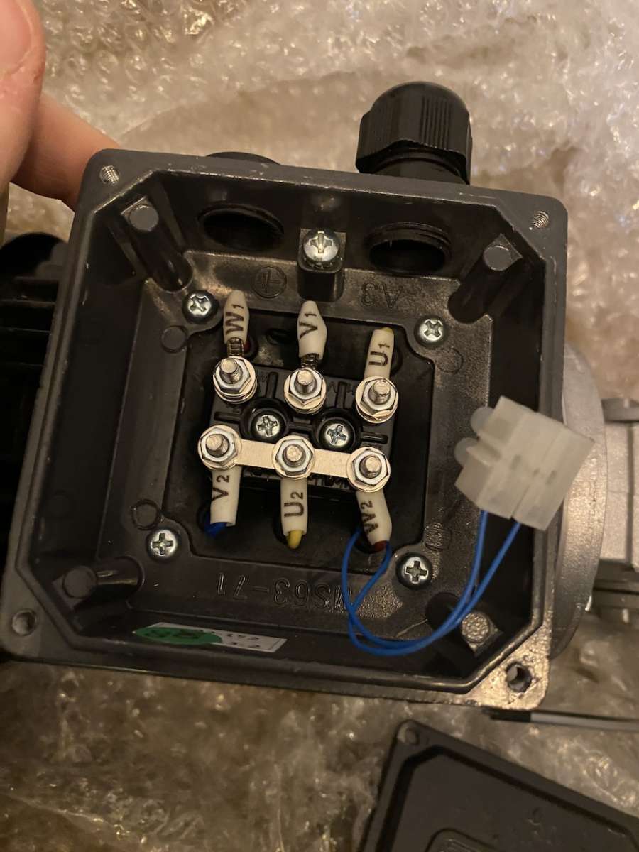

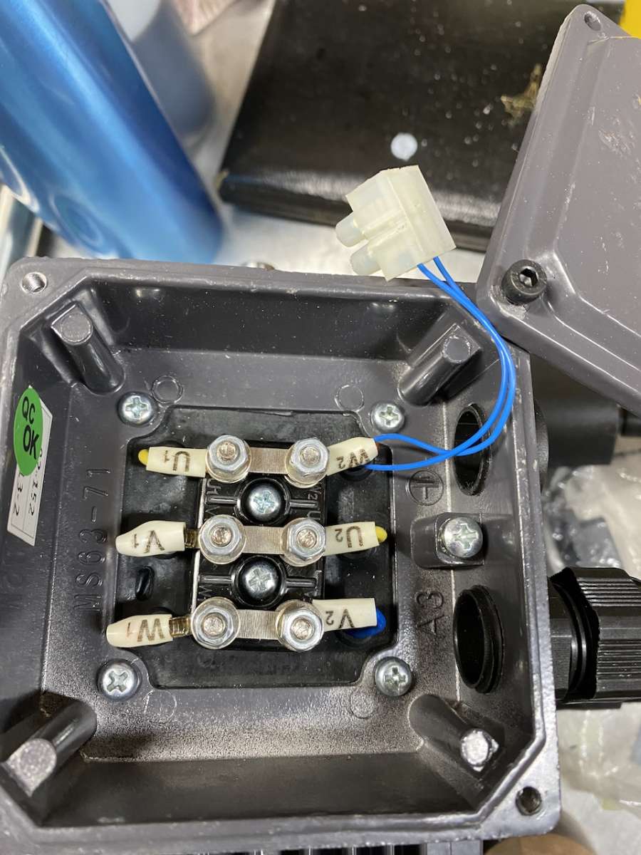

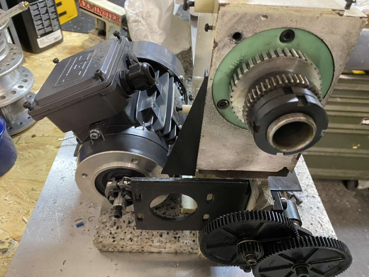

                                          Motor arrived! Really pleased to get a new motor for £49!
                                          has a 7-1 reduction gearbox should I ever want!
                                          Looks like fitment won’t be as bad as I thought, I’ll need to reshape the housing a bit on the change gear lever area and move the locator round 90* but should be okay I’m going to get some steel today to make a new mount.
                                          As you can see I changed the wiring over.
                                          IMG_3652IMG_3654IMG_3655IMG_3658IMG_3653IMG_3657
                                          #831717
                                          andy198712
                                            @andy198712
                                            Oh yes and the teeth count is 20 on the motor end and 40 on the lathe end so should work out quite nicely.
                                            #831722
                                            Robert Atkinson 2
                                              @robertatkinson2
                                              Looks like an nice motor, Glad the gearbox came off OK. Sometimes the worm can be hard to remove or even part of the shaft.
                                              The rating plate confirms it can run at 60 HZ and 3390 RPM at full power.
                                              The blue wires are a temperature sensor. The invertek VFD supports this but its not really needed on such a low duty application.
                                              Robert.
                                              #831742
                                              andy198712
                                                @andy198712
                                                Yeah that was a worry when it arrived if the worm was part of the shaft but it slid off easy and so do the cush type pulley/drive part.
                                                and my Sieg pulley fits snuggly on the shaft and same size key way.
                                                got some steel today to make up a mount and base ect
                                                Thanks for your help !

                                                  Having ordered my VFD from inverter supermarket and the cable above (thanks)
                                                  what does the enclosure need to be made from? Plastic or metal? In my head plastic feels safer but ?

                                                    I prefer metal but palstic is OK, If you have any external EMC filters or more than one VFD you should have a metal plate in the box with all the electrical bita bolted to it. This helps with any possible interference. Don’t forget to earth the plate.
                                                    Robert.
