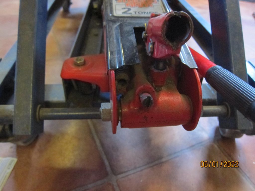

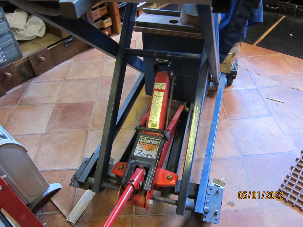

      Hi – I have a Clarke 2 Tonne bottle jack fitted to my 5" gauge engine building stand but the one issue I have with the device is that you do have to be very careful when operating the release valve as failure to do so results in the table coming down with quite a bump threatening the stability and safety of the whole assembly. I have got use to just cracking the valve when lowering the table but I am concerned that should it be operated by someone else, a member of the family for example in my absence, they would let it down as one would when using a standard roadside wheel jack with possible disastrous consequences all round. Has any else had this problem and come up with a means of fitting a controlled release?

          Have you left the jack with the original 'engage the jack handle release' arrangement? I made a simple knurled knob out of a piece of scrap Ali for my workshop press; it made control of the release/reduction of pressure much easier than using the jack handle type device supplied with the press.

            Further to the suggestion from Stueeee of a permanently fitted knob, or short handle, for better control consider adding a stop pin or flap to restrict the initial valve opening to a suitable slow descent position. Make the stop device spring loaded or hinged so it can be overridden when you want faster movement.

              You could add a lever to the release valve and then operate the lever with a screw to give both control and limited movement to the release valve. I don't know what your setup is like but this type of operation would allow you to put the release operating knob in a convenient position and also avoid accidental release caused by catching the release valve operating knob.

                Have attached a pic of the current set-up

                  Perhaps allowing even more control than a knob would be adding a lever to the knob.

                      How does the threaded part operate the valve at its base?
                      If it's a tapered fit, a bit like a brake bleed nipple, then maybe a new part with a more pointed taper, such that the hole is exposed slower as the bolt is unscrewed, similar to a carburettor main jet..

                          If that is the jack I think it is there may well not be room to permanently fit anything sensibly easy to operate to the release valve without interfering with the actual jack operation.
                          If that is the case look into whether some sort of L shaped, box spanner and lever, device can be made with the initial travel limited but striking the ground or part of the jack body. Further opening would require the spanner to be removed and refitted putting the lever clear of the obstruction for another partial turn. I have encountered more sophisticated variants of that style of device which were permanent assemblies with sprung loaded detents restricting the travel to half or one third of a turn at a time. Pushing the knob down let it move past the detent for another bite.
                          I'm sure the same sort of thing could be arranged with a spanner device and suitably shaped head on the release screw. The bottle jack on my home made press, similar design to Sueee, has a flat bar shape on the end of the release device so restricting to half a turn at a time is easy. The T-bar handle spanner I made for the job turned out rather longer than I'd ideally have liked due to having to avoid a projection that would have restricted it to half a turn at a time!

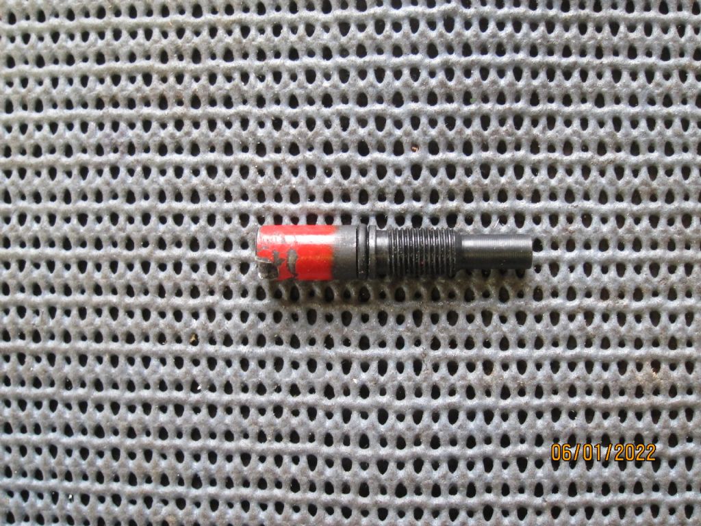

                              I have attached a photo of the release valve removed from the jack. The thread mikes up at 9.70 x 1mm pitch and has a square end face whereas I might have expected a taper fitting. The thread is presumably a nominal 10x1mm. Shinning a light down into the valve body reveals a corresponding flat seating face but it was not obvious without further poking around whether or not a washer of some sort is in place.

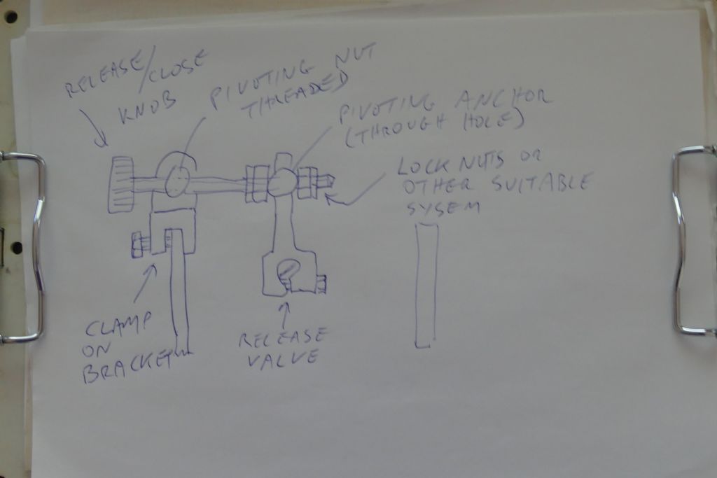

                                  A small clamp-on bracket on the left hand plate, a pivoting nut on that bracket, a clamp-on lever on the release valve with a pivoting anchor point at the top and a screw with knob between to two pivots and you have a controlled release mechanism for very little cost or effort.

                                    Martin – Perhaps a simple sketch of what you have in mind would be useful.

                                      Is there a ball in the hole under the flat ended screw? That's sometimes done as a cheap option that is tolerant of the fluid port not being quite concentric with the thread. If port is not concentric with thread, it's more difficult to produce either a 'needle' or a 'spline' tip on any replacement item to give finer control.

                                          Michael – Looks good – Many thanks for that

                                              All I would say is does that design put any part of you underneath the table?

                                                Dave, how far down can it go before it hits the jack? How long a screw can you put on it? It's a concept drawing not a scale drawing. As I said earlier you can put the operating knob in a convenient position or even make it so you can use the supplied handle from outside the danger area to operate it. What about a flexible drive shaft to turn the screw, lots of options.

                                                  Is it wise to put a may be £10,000 model on a £20 jack or trolley ? Using a small single acting Hydraulic cylinder, manual pump and release with a restricter in it will work – but cost much more than £20 OR a double acting cylinder and change over valve and pump up and down !
                                                  PLAN B, Forget Hydraulics and use a mechanical system based on a leadscrew and nut – when your finger or leg is in the works it will hurt, this is a signal to STOP winding handle. Fail safe !!!! Noel.

                                                      If you could make a replica control valve, but with a tapered end, (Say 30 degrees angle ) so that the taper enters the hole when closed.
                                                      Unscrewing the valve will open up a small annular passage for the hydraulic oil, rather than the minute retraction needed to give the same rate of descent.
