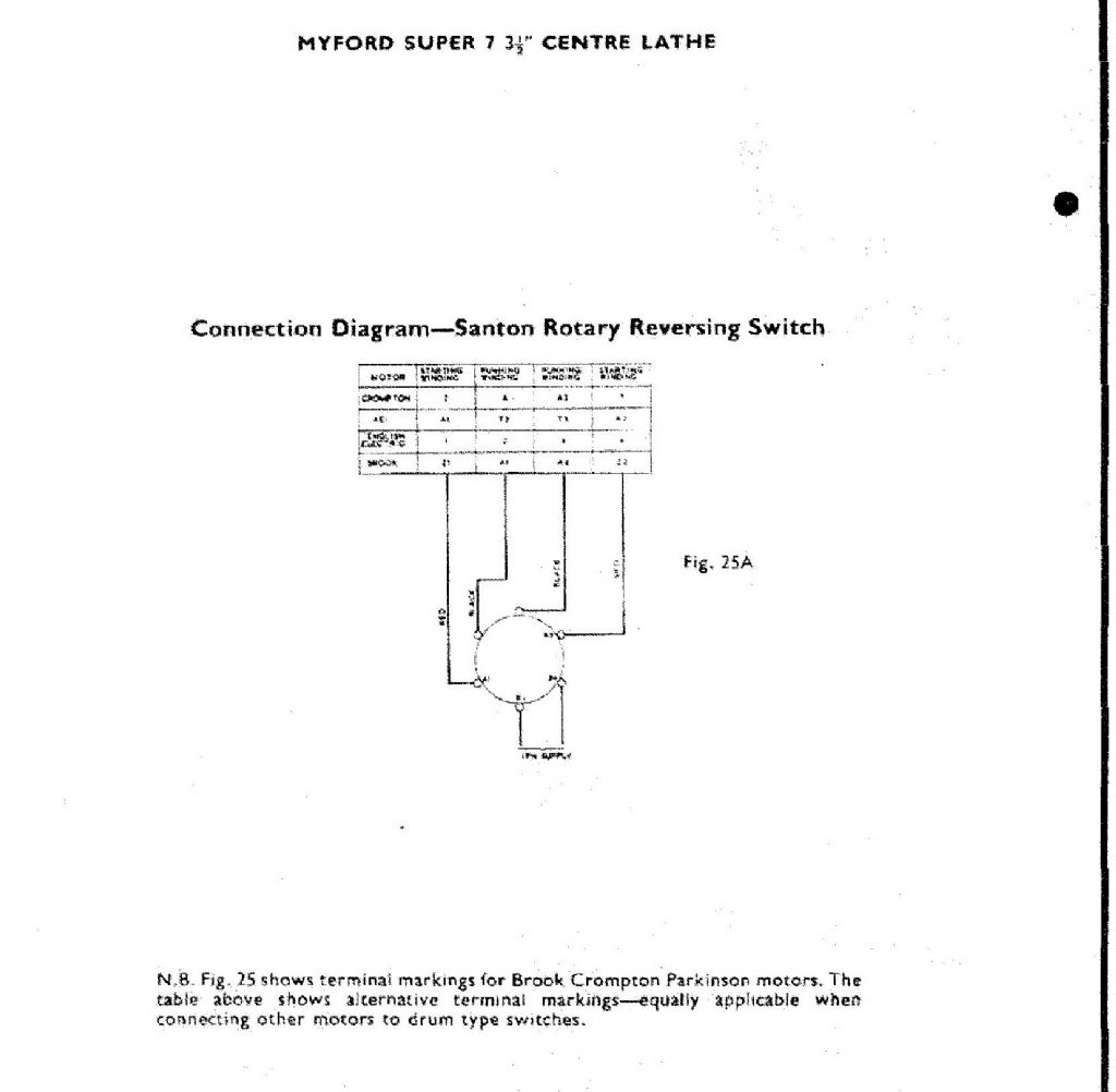

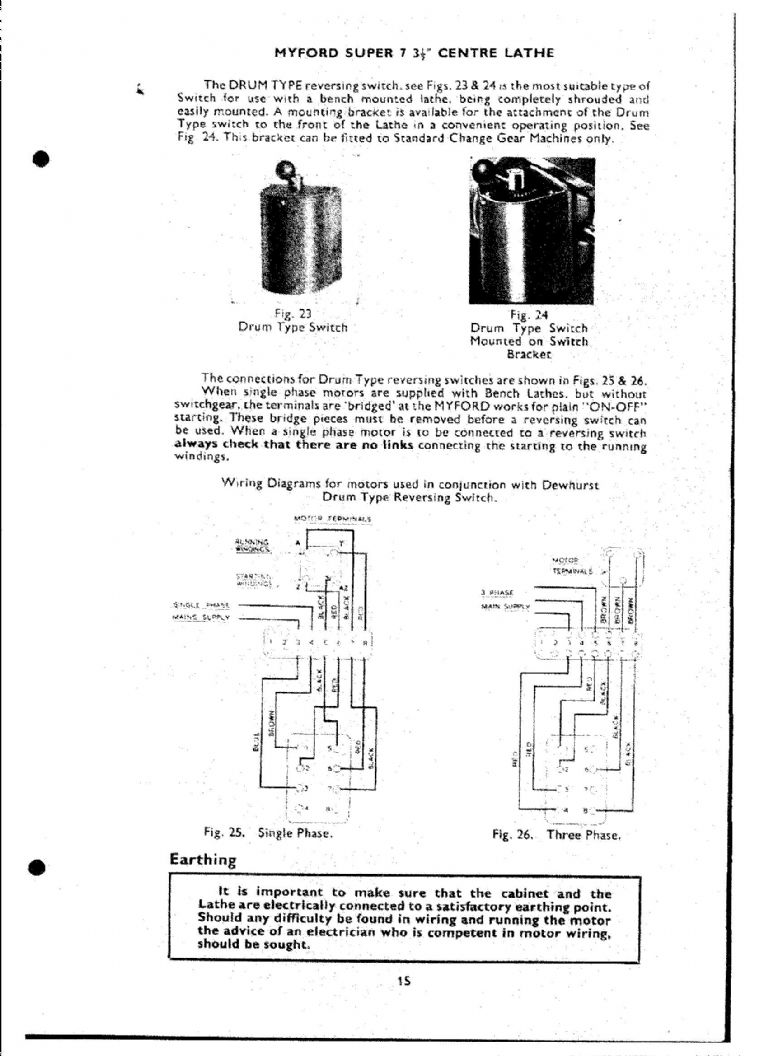

                Sorry this is a bit of a fag packet drawing, but was in the drawer of the lathe when i bought it. Super 7.
                Steve.
                #525278
                Steviegtr
                  @steviegtr
                  Here's some more from the Myford manual. Hope they help.
                  Steve.

                  #525279
                  Terry Holden
                    @terryholden56477
                    Thanks Steve those are the connections for a Dewhurst switch. The one I have is similar but with different connections. I still need to check that I am getting the right connections between switch and lathe as in my second paragraph at start. Thanks for the help.

                      Steviegtr
                        @steviegtr
                        Posted by Terry Holden on 06/02/2021 15:55:29:
                        Sorry just added another type of sw.
                        Steve.
