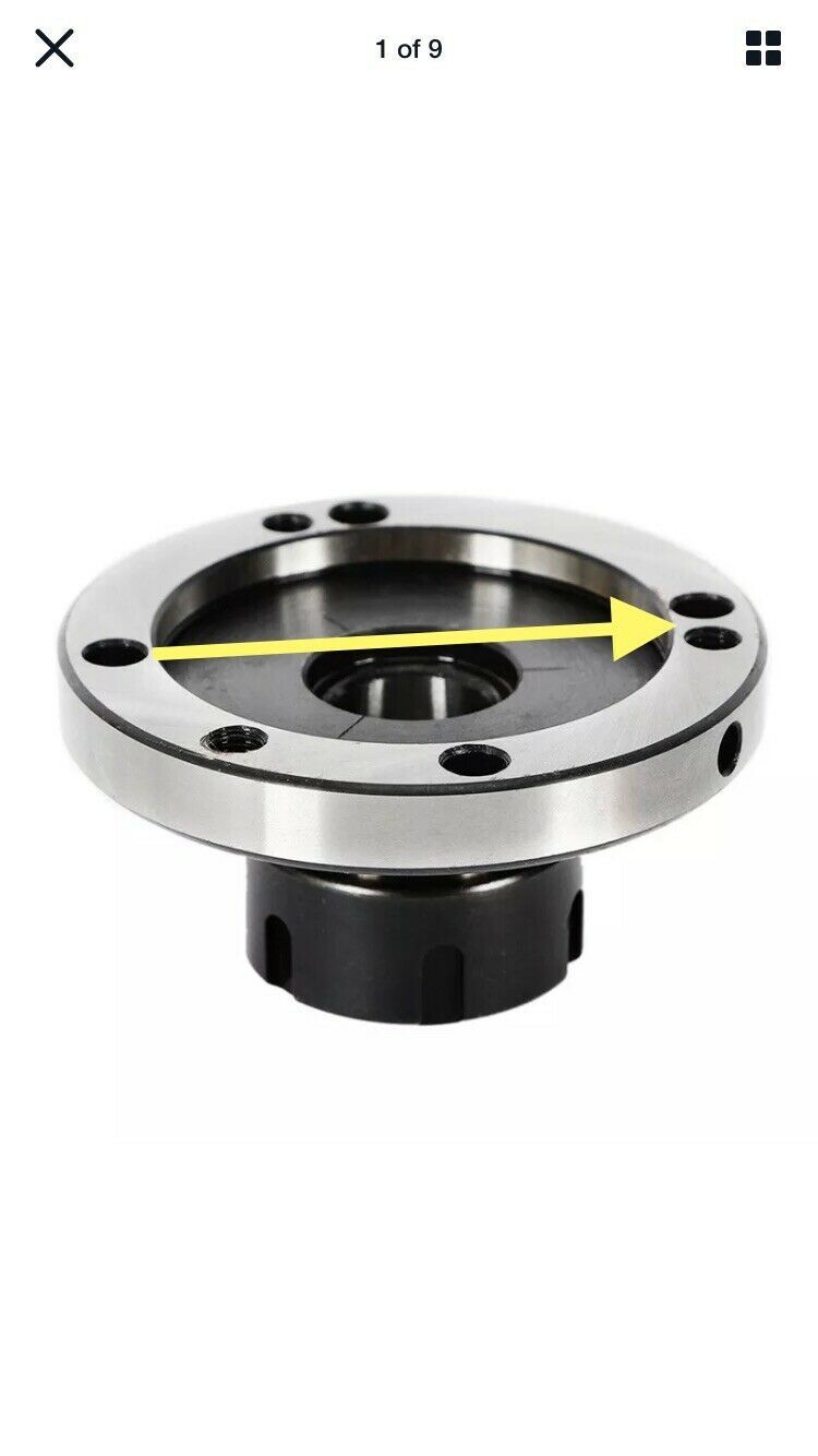

I have an er25 version on a backplate, of course, the register is loose for fine adjustment, after all, if the register is tight, you have to put up with whatever runout each collet gives.
You can buy them with a choice of 80, or 100mm outside diameters.
