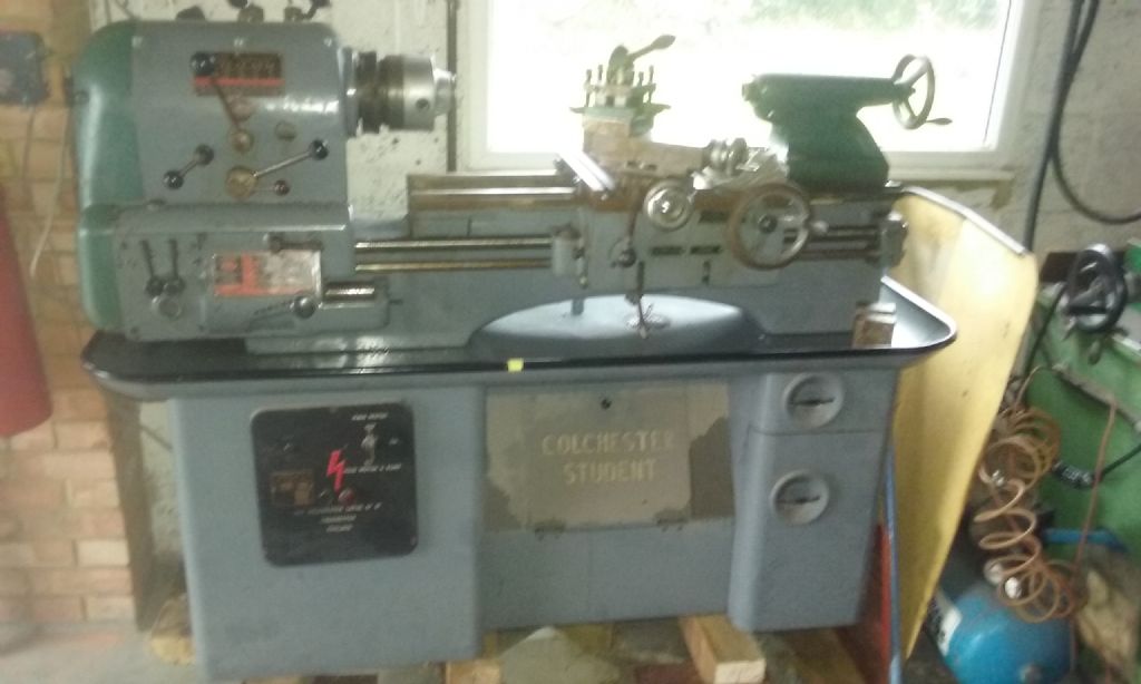

            Hi Phil.
            Thanks for responding, that's lovely. Mine is a MK1.5, I have a PDF version of the manual. My primary problems are , How to check the headstock bearing, and how to replace the main operating lever spring as it falls under gravity so has to held in place whilst working. The manual show a spring but I cant work out whether its buried in the head stock or some where behind the reserving switch can on the back. Once found where can I find a spring as spares availability seems hit and miss and in some case very expensive.
            #355645
            Nick Taylor 2
              @nicktaylor2
              Hi simon, that looks like a Mk1 to me. What makes you think you need to check the headstock bearings? I would just change the oils, fix the lever spring and get making things on it – I’m sure you’ll discover any problems as you go!

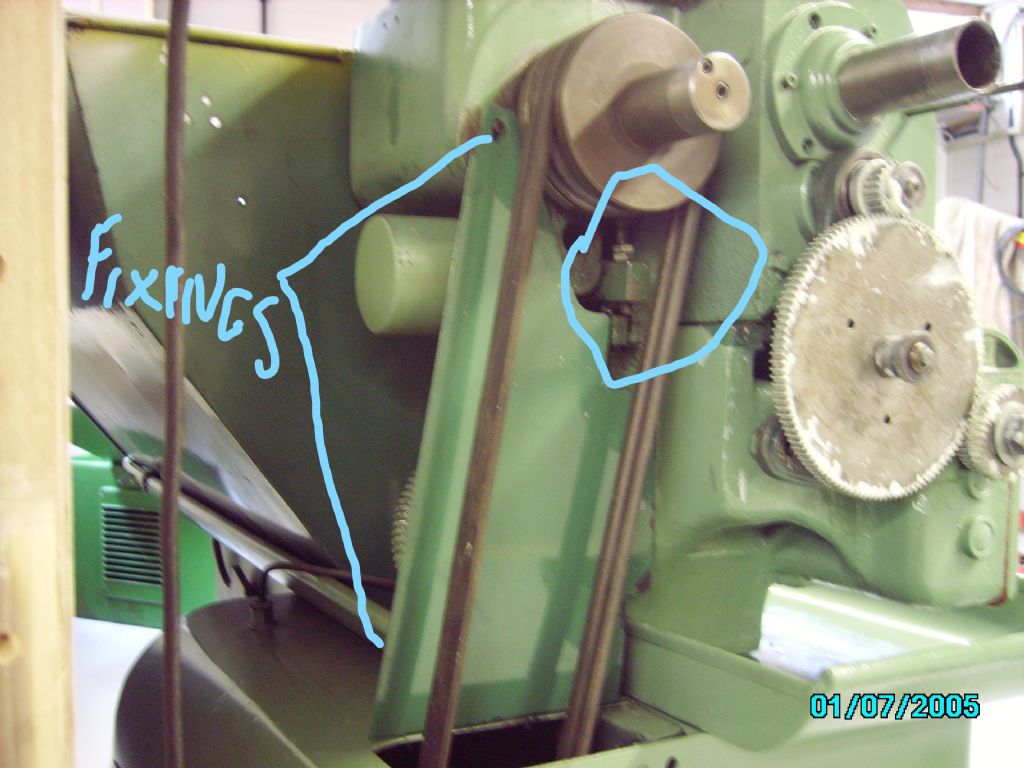

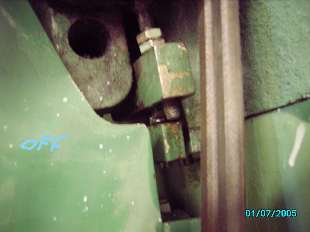

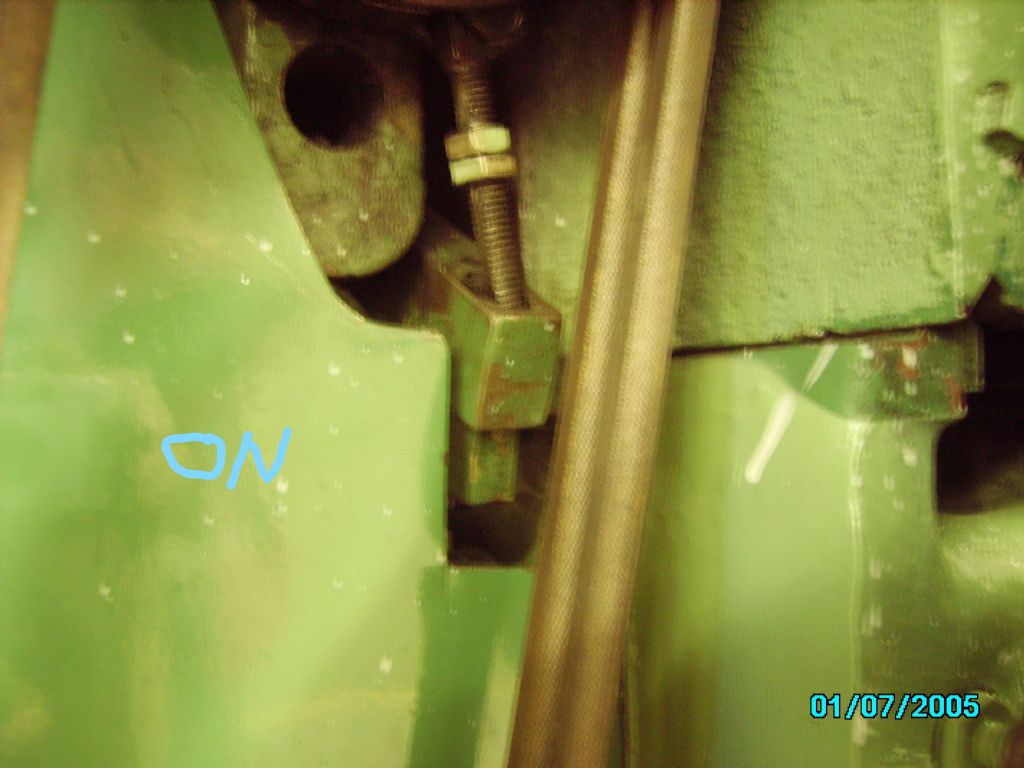

                            Take your point Simon, it is different, matrix clutch eh! real nice extra to have, is it single plahse or three phase? I will post these pics for reference anyway. I would take off the end cover, and the triangular plate, if you have one, and have a look in that end. It looks like whatever mechanism yours has hides behind it.
                            Phil

                                Makes sense, single phase from new machines had the matrix clutch fitted so the motor was started off load, mine is three phase, and luckily, so is my workshop! I will be interested to see what you find.
                                Phil.

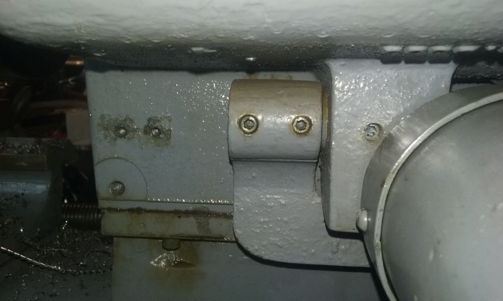

                                    Hi All. Sorry for the delay but I have been away. Having looked at the March that operates the clutch I can’t see anywhere for a spring to fit. I will attempt to jury rig something as having to hold the lever in place sometimes is aggravating. I think there is an internal spring somewhere. Apart from that lathe working well. I have bought a top tool parting tool and it really helps.

                                      Phil Whitley
                                        @philwhitley94135
                                        according to the diagram of the clutch in the manual, there does not appear to be any internal springs. It is a mystery
                                        Phil
                                        #357795
                                        Simon Page 1
                                          @simonpage1
                                          Hi. My manual does seem to show a coil spring around the control lever but I am not sure where abouts it is located. I will try an external spring just lightly holding the control lever in the on position.

                                            If not, I've processed the information in my brain and come to a conclusion as to what the problem could be – badly adjusted clutch. So I start with a statement and a question:
                                            You know to start the lathe, you have to pull the lever out then lift it up. With the motor running, if you gently lift the lever WITHOUT pulling it out, which of these best fits what happens:
                                            Spindle doesn't turn
                                            Spindle turns like the lathe running normally
                                            spindle turns slowly because the clutch slips.
                                            The third option is what you're aiming for. If the spindle runs normally, the clutch is adjusted too tight – and because of this, the lever when pulled out and up, isn't moving far enough up to latch.
                                            To adjust the clutch, remove left hand cover (changewheels cover) and look at the top V belt pulley – the clutch is built into that. The adjusting nut is marked in the manual as ZC8 – and from what I remember, this slides along the shaft to disengage a locking dog, once disengaged, it'll rotate relative to the pulley to adjust the clutch. Once adjusted correctly, snap it back along the shaft to lock it again. I think 'top to you' (front of lathe) loosens the clutch adjustment. With motor stopped, turn it a little bit and retry the starting handle for amount of vertical travel. If I'm right with my guess, loosen the adjustment bit by bit, retrying the control lever FIRMLY to the point it moves further and latches.
                                            If that does the trick, GREAT Then make further minor adjustments of the clutch so that the spindle can be 'tickled' round by gently lifting the control lever without pulling it out – then you'll have the same adjustment as mine and it'll work great !
