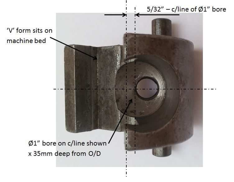

        #166719
        Marcel Jolinon
          @marceljolinon76204
          Mr Trevor Wright,
          Did you post dimensions for the carriage stop? if so whereabouts.
          As these things are about as rare as hens teeth I am making one. Currently producing drawings.
          Some dimensions would be helpful, Overall length, diameter, and the bolt size. I am planning on making the thing metric although it would appear that the bed on my metric machine is imperial. By my reckoning the V should be 3/4" having filed out a template.
          If I have got it right the picture should be my initial design done with CREO
          #166768
          Trevor Wright
            @trevorwright62541
            Marcel,
            Started to dimension the stop but the angles were too difficult to measure accurately, was waiting for someone to ask…..looks like I will have to now lol.
            Give me a couple of days to dismantle and measure.

            #166803
            Marcel Jolinon
              @marceljolinon76204
              Trevor,
              I have made a template of the lathe bed and taken dimensions from that. The measurements were taken in mm as being a metric machine I assumed that the bed dimensions would be metric. Not apparently so as my conversions bring it out at 3/4" on the slope. I am afraid that my drawing did not go to a jpg very well, the angles appear to be 90 deg and 135 deg. which would make sense from a manufacturers point of view along with 3/4". These are the key dimensions for the stop.
              The main problem areas for me are hoe wide the is the brass clamping piece, as I guess this to be critical, too narrow and it is likely to slip, and the diameter of the bolt. I was working on 5mm but the one in your photo appears to be about 5/16" (8mm) and quite coarse (Whitworth?)

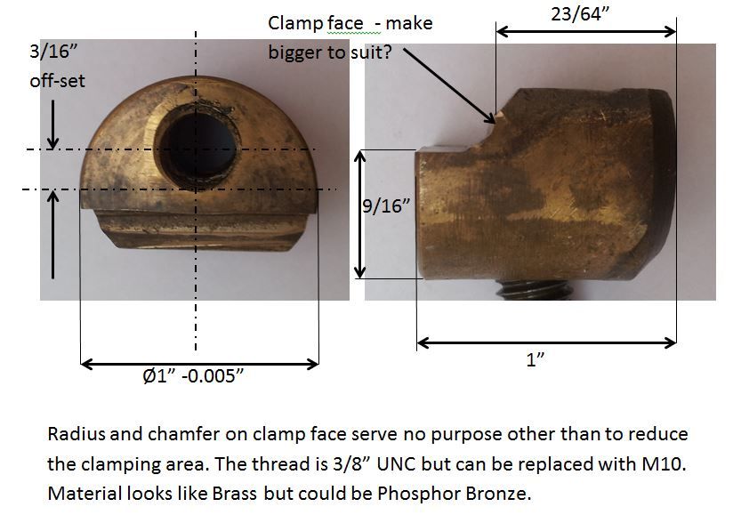

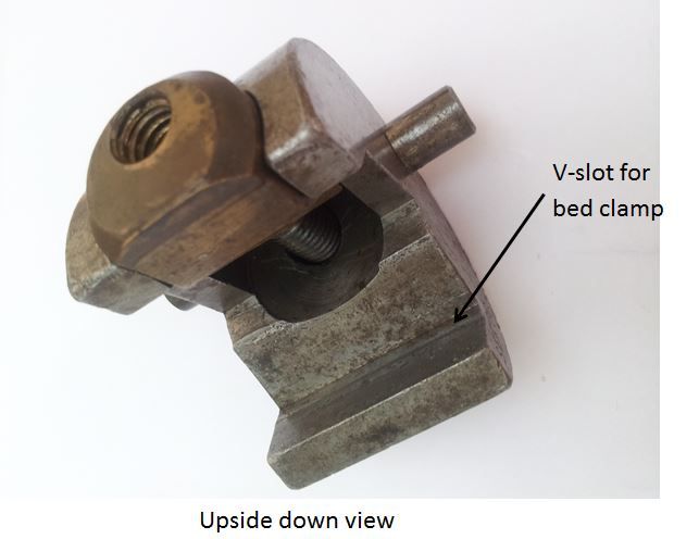

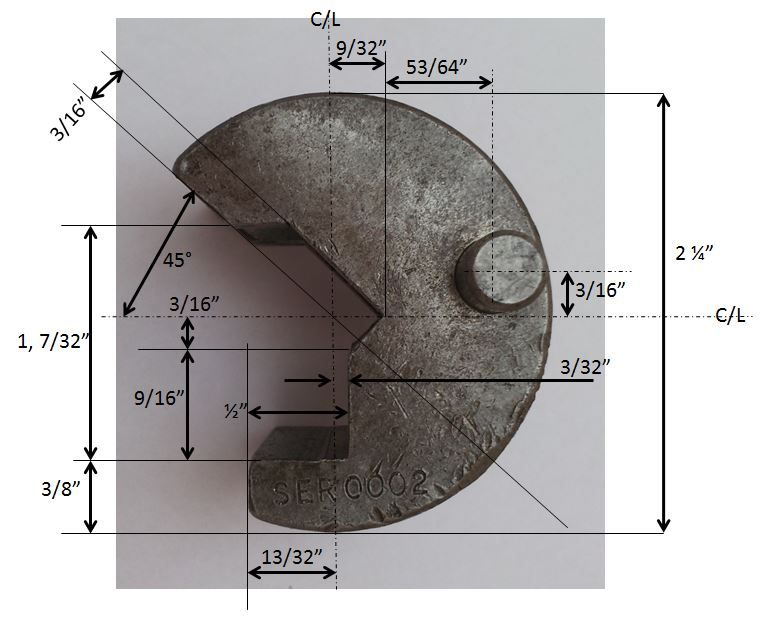

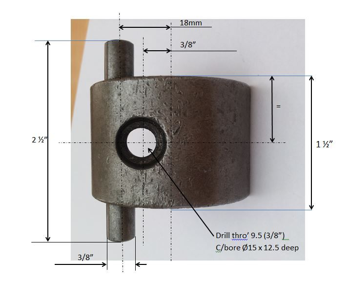

                #167025
                Trevor Wright
                  @trevorwright62541
                  Marcel,
                  Have added dimensions to photos of the Stop-block, the perspective of the pictures is confusing but the faces the dimensions are attached to are true.
                  stop - side view.jpgstop - top view.jpgstop - bore view.jpgstop - clamp block.jpg
                  Edited By Trevor Wright on 19/10/2014 16:04:43

                        #167048
                        Marcel Jolinon
                          @marceljolinon76204
                          Thank you Trevor.
                          I guessed the diameter to be about 2" I will now do some working drawings and make one from that. If all goes OK I can post the drawings. Unless there is a way to allow for others to download files.
