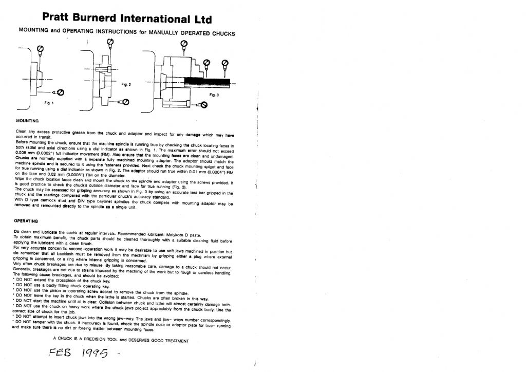

                      img018.jpgHi All,
                      I`ve uploaded the recommended fitting instructions for Pratt Burnerd three jaw chucks, in case anybody reading this thread needs them. If the image is too small to read the text, then go into my photo album for a larger image.
                      Alan
