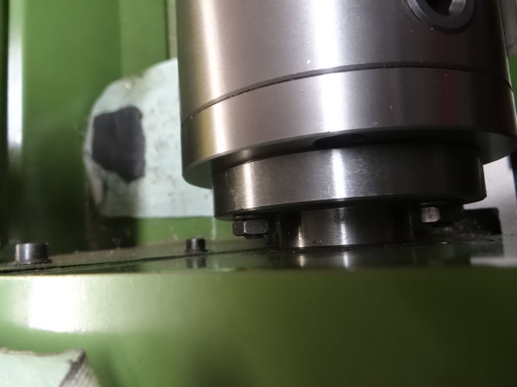

Arrrgh! OK, I am trying to cut a groove into the outside perimeter of a circular piece (end on so to speak). My other thread explained it with a diagram.
So the problem I am having, is that the workpiece isn't centring properly. In a nutshell, I have a 190mm diameter workpiece, mounted on a 180mm diameter piece of ply which is bolted to my faceplate. Somewhere along the line, something isn't centred properly, because the tool touches the perimeter in some places and is up to 2mm away in other places around the circumference.
As far as I can tell, I thought I had drilled everything in the centre. I drew the correct size circles in Illustrator and put a centre hole in. These were printed and transferred to the work piece, and used as templates. Everything fitted perfectly. Then, when mounted on the lathe spindle, it is, as explained above, spinning off centre.
And I don't know what to do to get it right. It is driving me mad! Any of you chaps any ideas of how to get the workpiece spinning in a perfect motion?
