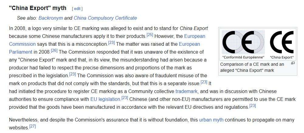

      Hi all, can’t believe  haven’t noticed before but I was giving my Warco 290V lathe a bit of a brush up and noticed that the CE mark on the nameplate was in fact the Chinese version not the EU one, I spent quite a bit of time a few years ago (and still am) doing documentation for EU Directives and Regulations so well aware that the EU CE symbol has precise proportions, the obvious one is the ‘E’ , (formed like a ‘C’ with a bar in the middle) the bar is inset slightly whereas the Chinese one isn’t.

        #839932
          Or is it just a Myth?
          myth
          #839933
          Robert Atkinson 2
            @robertatkinson2
            Incorrect and therefore invald CE marks are not a myth. The “China Export” mark is a myth.

                  The webpage Michael linked to also covers the incorrect application of CE marks to items that don’t need it or should not have it. Components (with a few exceptions like parts of safety interlock sysems)  should NOT be CE marked. This includes VFD’s. Unfortunatly even some of the better manufacturers do this due to market pressures. You can’t CE mark a component because there are too many variables in it’s application. There are standars for VFDs a good example is EN 61800-5-1. However this only covers electrical, thermal and energy safety. It also considers different levels of integration. What people on here talk about as a VFD or “iverter” is considered  Basic Drive Module (BDM). A BDM can hve a certificate of conformity to EN 61800-5-1 but should not be CE marked because it is not a finished product. Using  EN 61800-5-1compliant VFD will of course give the user confidence that the finished product can compliy and helps reduce the amount of compliance work they have to do. Even better is the US version UL 61800-5-1 becuase while EN 61800-5-1 is “self assessed” the UL version requires independent assesment by a Underwriters Laboratory approved entity.
                  Even if using a 61800-5 compliant VFD you still have to ensure the whole syste it is in is compliant to all relevant directivves (LVD EMC Machinery).
