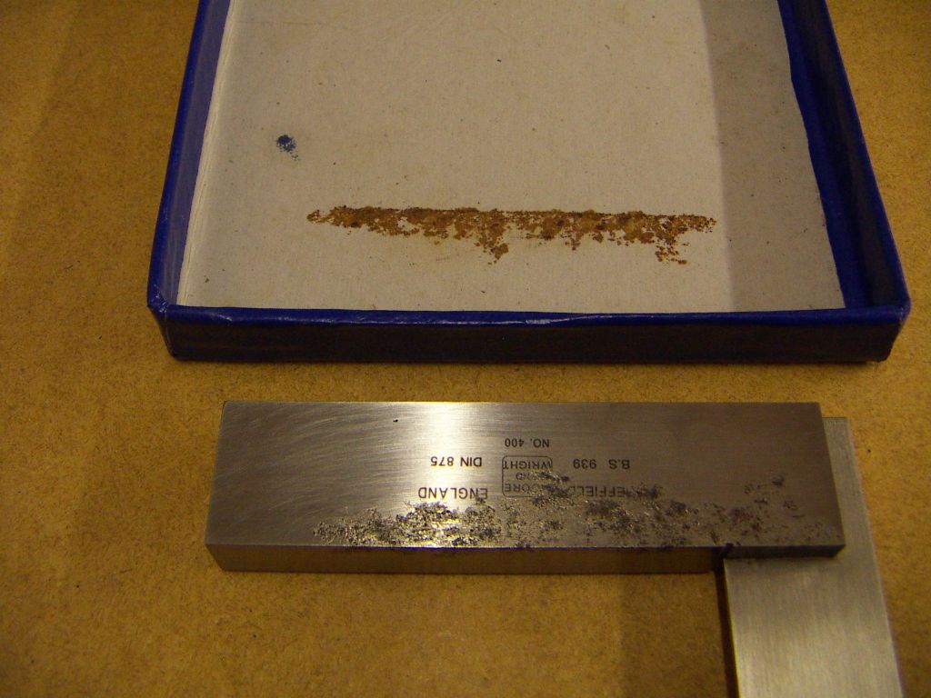

      About fourteen months ago I purchased a new 6 inch M&W square to replace the thirty year old, worn out one that hangs over the bench. For a reason now forgotten I did not do the exchange, but put it back in the box and put the box on the shelf. In haste I failed to fully enclose the square inside the brown paper liner. The photo shows deep pitting, the result of letting the cardboard lid touch the metal and was taken after I had cleaned off the thick layer of rust which could not of been worse even if I had left the item at the seaside. The box was in a dry garage and I routinely keep items in their original packaging without a problem. I note that the brown liner paper was not the usual oiled type but has a plastic layer fused to the outside. If anyone out there has M&W items in similar packaging they might wish to review the arrangement.pict0149.jpg

          That's a shame, Phil, though, from the look of it, it probably won't affect its accuracy.

                14 months means at least one whole winter. As we don’t know the location of this ‘dry garage’ and how it is kept dry, we cannot really blame the manufacturer’s packaging. Any similar packaging by any other manufacturer would fare no better. The original packing around the item was clearly perfectly adequate?
                100% humidity and freezing conditions are bound to ‘dampen’ cardboard packaging, with resultant condensation onto steel in freezing temperatures.
                I would say the title should be amended to ‘Storage conditions – a cautionary tale’ as, presently, it is possibly libelling the manufacturer.

                  Bad luck! I think M&W's packaging is mostly innocent though.
                  The filmed anti-corrosion paper keeps water out, whilst the waxy side is in contact with the metal. The cardboard box reduces the amount of moist air that can get to the metal. All good, but the wrapping has to be in place and the cardboard box sealed: sometimes new tools are taped shut or come in plastic.
                  The damage was done by condensation, which occurs even in dry garages. UK air is often wet, and we make it worse in workshops by breathing. Condensation occurs whenever warm moist air comes into contact with cold metal. It's common because workshop temperatures rise naturally in the day and fall overnight, whenever work is done, and especially if the workshop is heated to work in it.
                  I think what happened to the square is that air was able to flow in and out of the box, where moisture condensed on the exposed metal and soaked into the the cardboard. Ironically the metal, box and temperature changes acted as a pump, capturing water rather than keeping out. Any salts in the cardboard would increase rusting, so the square was stored in a damp box, probably slightly acid.
                  General cures for condensation:
                  • Remove water. Fix leaks, dehumidify, ventilate, store in sealed boxes etc.
                  • Reduce temperature swings. Ideally everything in the workshop should stay at the same temperature whatever happens. Cool is better than hot, because the speed of a chemical reaction like rusting rises with temperature.
                  Hard to do, and potentially expensive, so palliatives:
                  • Maintenance waterproofing – oil, waxes, paint, galvanising, anti-corrosion paper, tools in cupboards, boxes and plastic bags etc etc. Note it's hard to maintain a completely effective air seal .
                  • Water reduction – no naked flames, drying washing, open water tanks, or damp floors and walls, blowing moist air out with a fan, dehumidifier, silica-gel etc,
                  • Reduce temperature swings with insulation, ideally the whole workshop, but blanketing helps too. Make sure blankets don't trap water! Attaching a small electric black heater to a machine tool will reduce condensation by keeping the metal closer to air temperature.
                  Condensation is difficult to deal with because the only guaranteed answer is an expensive environmental control system – 24×7 air-conditioning with temperature control. Lesser measures depend on local circumstances, which is why what I do successfully in my workshop may not work for you and vice versa.
                  Before reusing the M&W box, make sure it's dried out!

                    There must be some sort of vapour being released from the cardboard – I'd contact the manufacturer with your photos.

                                      Exactly. Cardboard and ordinary paper contain acids and nasties like formaldehyde that eat into their contents.
                                      That's why museum curators keep valuable exhibits and photographs etc in special acid-free paper and plastic wrappers and containers.
                                      The corrosion in the OP may have little or nothing to do with atmospheric moisture and more to do with acidic cardboard. Quite possibly though, the atmospheric moisture aided the acidic cardboard in doing a job on the metal it rested on.

                                          Hi, Phil S has said that he didn't store it back wrapped in the protective brown paper liner, so the manufacturer or the seller is not at fault, if he received it in that condition it would be a different matter. Neither the manufacturer or the seller has any control how one stores or uses the tools we buy. I had the same thing happen with the little square shown below, it was covered with oil in a vacuum packed polythene bag in a carboard box when I bought it. I took it out of the bag, clean all the oil off to use and then just put it back into the cardboard box and stored it in one of my tool chest draws that I have in my small workplace indoors. Not really thinking about it much, but then one day when I went to use it, I found rust on the stock section where it had been it contact with both the box and the lid, but it was not very serious and cleaned it off with a piece of very fine Scotch-Brite but it has left a stain, but doesn't effect it's use. The stock is 55mm long and the blade is 78mm long.
