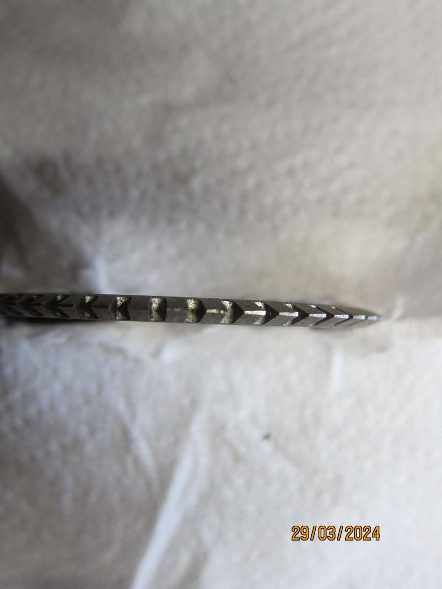

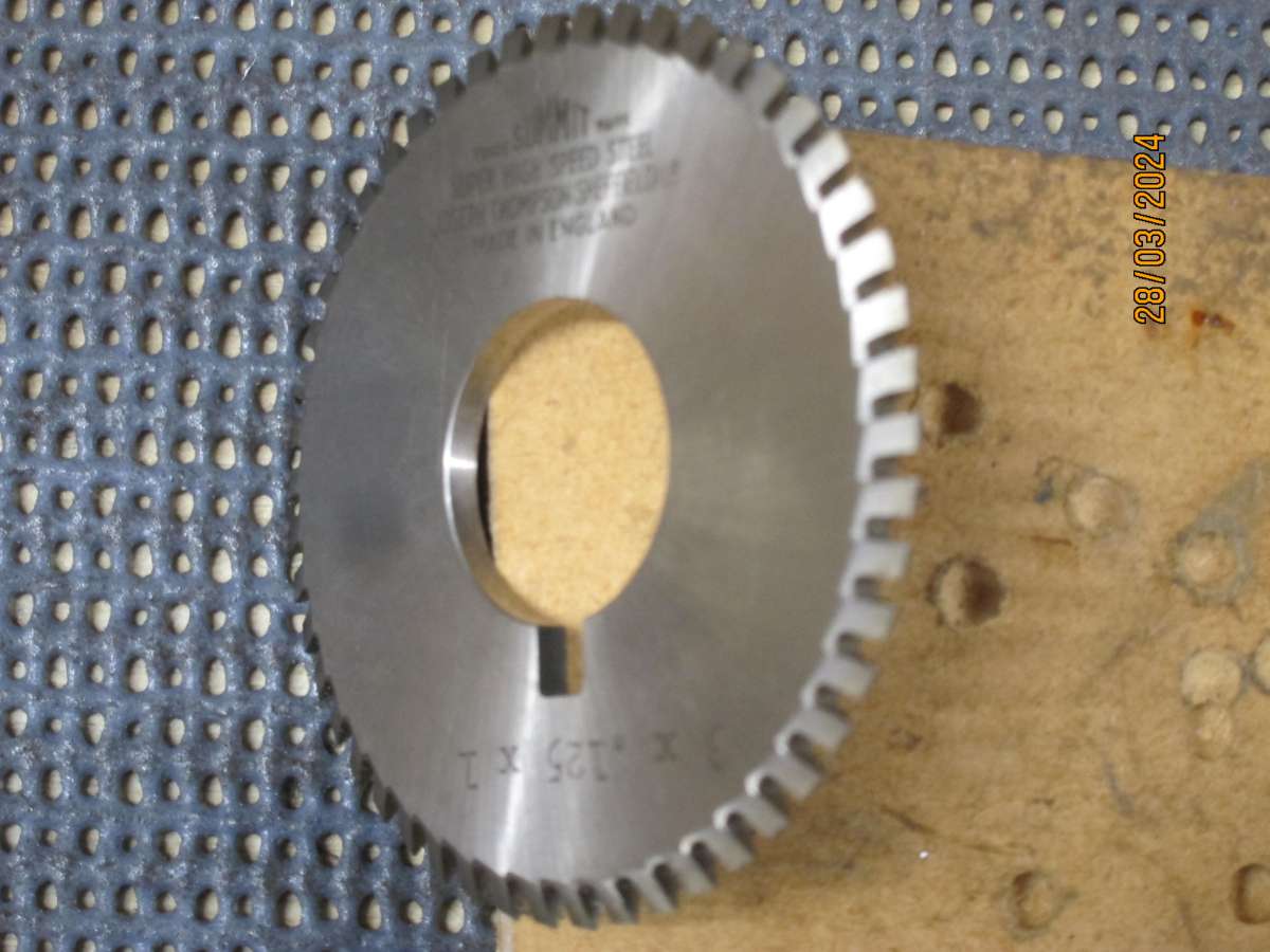

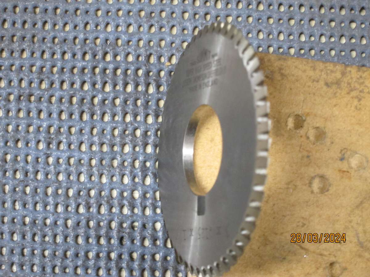

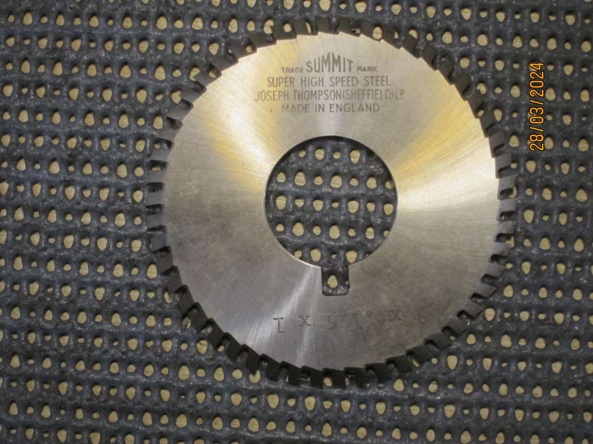

      I have discovered this milling cutter amongst my collection of slitting saws and the like which I have never come across before or seen any reference to and I am just wondering what type of cutter it is and what it might be used for.  I am sure someone will provide the answer.

        I’ve got some similar cutters; used for cutting acute V-shaped grooves. I used one of mine for grooving the rims for the rear wheels on my traction engines to make it look like they were made from two rings held together by the strakes, as per full size. No idea what the cutters would have been used for industrially.

          If you want to describe it, it’s a ‘single angle’ milling cutter.

            Ratchet wheel cutter?

              A photo end on might help

                Roller chain gear teeth.

                  End view of the cutterIMG_0723

                    Looks like a Rack cutter to me
                    #722835
                    John Haine
                      @johnhaine32865
                      I’d call that an edge view but I agree with Michael, looks like a rack cutter as the teeth have straight sides and are symmetrical w.r.t. the diametral plane.

                        If it was a rack cutter I’d expect the cutter to have information on the side relating to the DP/Module as a minimum?

                            Its info is given as “3 x.125 x 1” A regular slitting saw or side and face cutter would just have the width so what is the 1 indicating?
                            edit DOH it’s the hole size of course.
                            I guess just general purpose grooves – like for mass producing clockmaker’s finger plates, count wheels for synchronome slaves, detent wheels on rotary encoders.

                              If the OP would measure the angle of the vee that the cutter would produce, it would allow this thread to explore an entirely new continent of speculation.

                                I’d guess some sort of shaving/finishing cutter, judging by the number of teeth and reactively small gullet for chip clearance.  As I say, just a guess.  But as to what for, no idea I’m afraid.

                                  We used cutters like these to put a vee groove in nail holding jaws on our nailing machines. I subsequently used one to make some scale chequer plate, the shallow grooves looked good in a diamond pattern.

                                    Vice-jaw grooves… also oil-retaining grooves on large, flat sliding surfaces?
