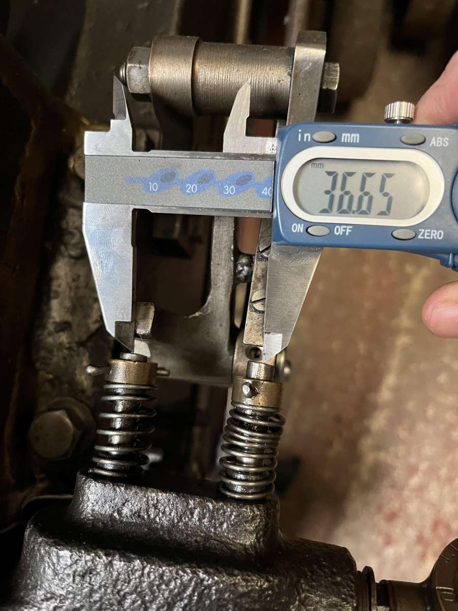

              I find it is far better when reverse engineering an old item to work in what it was originally made to. I’ve had it a few times when doing CAD work for people, they measure as best they can an old part in metric and you end up with a bunch of odd figures. But if you convert those figure sto imperial you can see that they are close to fractional imperial sizes which is no doubt what the actual measurements were originally.
              387333762_724106065773847_3532287710125377877_n
              Take a picture like this, do you assume it is 36.65mm and redraw to that dimension. Or do you convert it back to imperial at 1.443″ and then use a bit of common sense and apply the likely imperial fraction of 1 7/16″. Had that calliper been reading in inches or even fractions the job of deciding on what the original was would be even quicker.
              With 30 odd measuurements of that casting there would have been a lot of errors if I had been lazy and just assumed the metric were correct, many were taken from cast surfaces with draft to complicate issues. Like this, where do you measure and can a rough surface be trusted? I went with  1 1/4″ at the end.

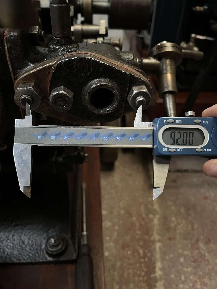

                Was going to add this one but sofware will probably not show it.
                387334390_1023389098780333_2605950469909651435_n
                Do you go with 92mm or 3 5/8″. Had the person taking the measurements been doing it in imperial I’m sure they would have moved the calliper to the correct imperial 3.625″ but you can’t trust these Europeans to know about imperial😉
                Might not be Engineering but it is the practical approach and will bring a 130yr old engine back to life.

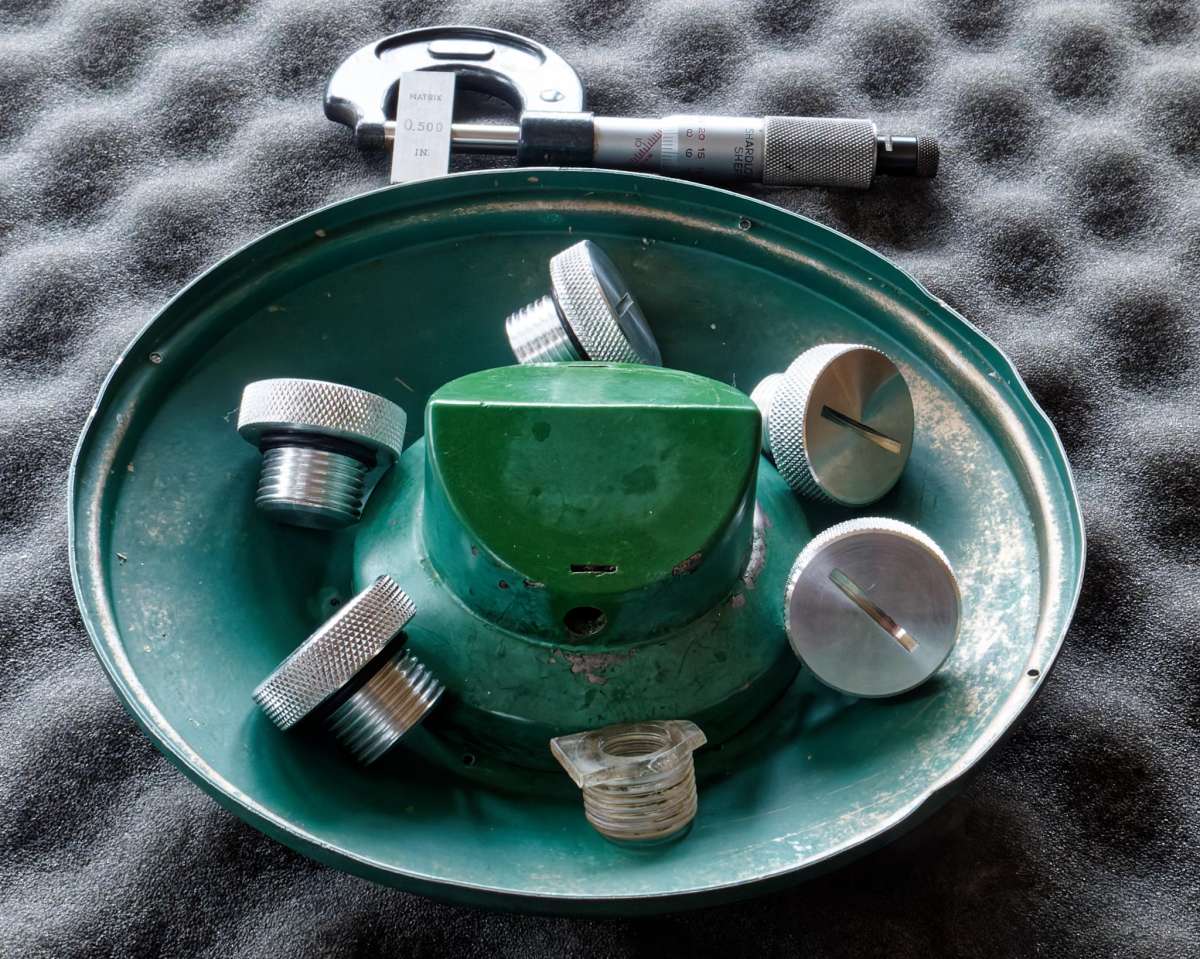

                  Yesterday I made some thumbscrews for a neighbour.
                  These are for attaching trays to the bottom of bird feeders. A quick read of several catalogues seemed to imply ½” BSP as the standard thread fitting for them, so I asked Steve to drop off some samples to measure, as I have a set of BSP taps & dies.
                  Well, the tap was a tad too large for the hole, and the broken plastic screw was a rattling fit in the die.
                  On measuring it, the plastic original screw was oval and about 30 thou under BSP, but seemed to be 14tpi.
                  On the other hand, it was close to 20mm 1.75 pitch. The thread under the diecast alloy feeder(s) was badly formed and hard to measure, as well as not being cut quite deep enough, regardless the thread pitch.
                  14tpi seemed a better fit than 1.75mm, both externally and internally, but they are almost identical when you hold up thread gauges to the light, so either would probably do OK.
                  Should I have made the screws 20mmx14tpi, or 1.75mm? or 0.780″ x 14tpi, or 1.75mm
                  I was screwcutting them regardless, as it wasn’t worth buying a one off die, and even a 20mm tap would have bottomed out, so I’d need one of those as well to suit the die cut thread.
                  All my lathes are imperial leadscrew, so I went for 14tpi x .780″ Second operation for the slot, to save damaging the thread, was in a 5C collet 25/32″ was the best fit, rather than 20mm.
                  i.e. picked the units to suit the machinery and the job in hand.
