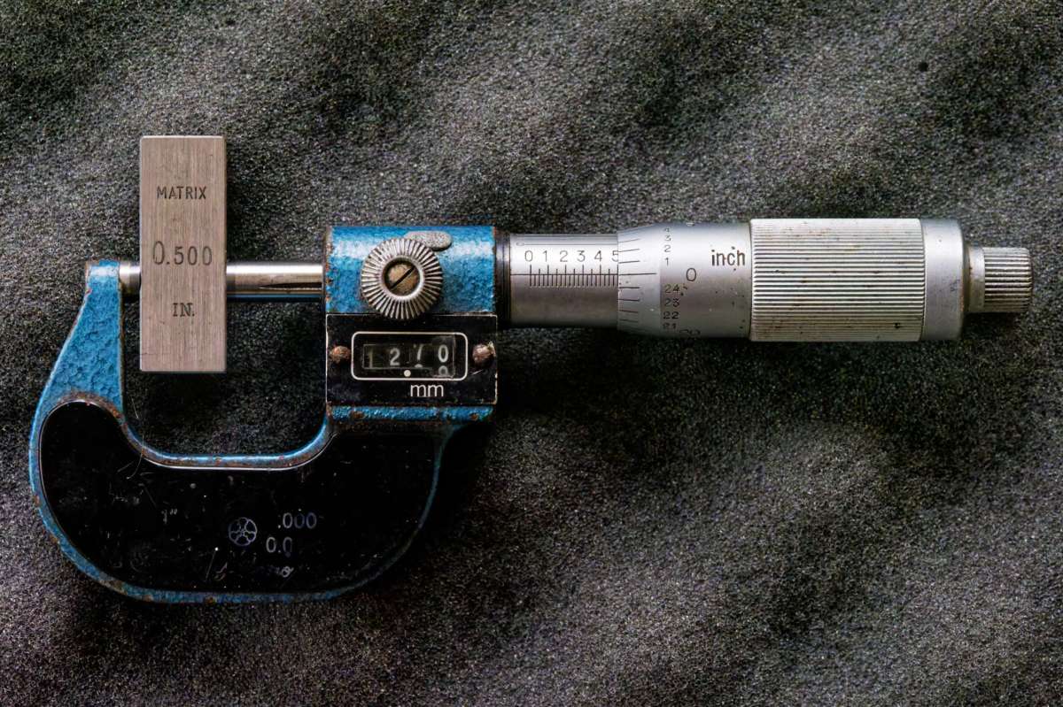

                                      Purely out of interest, I’m not suggesting Oliver seeks out either of these instruments, a couple of micrometers for those who desire metric and imperial on the same one.
                                      Digital electronics have revolutionised the concept.
                                      First is a rather grubby Mitutoyo Metrinch.
                                      This has an imperial thimble marked to tenths, but a metric numeric display.
                                      I do use it if I’m making something to metric dimensions on my imperial Myford, but mainly as a double check of my own maths.
                                      As well as imperial-metric, they also come as metric-imperial, as well as all imperial or all metric.
                                      The tenths vernier looks off slightly, but it’s parallax error in the photo; it’s pretty much spot on.

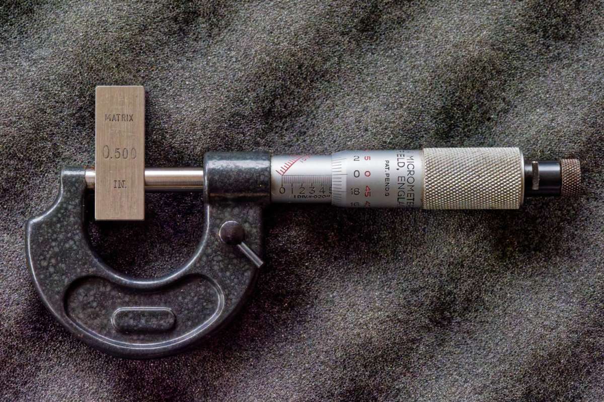

                                      Then we have the slightly weird Shardlow Anglometric.
                                      As far as I know, these only worth this way around; no idea what sizes were made, but I have 0-1″ & 1-2″.
                                      The first thing to spot, is the spindle thread isn’t 40tpi, and needs 5 full turns rather than 4 to complete 1/10″; that had me fooled when I first used it.
                                      I’m assuming this is to allow room for the scrolling red scale for metric use.
                                      Again, slight parallax error on the thimble vernier.
                                      P2100070_DxO-Facebook-s

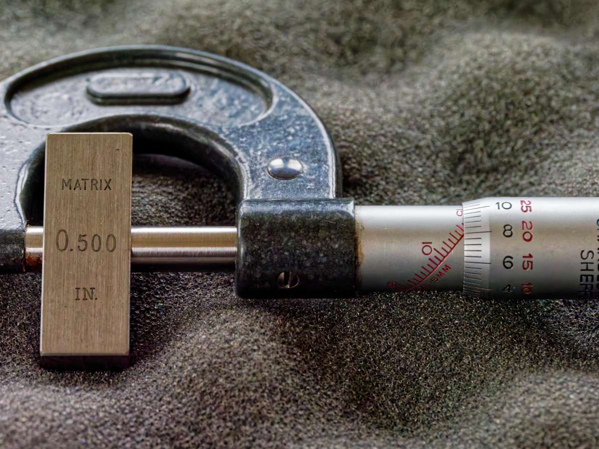

                                      Turning it over gets more interesting; you really do need to think about where you put the decimal point in your additions.
                                      For metric, use the red scale(s).
                                      P2100072_DxO-Facebook-s
                                      We have 12.5mm + 0.20 on the red thimble scale to give the final 12.7mm
                                      I think I understand why they weren’t that popular, and fell out of production.
