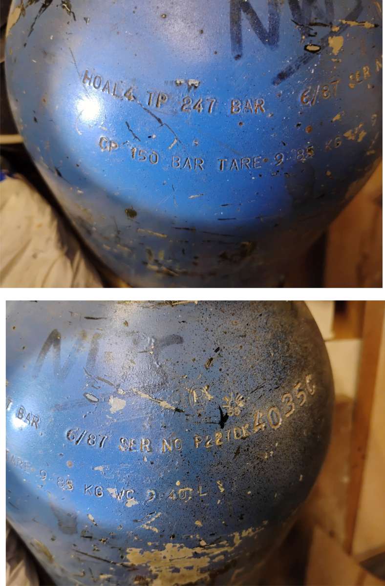

      Some years ago I purchased a large (for me) gas cylinder filled with Argon from Nuneaton Welding Supplies (NWS). Since I only do welding for very infrequent Remap jobs, the gas lasts a very long time. Over the weekend the gas ran out and I need to refill the cylinder, but NWS say they don’t recognise the cylinder. Does anyone know where I can get a refill? I live in Leamington Spa.
      The data stamped on the cylinder is…
      HOAL4 TP 247 BAR 6/87 SER NO P227OK 4035C
      CP 150 BAR TARE 9 85 KG WC D 40L

        Judging by this web page ,what you have is an old Scuba cylinder made by Luxfer from 6351 alloy. These are considered risky and need testing and visually inspecting see HSE bulletin here. I suspect you will find it hard to get it refilled – and you may not want to!!

              The date of 6/ 87 and no sign of a new test date would stop this being refilled ! It’s way out of test.The days of cheap gas from various places is gone. BOC do half sized bottles and charge rental per month ALL bottles are coded now and questions will be asked if the return bottle has a different code to the one you were issued with. Another system you pay a hefty deposit on the bottle and the gas is not cheap. Good luck. Noel.

                The issue with AA6351 cylinders is not the usual fatigue failure but  SUSTAINED load cracking in the neck area. So if yours has been sitting for years (probably decades) under pressure it could have serious problems.
                See https://www.sciencedirect.com/science/article/pii/S026412752500958X
                Note that the Luxfer notice is over 25 years old so presumably it has not had a competent inspection in a least that long. It may not have had the same pressure as a SCUBA cylinder but who knows.
                Personally I’d open the valve and cut the neck off the cylinder or otherwise render it unusable.

                                  Thanks for all the responses. Peter was right about the 6351 alloy.
                                  I found a supplier of rent-free welding gas in Rugby, but after driving there it turned out to be a waste of time – they only dealt with the very large cylinders from another company.
                                  As it happens, I managed to find the original agreement invoice for the bottle from NWS – it was dated 1998! It appears that NWS are now agents for HobbyWeld. I took the invoice and bottle to them yesterday and met a really nice and helpful woman who went out of her way to help me and I ended up with a HobbyWeld cylinder and a new agreement at a very competitive and acceptable price.
