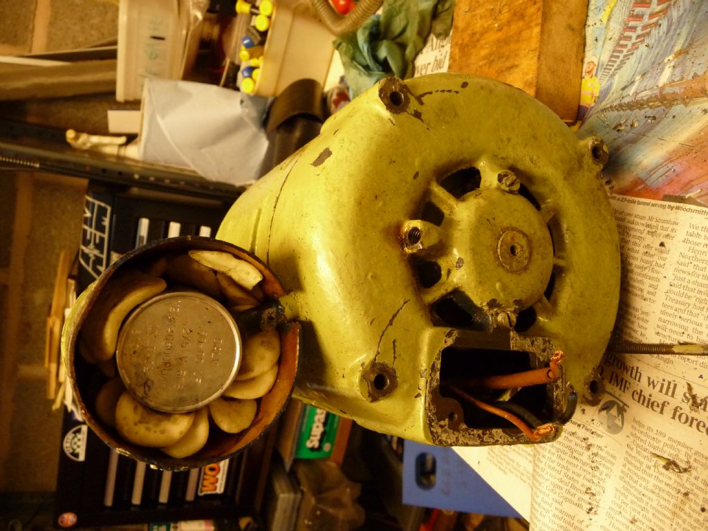

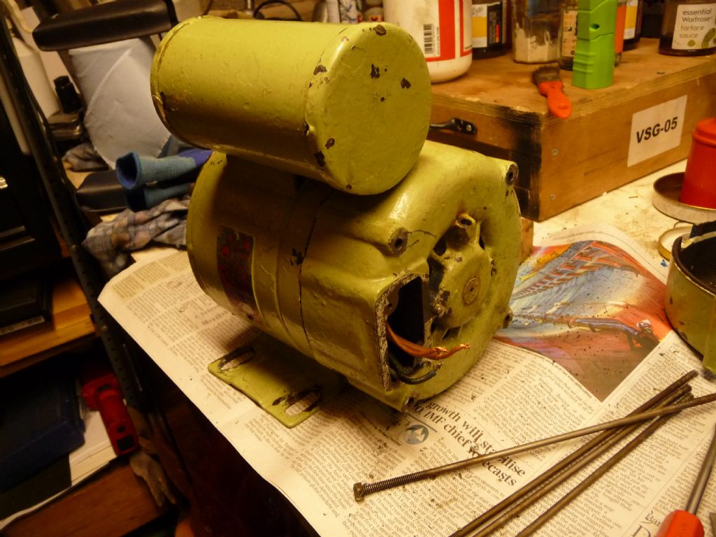

      I'm stripping down the motor off my Myford Super 7. It's a Brook "Cub" capacitor start 1/3 hp. Probably early 1960's. I've removed the front end plate but cannot see any way of removing the rear one as the cable from the capacitor (which is welded the the case) goes through a hole in it – thus stopping it from moving.
      I figured the armature must have to come out through the front of the case thus giving access to the wiring of the capacitor at the other end.
      But.. it will not budge – I don't want to hit it to hard or put it in the press as it seems fairly solid and I don't want to destroy anything if this is the wrong approach.
      Advice please.

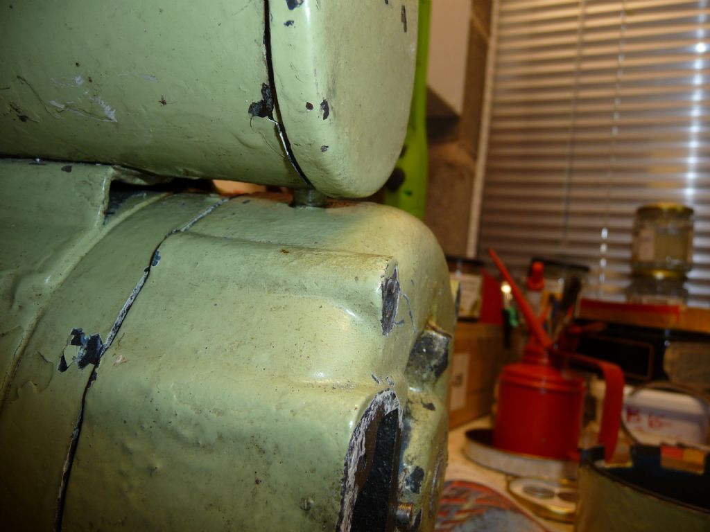

          I think the capacitor case has a removable end cap which can be tapped or prised off to reveal the connections at the capacitor end, can you take a pic square on to the non drive end plate?

            Phil – this is the nearest I have. I did think maybe the back end came off the capacitor and gave it a couple of gentle taps. Nothing moved so I didn't progress. It doesn't look like it's spot welded as the front cap appears top be.
            Should I give it a bit of welly??
            Cheers,
            Phil.

              OK, so I've given the capacitor end cap a good sharp "tap" with a hammer & drift… and it's come off to reveal the cable running through a slot – hence the end plate of the motor can now be moved. Funny packing, pieces of polystyrene, around the capacitor. Must have been put in when the lathe was reconditioned – 1970/80's?

                  remove the two screws either side of the shaft, this will release the bearing plate and allow the rotor to be withdrawn from the other end. then tap the bell housing/ stator joint with a blunt screwdriver or chisel, and remove the bell housing and capacitor as one unit, sliding the capacitor out of its housing, beware, that packing looks a lot like the contents of the capacitor that have oozed out due to internal short in the capacitor!, may not be, but it pays to be cautious! wear gloves!
