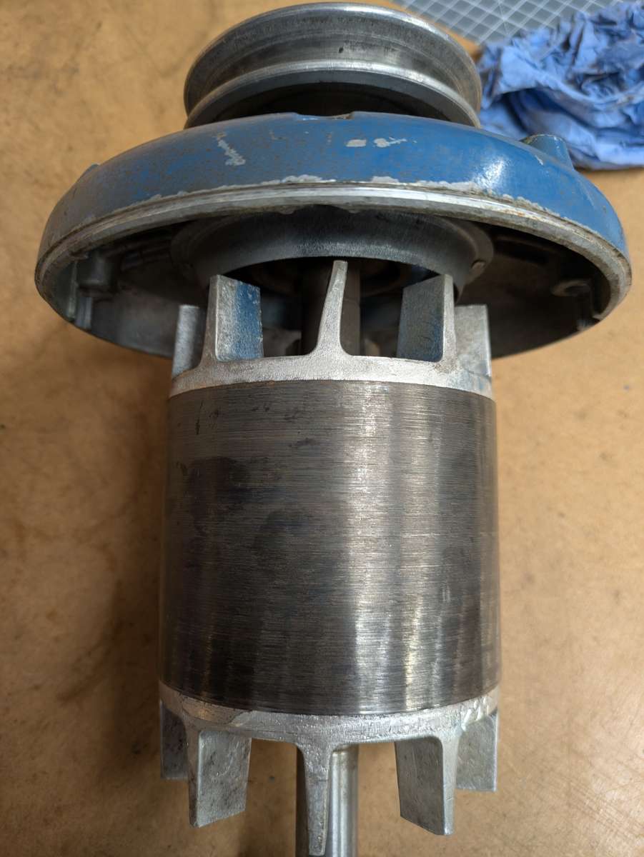

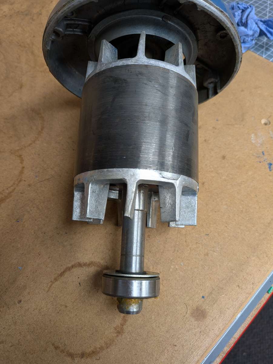

      Hello guys
      I have been fitting a VFD to a new (to me) Boxford lathe and I am almost complete. I tested the motor and it all runs fine. BUT, I noticed a few faint noises coming from the motor and it just doesn’t seem to run as smoothly as I expected. It’s not terrible by any means but since the bearings are so cheap I have decided to replace them. A good clean inside won’t harm it either!
      Anyway, I opened up the motor to fit the bearings and noticed that a couple of the fins are slightly bent. I am not sure what to do about this? Do I try straighten them out and risk snapping them? Or should I leave them well alone? Does it even matter?
      Just like to get some opinions. Thanks.PXL_20260203_143808318PXL_20260203_143759093

        Why or how were they bent ? Somebody dropped the rotor ? I would leave them be ! If fitting new bearings get XXXX C3 type for electric motors.   Noel.

          The fins appear to be part of a casting.  Leave them as they are

            I think someone may have had the motor apart before. (Not me). The bearings were the caged unsealed type.

              Maybe someone poked something into the fins to enable the pulley nut to be tightened/loosened?

                Did it turn smoothly by hand (or do the bearings spin freely, now?  If any roughness is felt, it is far more likely to be bearing wear.  They are likely worn. Particularly the one at the drive end.
                Personally, I would likely bend the fins back to straight with careful application of force with a small adjustable spanner – but not to the point of excessive force, if they resist moderate persuasion.  They don’t appear to be bent at the root.

                    I would leave the fins alone, they are a crude fan to help keep the rotor cool.
                    Can’t imagine Brook would have bent one to balance rotor, it’s conceivable that the bent fin may create a little imbalance but unlikely I would have thought. Incidentally I am not an electric motor expert, just speak with over 60 years experience in the industrial fan industry with motors up to 500kw.

                      OK, so curiosity got the better of me and I tried to tweak the fins back straight using an adjustable spanner. I was absolutely gob smacked at just how soft the aluminium casting is! The fins bent back remarkably easily with the only the lightest of pressure. They are now much better.
                      Got the bearings off easily, they were both open cage type. Made by nachi japan. They both felt OK with just a bit of roughness and wobble to the rear one. I replaced them with Timken 6302 ZZ shielded type. The bearing seats were much looser than I would have liked so I used a bit of bearing retainer.
                      All back together now and it seems to have helped, the weird noises are gone and it seems more smooth. I think it vibrates less too. So all good.
