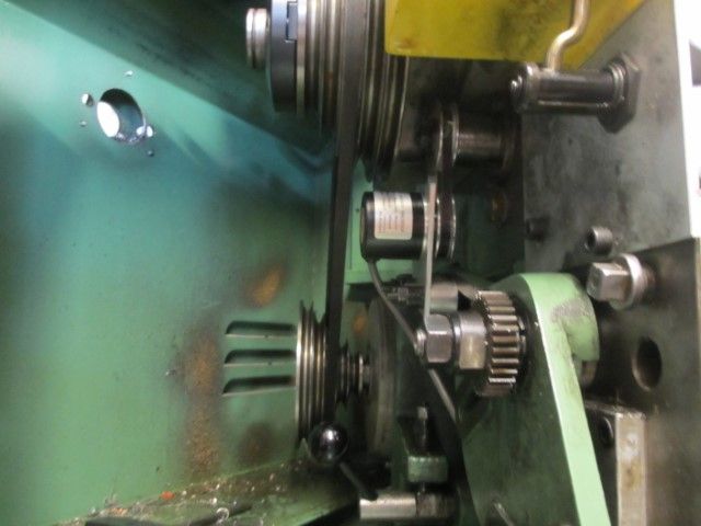

      I'm fitting ELS to my Myford 254S, and so I need a spindle encoder. The obvious place to mount a tooth belt is the shaft which drives the change-wheels, which is the standard Myford arrangement. Rather than having to make a slotting attachment to machine keyway, does anyone have a change-wheel with missing teeth which they would be prepared to part with? I could then turn it down and loctite the tooth belt pulley on.
      I know I could do it with a boring tool sideways on by racking the saddle back and to, but I'm lazy!

          Could you use a Taper-Loc bush if feasible to machine the pulley to suit? I think they are made down to that sort of diameter.

              File a slot with a square file.

                Actually, just bore a blank oversize, make a brass top hat bush slotted to suit the key (easy job) and fit it in place using retainer.
                I did this to fix a damaged changewheel and the repair lasted years, so for an unloaded encoder…

                  Drill a well placed hole and open it out & square it up with a file – hey presto – keyway!

                        My slotter is presently set up to cut the key ways in some myford changewheels I made, so if you would like to send me the blank I'll cut the keyway in it and post it back.

                          Rather than turing a gear down, use the slotted spacer (A2604) that is used in the gear train.

                              I've taken up Simon's very kind offer, but thanks for all the other suggestions

                                Thanks to Simon's efforts the encoder drive pulley has now been bored and keywayed. Attached photo shows it in position, the encoder mounting bracket is bolted to the gear-change quadrant. The belt is made of paper, just to get the right length, a real one is on its way! The paper one but I don't think it would last very long.
