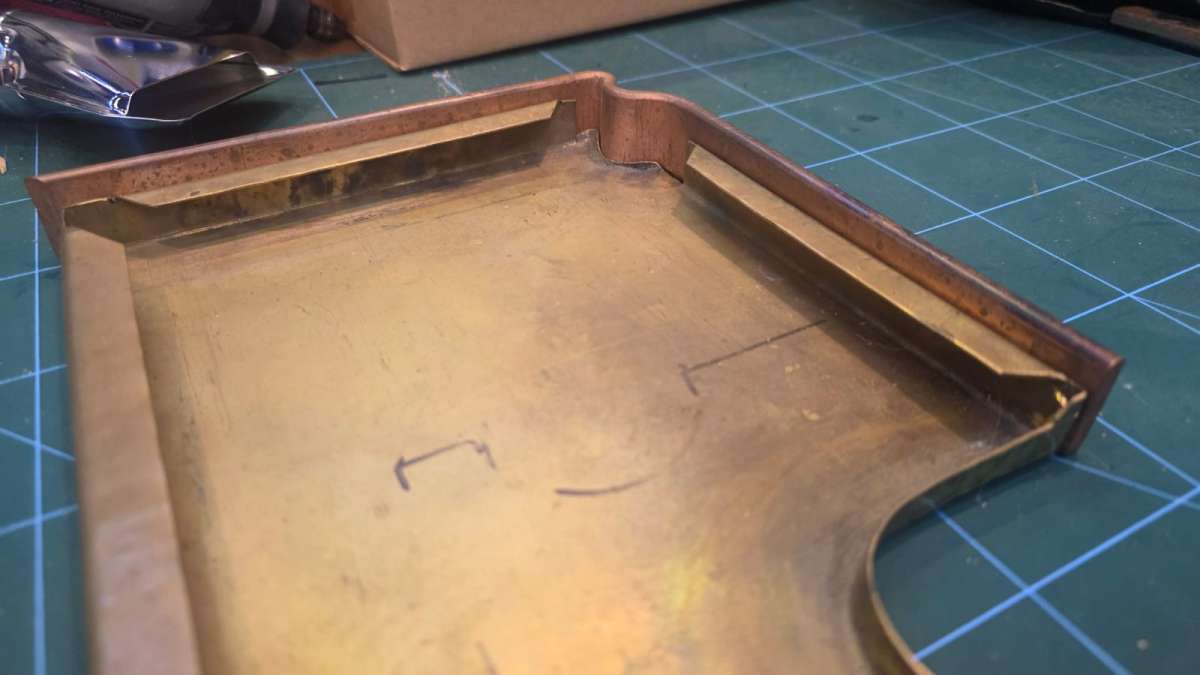

      Hello,
      I have a job that I’m hoping someone can help with or perhaps direct me to someone who can?

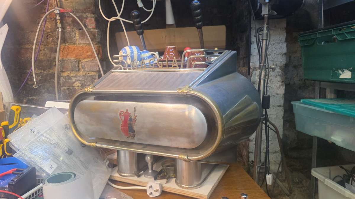

      This is a 1955 Gaggia Internazionale espresso machine which I am restoring.

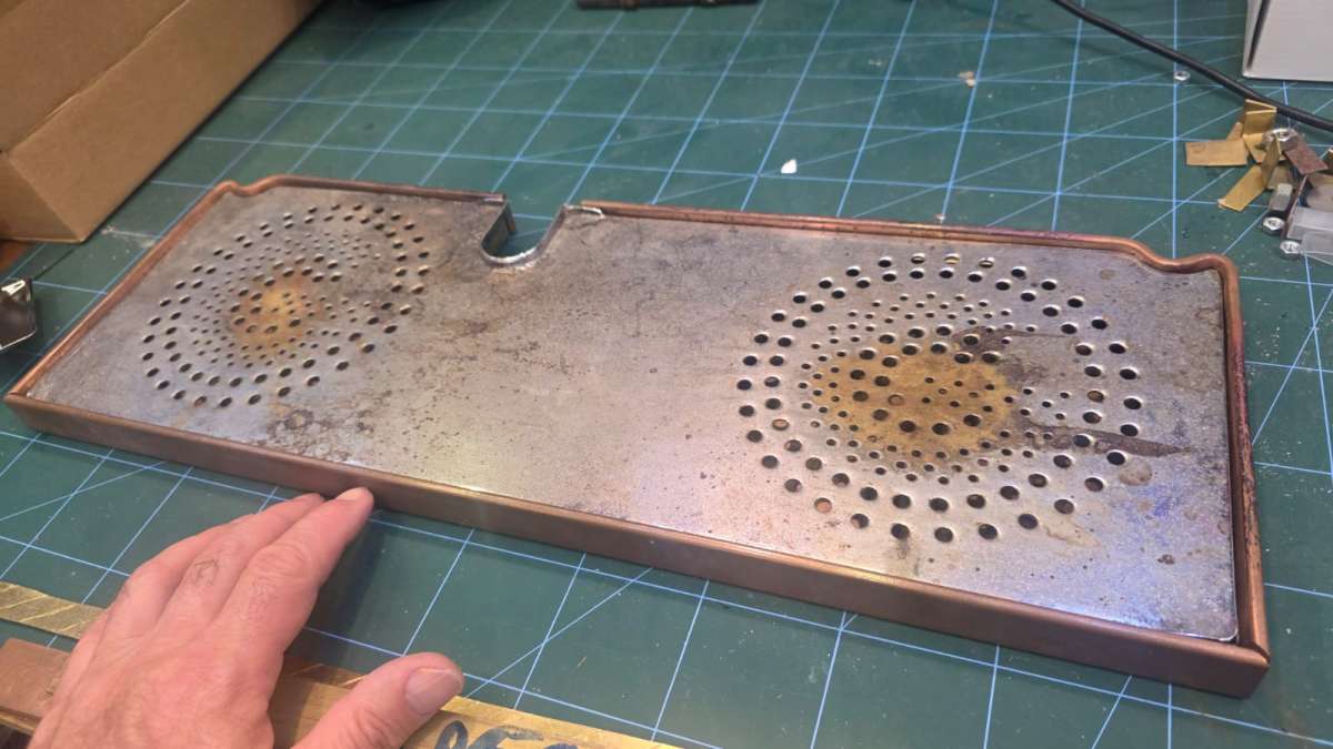

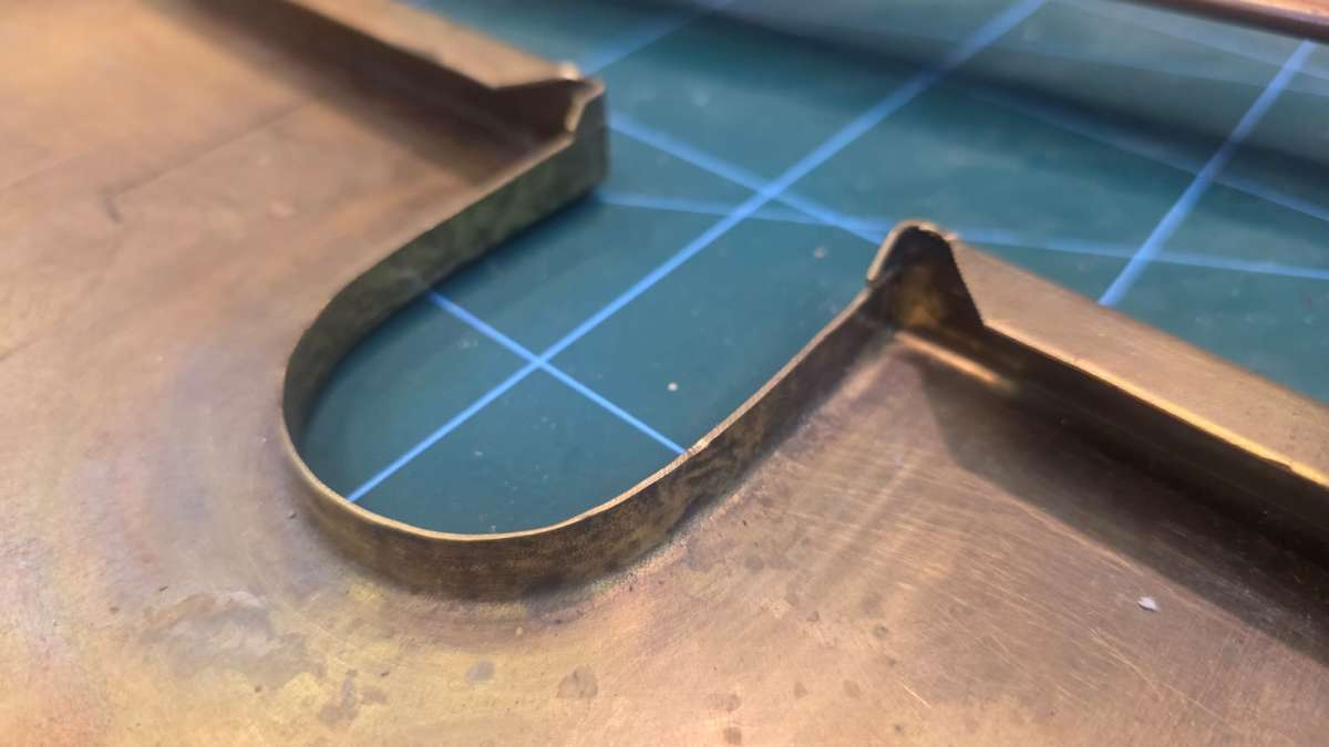

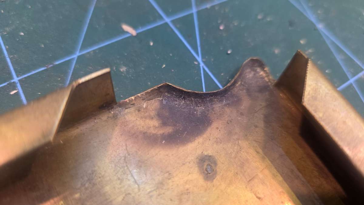

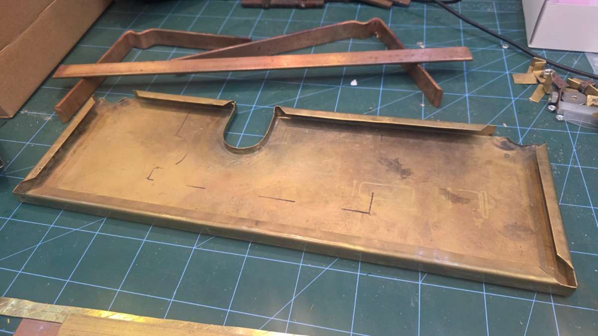

      At the rear of the machine should be a cup tray which I am part way through fabricating a replacement.
      The forming has been done, but it’s the brazing together that I need some assistance with.
      I have sievert torches and did the anealing on the 1×1/4 copper bar below, but I am nervous about doing the actual brazing job as it’s bigger than anything I have done before. The risk of getting it wrong would be a bit tragic given the effort that’s gone into it.

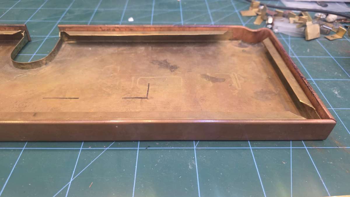

      Essentially the copper bars need to be positioned flush with the bottom of the brass tray as shown and brazed together. You would need to prevent any shifting of the parts (tray especially) during the process. I don’t have a brazing hearth, hence my hesitation.
      WhatsApp Image 2025-08-19 at 20.02.23
      Here are the peices: the copper lengths are 1″ x 1/4″, and the brass tray is 1mm.
      The photos show how they would fit together. The chrome cup tray would sit in place once complete.

          Could you perhaps write something small on why it needs brazing at all, as opposed to soft soldering.
          To my untrained eye, something that cups rest on will never get hot enough to worry solder.
          #818075
          noel shelley
            @noelshelley55608
            Why can it NOT be soft soldered ? The material is quite thin so it should be easy enough to do with a sievert  torch and silver solder or even brazing (brass ). It could also be TIGed up.

              Hi Derek, I agree soft soldier sounds a good way to go. You could also consider holding the brass bars in place by drilling and tapping them say M2 or 8ba and fixing them with brass countersunk screws. If you tin the brass once it is screwed in place with some flux it can be heated and soldered as well.

                  Hi, I think your biggest problem with brazing, is you might easily melt the brass before you get the copper hot enough, so soft soldering would be safer. You might be able to silver solder it with the lowest melting point rods, but you could braze the corners of the copper before fitting it to the tray.

                            In my opinion it’s a job for soft solder, as the heat required for any brazing or silver soldering is going to warp/distort the brass tray.

                                      Whether you use soft or hard (i.e. silver) solder, the brass corner folds will need to be opened up first and prepped (i.e. cleaned, fluxed and re-closed) to ensure the solder flows well into the joints.
                                      If you opt for silver solder, bear in mind that whilst annealing the folded sheet on its own with a propane torch isn’t ever likely to risk melting the brass, silver soldering a 1/4” thick copper band to it will require you to play the torch flame very judiciously so as to heat the thick copper sufficiently whilst ensuring the thin brass sheet doesn’t overheat. It’s not undoable, but it will need care.
                                      Given that you’ve already departed from the original tray construction method by having a separate copper band around the outside, would you consider soldering just the folds in the brass and the corners of the copper, and then connecting the tray to the copper band by tapping blind holes (say M2.5 or M3) in the copper from the inside and joining the brass sheet to it with button head screws? You wouldn’t see any screws from the outside of the tray once the drip plate is installed.
                                      This method would give you plenty of wiggle room to ensure the brass and the copper line up well enough to allow the completed tray to sit perfectly flat on a flat surface.
                                      If you choose to solder the copper to the brass I can foresee potential at least for some misalignment and rocking once the soldering is complete.
                                      The only caveats with the screws method are you’ll need to drill the copper using an accurate depth stop that ensures you don’t break through to the outside, and finish the tapping with a blunt-nosed plug tap.

                                        Having refreshed my mind with the design detail, I think there is negligible prospect of success if heated for brazing, and little more hope for soft soldering. As soon as any local source of heat is applied to thin and thermally conductive flat sheet, it necessarily forms a carbuncle dome due to expansion of the hot area and constraint by the colder surrounding material. It may be possible to prod to maintain the necessary contact between the parts to allow filler material to bridge, but once things have cooled down the inevitable distortion will likely be too bad to have any hope of straightening.
                                        If in industry it really needed to be these dimensions, brazing would be done in an oven (an expensive furnace) to maintain a very uniform temperature, but more likely it would be redesigned to avoid the problems.
                                        Did the original have as thick a rim? A likely construction technique might have been to use a tin can seamer, but that would need similar thickness of the two parts. The rim parts could be a folded U section to achieve this.
                                        Either use screws as already suggested, or copper rivets might well look in keeping, and can be fitted a section at a time to maintain the flatness. If water tightness is required, a capillary sealant over most of the periphery would be a good start.

                                                  Thanks everyone for your input. I have grappled with the what if’s and risks for a while.
                                                  I think I will proceed as follows:
                                                  1. Fit up the copper bars and braze the corners
                                                  2. Braze corners of the drip tray
                                                  3. Mount the tray to the copper band by tapping blind holes

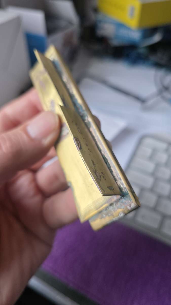

                                                  Before this however I could do a few more test joins. I achieved this brazed joint with some 1×1/4″ brass bar and 1mm brass sheet. Even if I just brazed four sections that would be sufficient. Better chance of keeping the risk of missalignment to a minimum as well.
                                                  20251002_134610
                                                  Any thoughts on that approach? It’s just that I’ve not done a piece this big before.
                                                  #818340
                                                  noel shelley
                                                    @noelshelley55608
                                                    Looks good enough to me – are you happy with it ? There is so much confusion about the term “brazing” ! To me there is soft solder, hard or silver solder and sifbronze , only the last one is brazing in my book. Good Luck. Noel.
