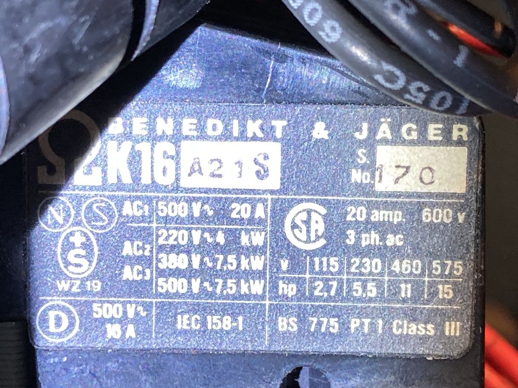

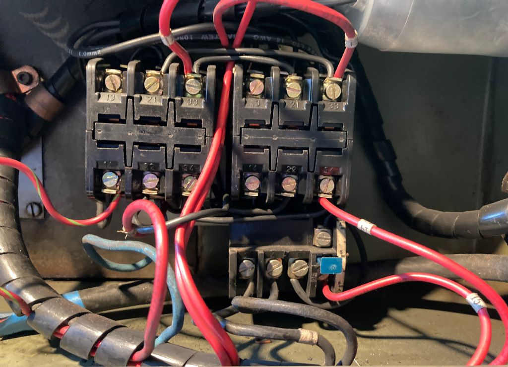

          Hi I need some advice ! Electricity apart from simple wiring etc is not my forte – I know my limits ! Had look at the switch gear on my Boxford grinder, its been playing up for a while, ran in reverse but not forwards and eventually reverse stopped working.
          I discovered there is a cut out on the reverse switch, presumably thermal? pressed it in and reverse works again. The forward unit will not "lock in" it runs if I push in the switch bar but doesn't hold. Now I need to know what to search for on the internet to find a replacement unit so please advise what these units are called, its the LHS one in the photo.  Thanks John

            The units in your picture are contactors It sounds as if the holding coil circuit is at fault. Is the machine 3 or single phase ? Without seeing the wiring or a circuit diagram it may be hard to sort out. If a thermal cutout has popped then may be there is a fault on the motor. Much more info needed. Noel.

                The thermal overload will be applicable to both running directions – it is usually mounted on the output side of the contactor pair.
                As the motor starts when the button is pressed but won't stay latched I suspect the "holding contact" on the contactor isn't making. This isn't unusual, as the contacts carry very little current & don't "self clean" as a result. Over time they can tarnish and, while closed, don't make electrical contact. Carefull dismantling of the contactor and contact block and cleaning the contact faces with a wipe of fine wet & dry paper often gets them working again.
                There may be a mechanical interlock module between the two contactors (photo unclear due to wires passing over the area) that prevents both being actuated at the same time. If this is the case, then an identical replacement contactor would be required. Benedikt & Jaeger still exist, but the holding company and internet presence is now called Benedict – catalogues can be found online & Farnell are the UK agents.
                Chances of a mechanically identical contactor still being in the range 20/30/40 years after the grinder was built are pretty slim, though, and lack of an identical replacement individual contactor would probably mean replacement of the entire 2x contactors + interlock module + overload arrangement, as all component parts are designed to work with each other for each manufacturer (no interchangeabilty between brands). Plenty of choice of manufactures in that case, but a quick look at RS suggests around £30 each for the contactors + £10 for an interlock & £30 for an overload + Vat for the lowest cost Lovato brand (which I usually choose for replacements at work & they work fine).

                    Edit P S The thermal overload reset is the small blue button bottom right in photo 1

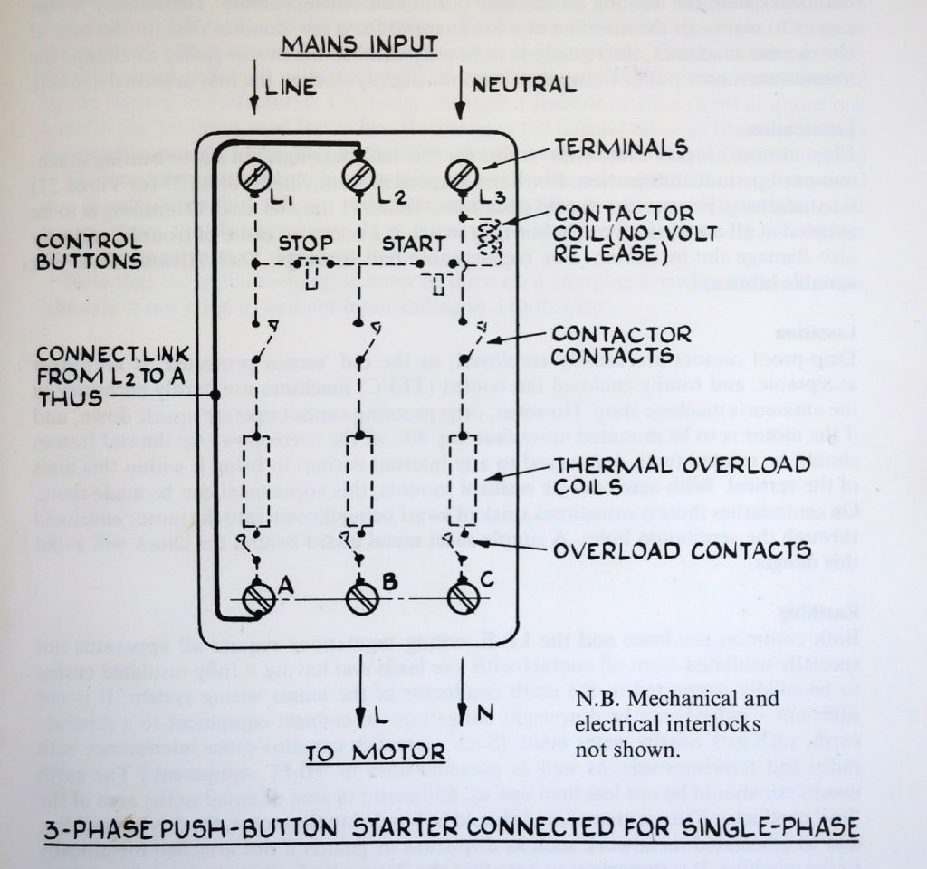

                      Someone else will hopefully chip in here, but on the MEM Memota-type DOL starters, you had to wire the thermal overload in a different manner depending on whether it was single or three phase.
