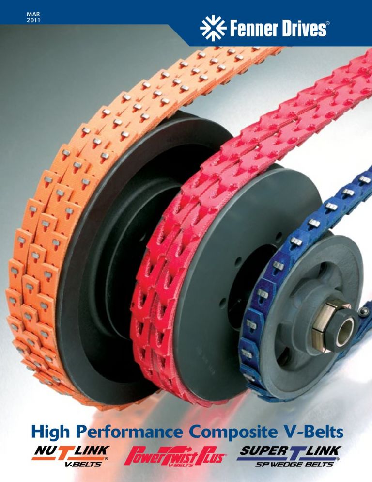

      Whilst in maintenance mode I took a link out of the headstock belt which begs the question, which direction should the segmented belt run in normal forward operation.
      Forgot to add – its a Nu-T-Link type belt
          BobH
          I have a segmented belt also. I would also like to know if there is a right and wrong way round.?

              The open end of the link on the inside of the belt trails so that in this photo
              the pulleys are rotating clockwise as we look at them. The powertwist belt which is what I have on my Boxford AUD has arrows printed on it.
              Andy
