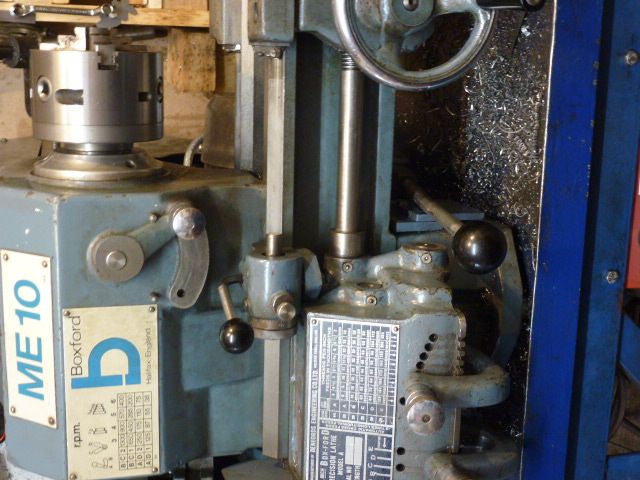

                                    Clive Brown 1
                                      @clivebrown1
                                      My version of a belt "clutch" operated by the black knob to RHS of the gearbox. (It's actually a gear-lever knob from a 2 1/2 litre Riley.)
                                      The lever pushes in to operate a spring loaded latch which holds the clutch in the stop position with the motor mounting plate in the up position.
                                      Guides inside the belt cover prevent the belt from snatching at the pulleys when in the stop position.
                                      #459534
                                      Sakura
                                        @sakura
                                        Posted by Clive Brown 1 on 25/03/2020 11:03:40:
                                        That's interesting. My belt lever is on the lhs. Have you modified the shaft to bring it out on the rhs? More pictures would be good.
