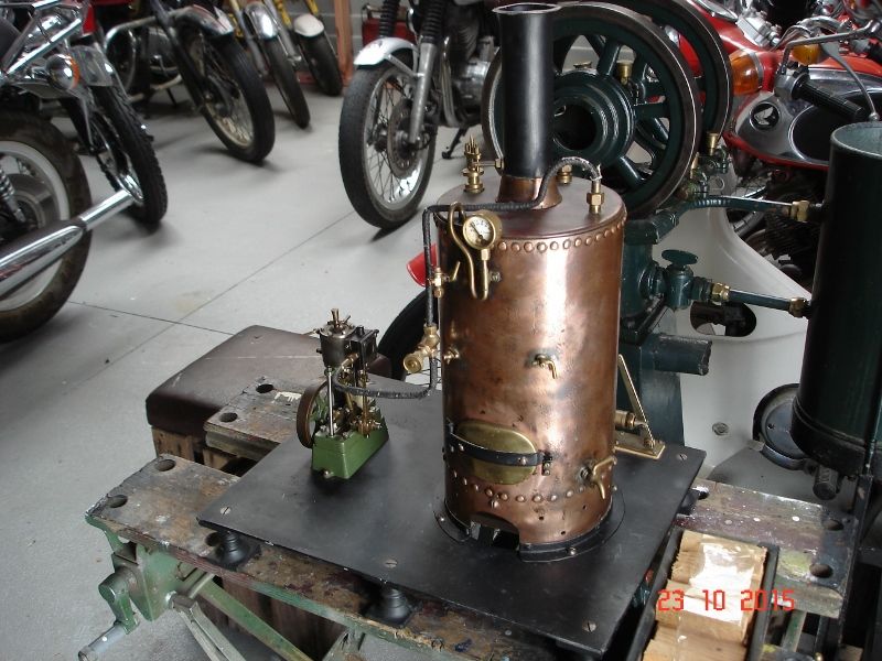

      Is there a problem in using brass for boiler fittings rather than phosphor bronze? I seem to have heard somewhere in the past that it’s OK for fittings that are above the waterline? eg The turret and its associated valves. I have a good stock of brass sections but virtually no PB.

          I’d have a word with whoever is going to do your boiler test when it is completed. I know the testers in the club I attend prefere bronze for fittings. In fact best advice is to talk to your potential testers anyway as many old drawings show parts which are now unacceptable. Also some parts cannot be seen once the boiler is completes so testers sometimes wish to see boilers at various stages of construction.

            My opinion is that if the part is in contact with the copper boiler/firebox then use Bronze.
            For example, the safety valve bush that is soldered into the boiler must be Bronze, but the safety valve itself that screws into the bush can be Brass.
            #71307
              I would say that if above waterline like the safety valve mentioned above then brass is OK but if its say a washout plug below water line then bronze. Both being fitted to bronze bushes.

                Don’t forget that the bronze must be a lead free grade.

                  Dennis,
                  In all honesty, you should never have even asked the question if you had any doubts at all.
                  I made copper boilers for many years, and not only for myself, and always used bronze for ALL boiler fittings.
                  What you have to bear in mind is that after you have fitted brass bushes, it will always be in the back of your mind if you did the right thing and if they will ever fail, whereas if you spend just a few squid on bronze, you can forget about them.
                  Doing it right first time, rather than compromising to save a few pennies, is always the right way to go.

                              It's all a matter of how much lead. Gunmetal and Colphos both contain lead, but a lot less than leaded bronze. The BS for leaded bronze states that it can only be silver soldered with special measures, so even tho' I've got away with it in the past I wouldn't use it for boiler bushes. Manufacturers data sheet for Colphos says it can be readily silver soldered, which bears out my experience.
                              Whether the screw in bits need to be bronze depends on your water quality. This has been covered in ME in the past. For the little extra expense I'd use Colphos, drilling holes in drawn PB1 is a complete pain in the whatsit

                                This question is of interest to me because I am nearing completion of a Trevithick Dredger engine to the design by Tubal Cain (see hpoto album). I hope to run the engine in steam, but not very frequently. The design has the entire end plate of the boiler in brass, and brass is also used for the cylinder, which is mounted submerged inside the boiler, and for parts of the flue tube. Tubal Cain (Tom Walshaw) did not mention dezincification in his articles in 1987 because I suppose,he considered it as a display model.
                                I was concerned about the problem, and managed to find a research paper in which measurements had been made of weight loss from brass samples of different compositions exposed to water under various conditions (heat, stirring and so forth). To summarise, there was a weight loss measured of 0.25%, increasing to 0.5% with galvanic contact with copper, in an exposure time of 2700 hours.
                                To me this is worth noting but does not prohibit running my boiler in steam, provided the duration is short and also that I drain it completely after each steam session. I doubt if I will ever approach as much as 20 hours exposure, never mind 2700 hours, for this small engine intended mainly for display with the occasional half-hour steam up. So, I think I will get away with it.. I have not yet pitched this argument to my club's boiler testers, though. I have used bronze for the bushes and fittings, Mainly for the better strength of the threads.
                                It would be quite different in an engine intended for regular longterm use, and I would not dispute that brass is best avoided in this kind of service.
