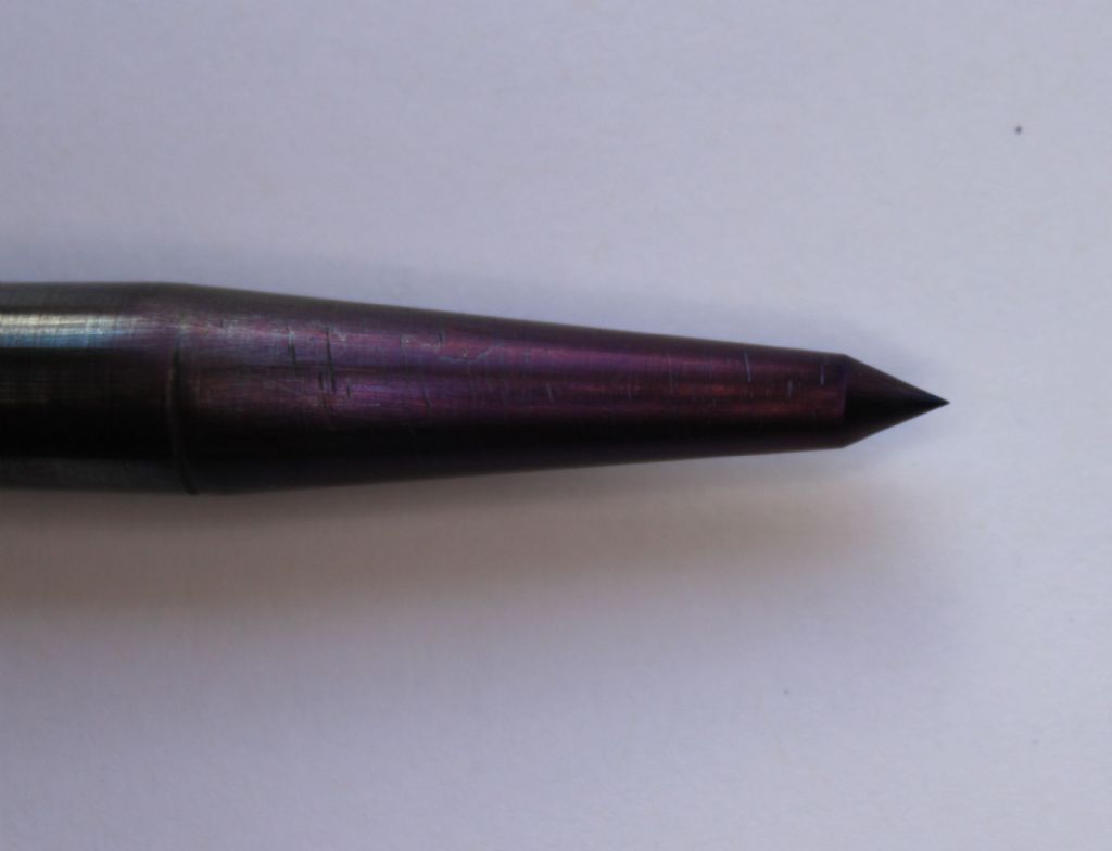

                  There’s no need to run your piece up to red heat at all – just heat it until it reaches the colour you want, then quench in oil. As others have said, the type of oil is not too critical, you can even set the colour in water and then oil it, but it won’t be as long lasting.
                  #81134
                  Terryd
                    @terryd72465
                    Hi Jon,
                    For smallish parts you can use a domestic oven for that. An electric one is best as the temperature is very constant. My own at home has a maximum temperature of just over 300º C. However teh temperature scale on the average control knob is not very accurate so some experimentation is necessary. if you have an oven thermometer that might help.
                    Using an oven in this way is much more controllable than using a flame it is also easy to observe colour changes – which are much slower than with a flame – if the oven has a glass door.
                    This tapered dot punch shows the consistency of the colour which is sometimes difficult to achieve on such a part with a torch
                    Best regards
                    Terry
                    Edited By Terryd on 03/01/2012 07:22:11

                        Yes Terry have tried it in a Bosch fan assisted oven and cant quite get there, translucent brown. This suggests around 230 degrees.
                        Darkist blue would be 275 degrees prior to that purple. 280 degrees it out.
                        The trick is to let the part heat up slowwwww often revolving, its a lot more contollable then.
                        Best i ever did and took 13 attempts i went through the colour spectrum brown to light blue like a rainbow down the length of 18″ tubing, took some doing but used the lathe to revolve.
                        Most of the time i use a propane blow lamp but a brick or any method to induce heat will do the trick including friction.
                        Screws dead easy to do and add that hand made sort of look with pure quality.
                        Terrys above not quite for a beginner, try something smaller to get the hang of it. Decent job by the way – blow lamp held vertical and part upright can tell where it tapers = less heat?

                          I find that the heat colours usually darken with age – a ‘dark straw’ becomes a real rich bronzy brown in time. If you get it right (and it can be done) you can get the lovely ‘blue steel’ colour.
                          Hi Neil,
                          I quite agree with you, some lovely colours are possible. The real trick is getting the temperature right and letting the work soak for a considerable while which is why I suggest using a proper temperature controlled furnace, or failing that the domestic oven!! By doing it properly the rush to quench at the right time and the fluster etc involved with a torch is eliminated.
                          Best regards
                          Terry

                            Hi Jon,
                            I wouldn’t achieve that easily with a blow torch, except by indirect heating on a plate, in sand bed or salt bath, but it was done easily in my domestic oven set at about 290º C
                            You are right though about using heat properly, it is a skill same as any other, and is also one of the secrets of successful silver soldering (and welding), it’s not just a case of simply using a great big heat supply , but more importantly knowing how to focus it correctly. It’s the mistake most folks make in the beginning.
                            Best regards
                            Terry

                              I love doing that sort of colouring, i’ll be doin a couple of screws tomorrow. Me and my photography wont show it though.
                              An even colour that length would be very very hard to do, might take me two attempts with a lamp. Steady hand and watching the colour either side of the flame expecting it to rise.
                              Stainless is weird you have to get it bordering red then it cools off to show purple to blue.
                              Done some of the fittings on me M300 last year, the quill lock is done thats about 2 1/2″ up to the aluminium.
                              No other piccies sorry.
                              Whilst on this heat colouring i would say its the preparation that counts, polish like chrome and it will have the depth just like a dark blue mirror. Might try bead blast and colour next time, see what that does.
