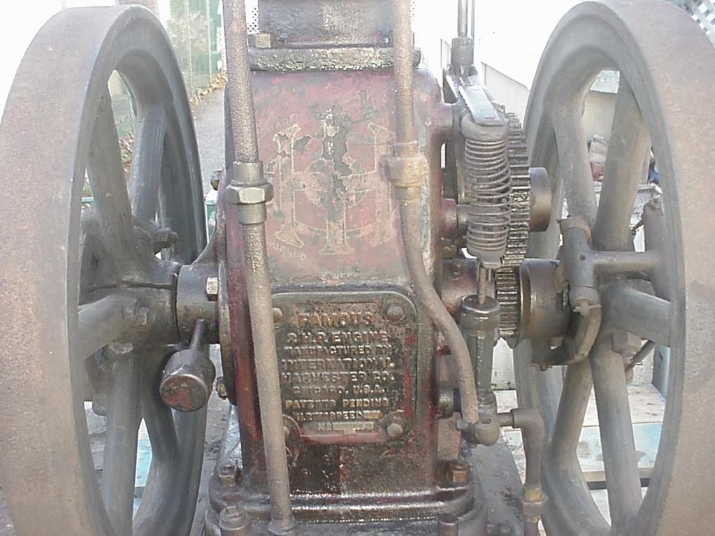

                    I've made miniature greasers for my model IHC screen cooled to lub the crank bearings, The big end is enclosed in an oil bath with a slinger. This shows one on a the full size version
                    For a steam engine I'd be more inclined to use an oil cup with a lid and fit a wick if needed, something like this

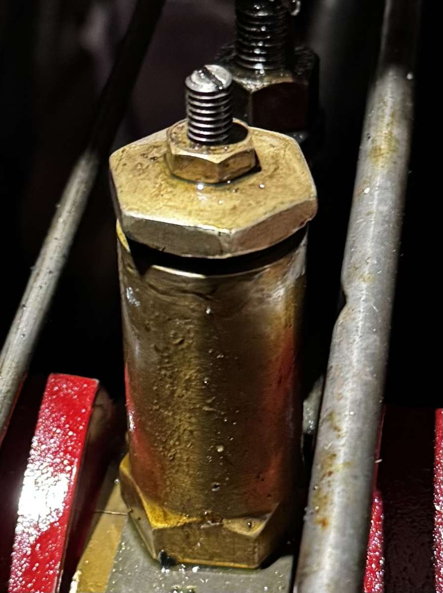

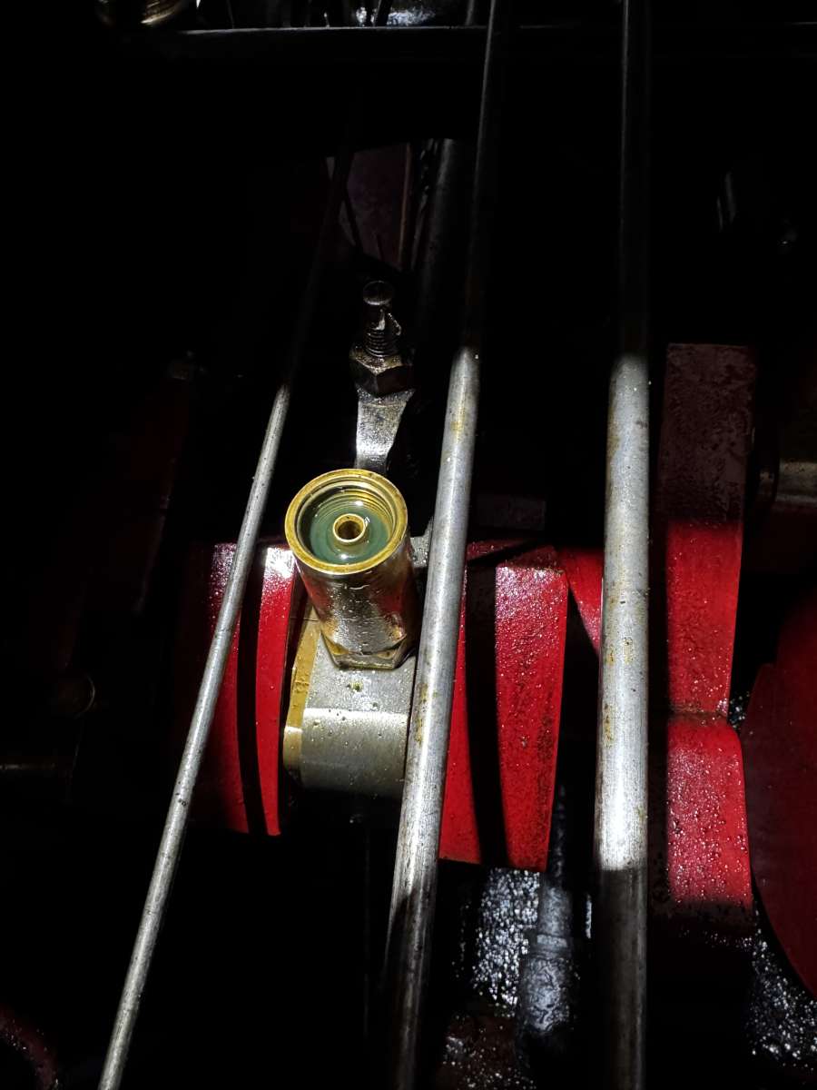

                      Hi. I have joined this forum. My brother just got a 6” Burrell traction engine and I want to check on the big end bearing lubrication. I suspect these are Syphon Wick Lubricators – is this correct?  If so I reckon I need wicks for these. Any idea where I might get these in the Uk?  I am new to steam engines so sorry if I am asking a stupid question or am getting this wrong. IMG_6534IMG_6535

                                I think the type of set up shown in Terryfitz’s photos would have a pin similar to a  round wire nail down the central oil hole cut short so as not to touch the journal and with a head size that rests on the inner tube.  As the crank comes over the top it lifts off the seat letting a little oil flow.  The grubscrew in the filler cap is to limit the lift and hence regulate oil flow.
                                Worsted wicks are a red herring for this application in my opinion.
                                Martin
                                #850406
                                Paul Kemp
                                  @paulkemp46892
                                  +1 for Martin’s comment above.  If you must fit a trimming then it should be a plug trimming for this application.  You want a small constant flow of oil, the rotary motion will empty the reservoir in short order with an ordinary trimming, there needs to be a small breather hole somewhere in the set up too.  Typically full size use corks with a cane through the centre, the cane is porous and allows he reservoir to vent without chucking the oil out!  For my eccentric oilers I cut out a felt disc with a wad punch and placed in the bottom of the reservoir, big end is fitted with a worsted plug trimming.  I had an occurrence last weekend where on the Sunday night it was so hot the oil became really thin (460 bearing oil) that when I steamed up Monday morning all the oil had run out of the big end bearing!  I turned the engine over slow to clear the condensate before I had oiled up and there was a nasty knock!  Refilled the oiler and waited a minute or two for the oil to get into the bearing and it went away.  Clearance on the bearing was a bit big, stripped it down this weekend, no damage thankfully, readjusted with the cotter.  Moral, make sure your bearing clearance is not too large or you will use a lot of oil in hot weather, or consider if it’s hot switching to a heavier grade.
