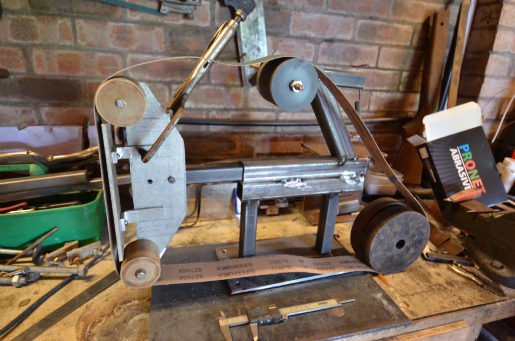

      I have made a knife making grinder, that includes making my own wheels two 3" and one 4" my problem is finding bearings to insert into them, read somewhere that sliding door wheels are good but cant seem to find any that fit at a fair price about 1" with bore about 3/8 and I dont want to pay for the very expensive ones Any help in the right direction Thank you

              Arceurotrade have 3/8 x 7/8 bearings for about £1.50 each, skate bearings are 8x22mm and they are dirt cheap if you choose the cheapest. Wondering what was the price point you have in mind?

                YOu might find metric sized bearings easier to find and cheaper eg, 10mm x 26mm.
                Grinders, counter-intuitively, usually use the steel-shielded bearings and not the rubber sealed ones because grinder motors often don't have enough torque on start up to overcome the friction of the rubber seals. Depends on what kind of motor on your shopmade grinder though.

                        Firstly, you would be better off getting metric bearings as they tend to be cheaper than imperial sizes. You should choose sealed bearings considering the abrasive nature of the grinder, 2RS is a common designation in the bearing part number.

                            These are the wheels I need to bore out the centre them epoxy the bearing in flush with the side Thank you for your kind replysknife grinder

                              Thanks Mike, arcevrotrade is perfect

                                To me that does look very like a belt linisher.
                                For that application, commercial grade bearings should suffice.
