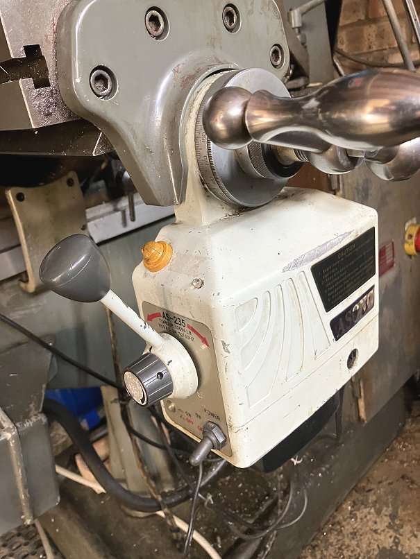

      Peter Neill 1
        @peterneill1
        Had this one on my Bridgeport for 20 years, got it from Warco way back then.
        Look the worse for wear but works just fine, haven’t even needed to use the spare gear it came with.
        Asong
