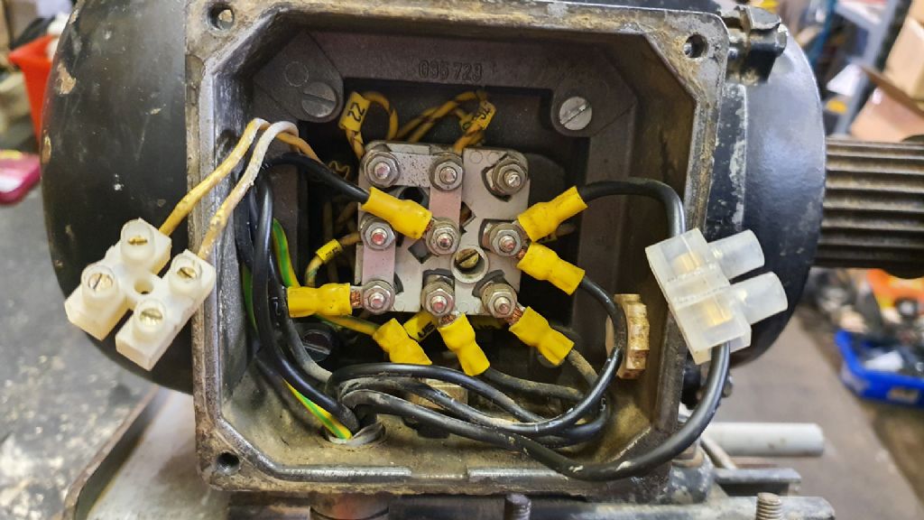

      At work I am trying to restore a Scabbler (concrete de-chipper) machine. Problem is, the motor makes a weird noise when running.
      The motor is an induction type with permanent magnet rotor and a wound field-coil. There is no centrifugal switch and starting is handled by two 80uf capacitors wired in parallel.
      It's switched on via a cylinder type, multi-pole switch which energises a contactor coil in a start position then springs back to a run position.
      In the start position the motor sounds very smooth but when in the run position it sounds rough and the motor speed drops somewhat. It's like there's a choking effect or field being introduced.

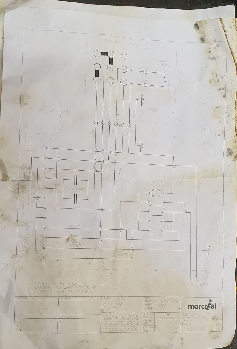

      I'm pretty sure I have wired the motor and controls according to the circuit diagram. Please excuse the use of an earth wire in one of the below photos, it's just a link, not an earth connection.
      In the video I start the motor and release it twice so I can let you hear the 'choking' sound. It doesn't quite work on the first start.
      I'd appreciate any ideas and your input as always.

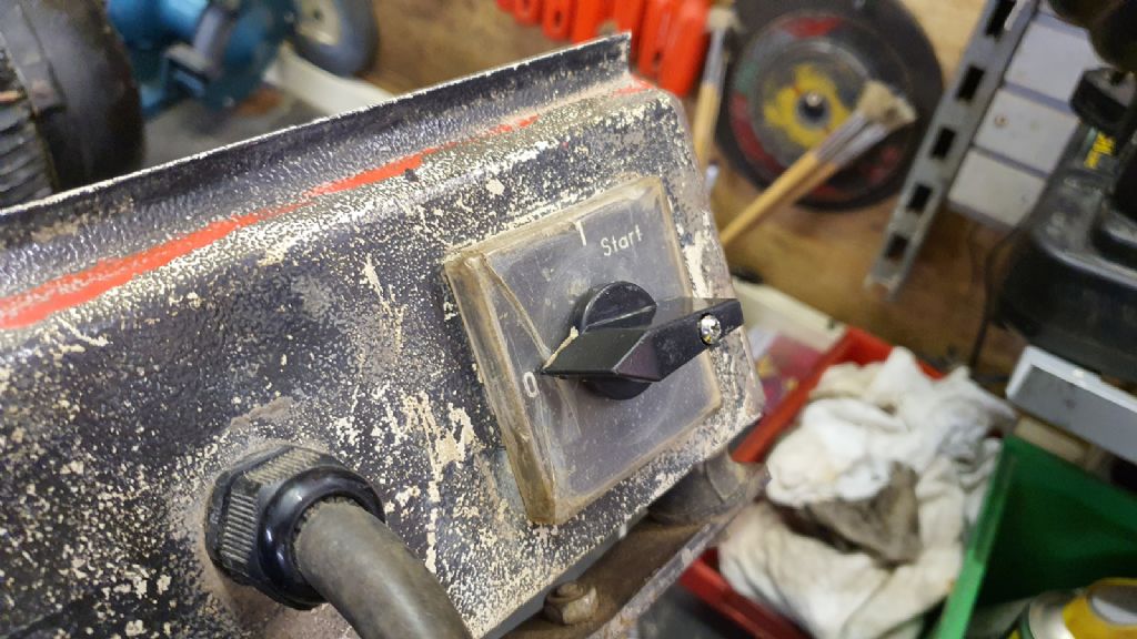

          I think the clue is in the fact that it started OK the first time, and only made the straining noise when you moved the switch. That's a faulty switch. No I would definitely not be happy to let that go out of my shop behaving like that, but I think the fault is in the rotary switch.
          Looks like it's a pretty standard sort of switch – the internals and the spring return will be specially designed for this application but you should be able to obtain a direct replacement.
          If you would like to put up a photo of the labels on the switch which hopefully will show a manufacturer (Kraus and Naimer?) and a type number we can probably locate a supplier.
          You may even be able to get a replacement from Marcrist as it seems to be their name on the drawing.

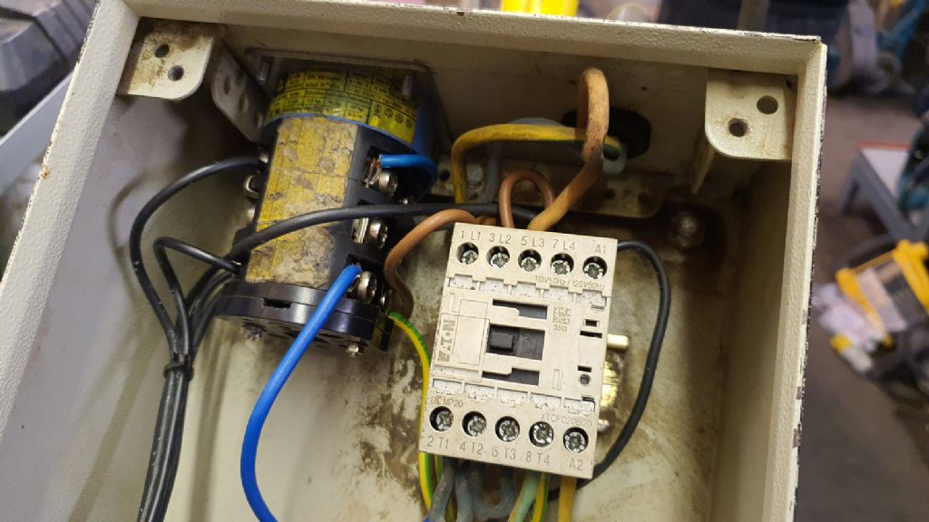

          Worth spending the money for the right thing – should be £20 – 30 or thereabouts. While you're at it replace the contactor as well at the same time and have done with it. That looks to me like a Siemens contactor (edit – sorry the clue's on the picture it's Eaton if you blow it up big enough – but any similar contactor will do) – should be possible again to buy a direct replacement for about the same again. If you can get a picture of the label on the side of the contactor it will show manufacturer and part number.

            I can contact Marcrist to see about a replacement switch. The contactor was actually a replacement itself, some years ago but the machine was left in disrepair because it would not start at all. I traced that problem to an open-circuit thermal overload in the motor. I've bypassed that for now just to get the motor running. It'll be another required part, if its available.

              Is this a single phase motor or a 3 Phase one that has been altered..
              Brian

                        Look at the wiring diagram, lower right portion. It shows a single phase supply.
                        Steve.

                          Sounds like a dud bearing, damaged ball or balls skidding rather than rotating.This may only be happening when the motor has run at full speed for a few seconds and a lack of lubrication and or roundness starts the music.

                            It is a single phase 110v machine, looks to be identical to a Von Arx machine.
