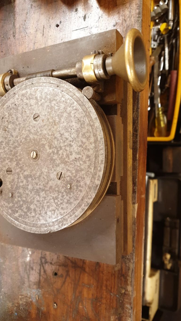

      Any ideas on what this is?
      Many thanks

          Just looks like an old rotary table to me.
          Steve.

            Same again ! an interesting rotary table. Noel.

                There's no way of holding work to it, and it has a screw and a couple of pins sticking proud of the surface, so you couldn't lay anything on there flat, hopefully someone knows what it is.

                  Rotary table. Home made with graduations around the edge but I don't think it was used for machining. Light duty worm drive and no hold down slots or holes except for the one long slot and small location dowels. Possibly for mounting a telescope or some other type of instrument ???
                  Paul

                    Maybe it was made as a factory fixture to hold a part or a sub-fixture with a part in it for drilling reaming or tapping a series of holes along an arc. Looks like there is an index mark on the left side bearing, so the no of turns could be counted, this would explain my guess about it being for a no. of holes on an arc. The pins and slot on the table might have located the part or fixture, and cutting pressure / operator hand pressure may have been enough to hold things down to the table. As there are no hold down tapped holes or clamping provisions I'd say it was probably not used for any heavy slot milling or radiusing the ends of rods or plates. Just my thoughts on it.

                      I'd say it is a rotary positioning table but not intended as a manufacturing fixture, more likely a base for a scientific instrument like a theodolite. Could be put to use as a manufacturing fixture though!

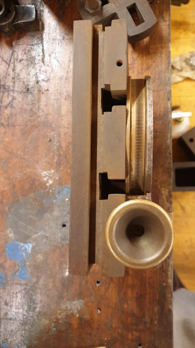

                                          My feeling is that the Tee slotted table is a red herring, it looks a bit home made especially the Tee slots which are a bit mis-shapen.
                                          I reckon the brass parts have been robbed of another higher quality possibly optical instrument by a budding model engineer many years ago, and grafted onto the the cast iron base in the hope they will end up with a rotary table.

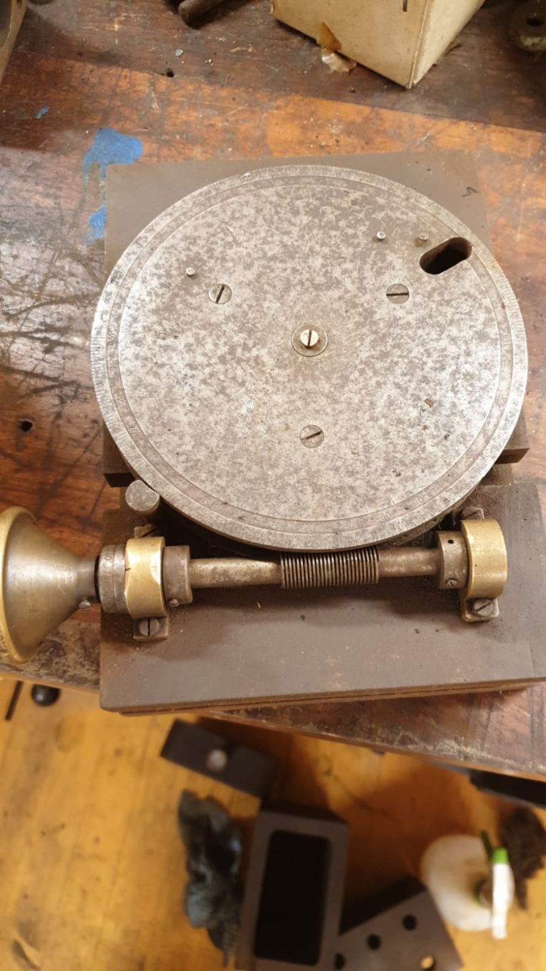

                                              I'd 'go with the scientific uses – part of an instrument for regular use or in teaching; but subsequently adopted for some other use; perhaps in a workshop by fitting to a cross-slide. It looks too small and finely made for heavy use but if it was originally intended as a machine-tool accessory, it was in horological or scientific-instrument work
                                              The lack of graduations is only due to the scale, perhaps on a shroud over the worm, having been removed or lost. Note that the worm-shaft still has its minutes scale.
                                              The small pins probably did locate some particular article, as Jeff suggests, but not as original.
                                              I would conclude someone adapted this rotary-table for a very different purpose from original, and I don't think "original" was on even a small jig-borer or engraving machine by any commercial manufacture. I doubt the adapting was by a manufacturing concern either. Unless perhaps under the exigencies of either World War, it would have been more much efficient, reliable and economical to purchase a machine-shop class rotary-table and add the locally-made jigs and fixtures.
                                              Its being mated with a T-slotted slide, suggests to me that Lindsay has acquired the mortal remains of a home-made jig-borer or compound-table for a bench-drill. Or possibly something assembled from bits in a university workshop for use in the Physics Department?

                                                      It looks as though there is a fiducial mark on the peg to the left of the worm bearing nearest the hand-wheel as well as the minutes markings on the worm shaft.
                                                      Having worked in an industrial R&D environment for 31 years I got quite used to seeing odd bits of equipment like this that were made up for special purposes where one or a few off measurements were needed and/or suitable ready built kit wasn't readily available. The mounting plate has again probably been re-purposed from some scrapped machine and just happened to be suitable for the job – pretty heavy and solid.
                                                      R&D scientists/engineers tend to be pretty resourceful when they need to be and re-purposing odd bits of kit was part of the fun.
